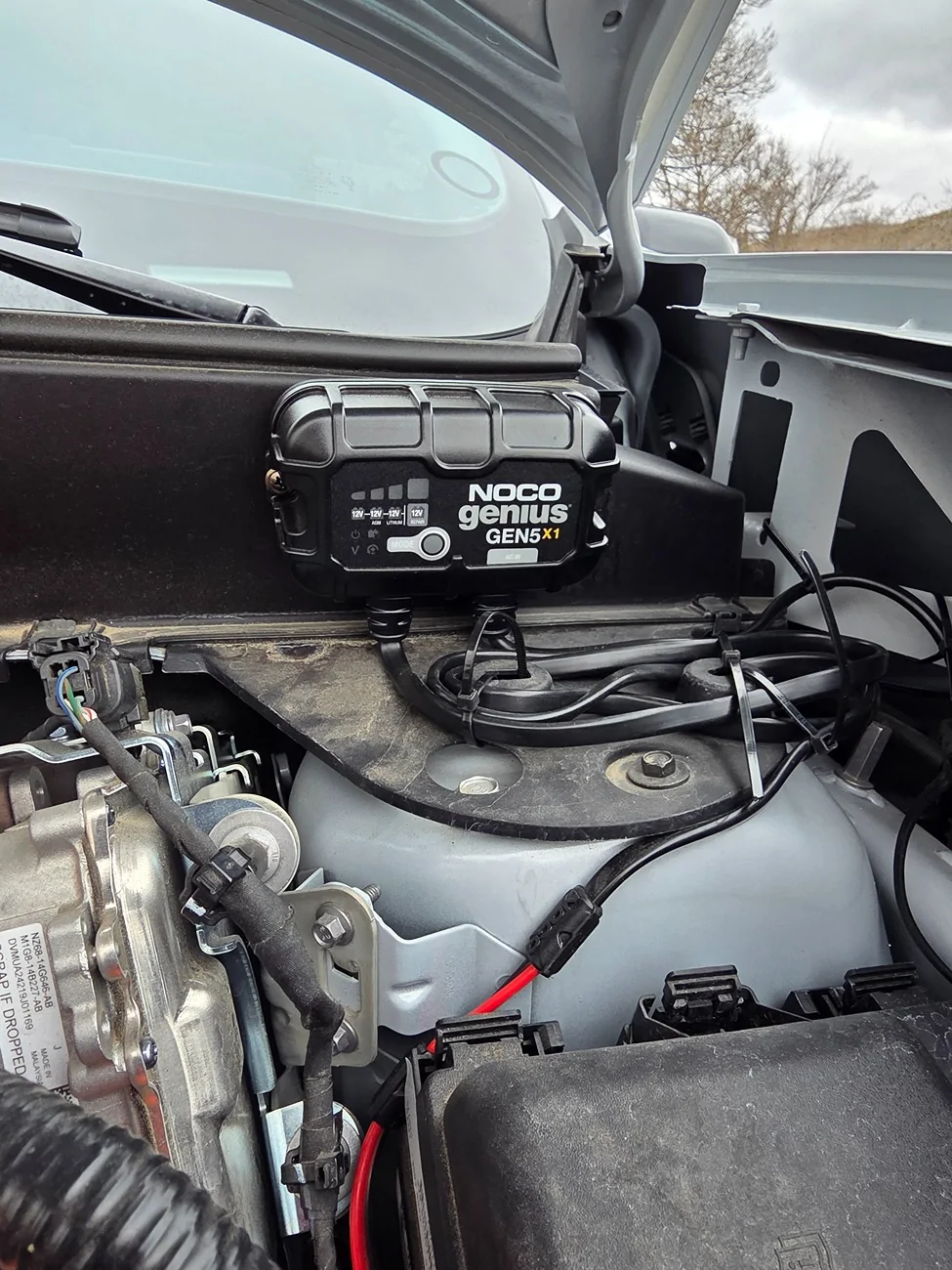

That's what I use. I mounted it under the hood. I plug it in about once a week, overnight. The charging system in these Mavericks just doesn't seem to give a proper charge... '25 AWD hybrid
