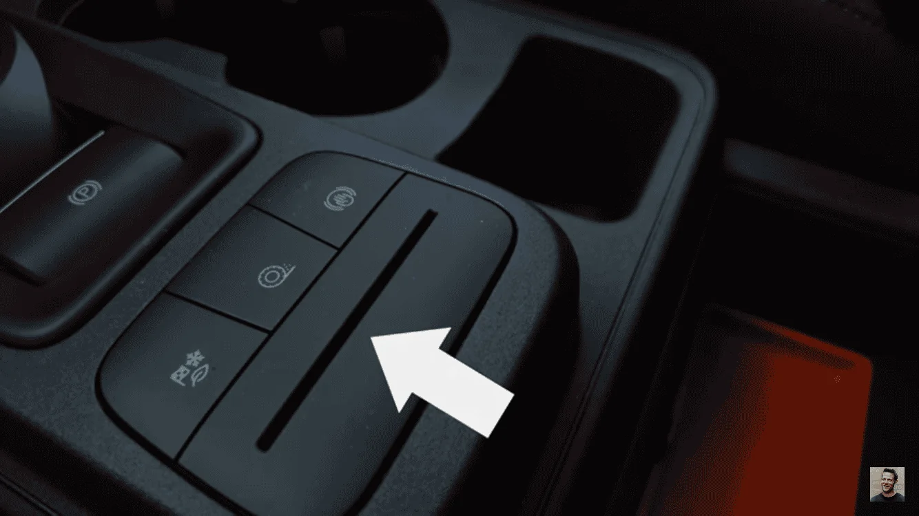

Is there even a start/stop button hybrid?? If so I would bet it is safe to push as computer properly programmed would ignore it as necessary.🤔
Negative, no button, and you cannot control ICE start stop on a hybrid, it’s all computer controlled and almost all the reviews note that it is essentially seamless. It is cranked by a very powerful electric motor, virtually instantly.
Hybrid buttons: drive mode, traction, auto hold on brake.

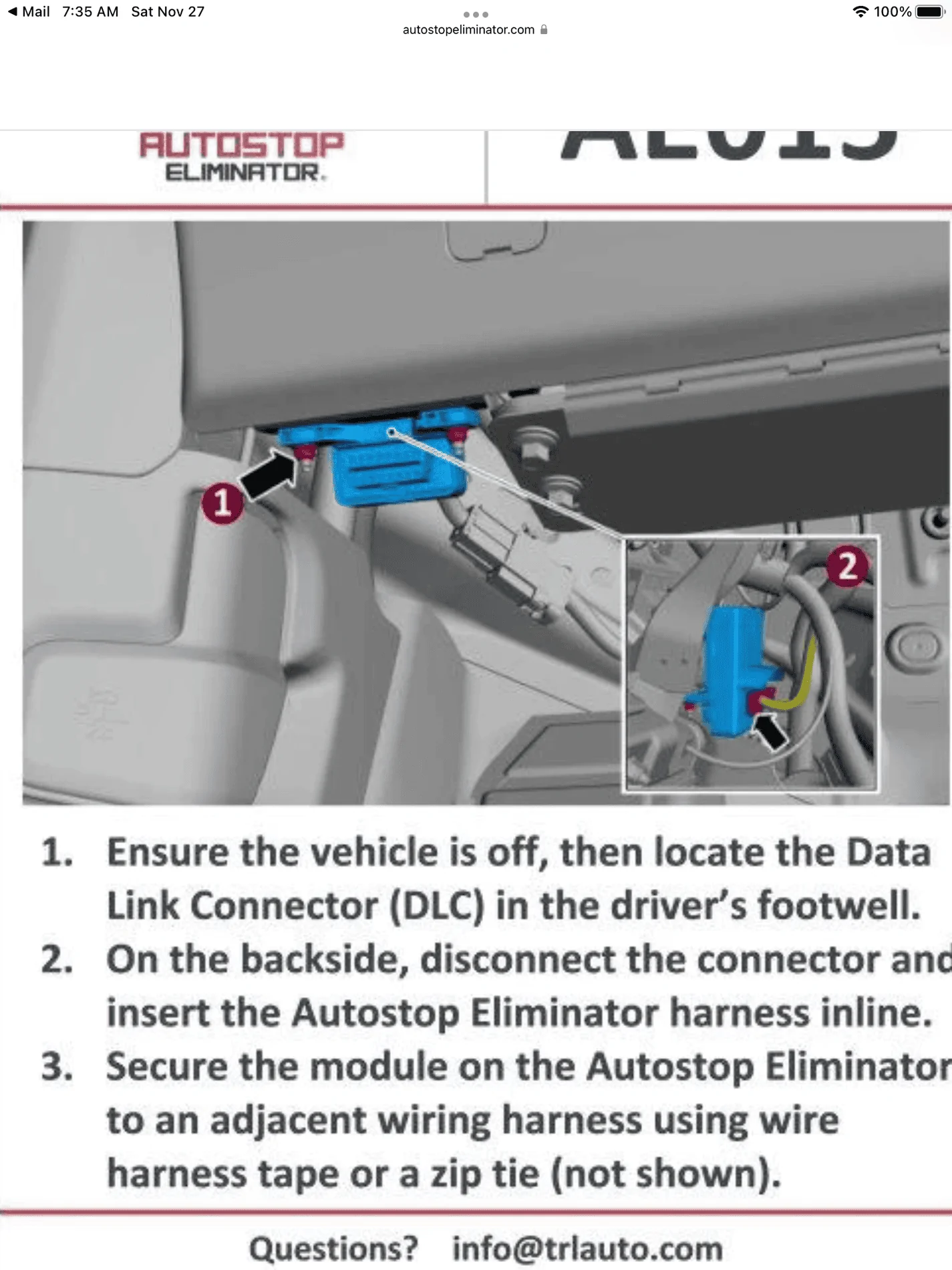

Just to clarify, you're saying that you cannot disable auto start/stop on the hybrid? What about if you always have a 4 way tester in your back to fool the pickup into thinking that you are hauling something? suah as this one?

Why would you want to try to force the ICE to run at all times in the hybrid, exactly?

What does hauling have to do with ICE start/stop? It’s still going to run its eCVT routines no matter how much you try to haul, eh?

My understanding was that the auto start stop would not stop if the pickup was hauling anything.

Why would you want to do that though? I'm sure shutting off the ICE when it's not needed contributes quite a bit to the hybrids great city mpg, and by all accounts it's a seamless transition

I don't think that would get past the young whippersnapper two thumb gamer trained programmer who most likely can furnish you the serial number of your 2.2oz tester's chip as the computer notices that the current being sent to your drive motor is the same as normal except when sometimes you have a 142lb passenger.🤔

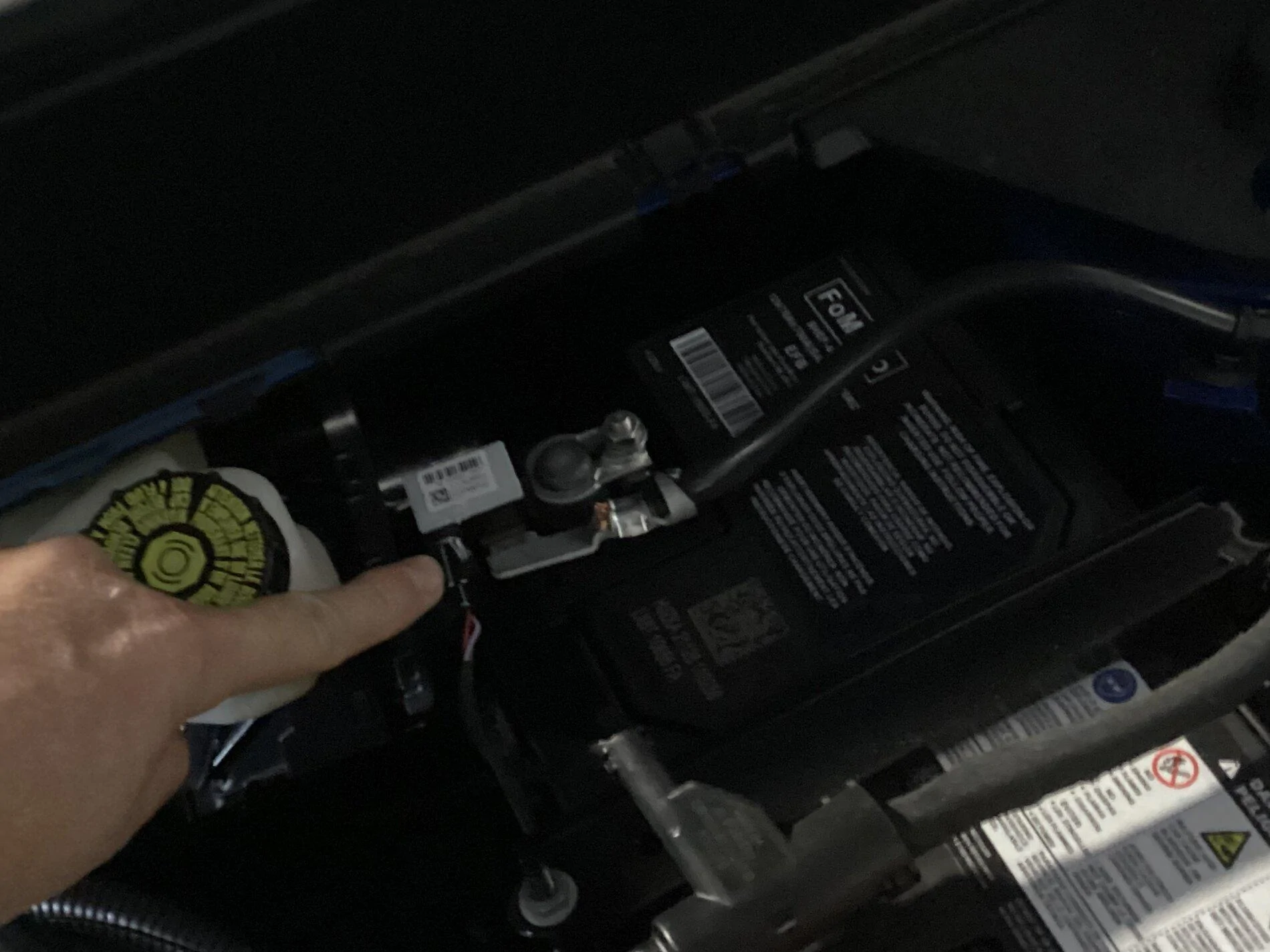

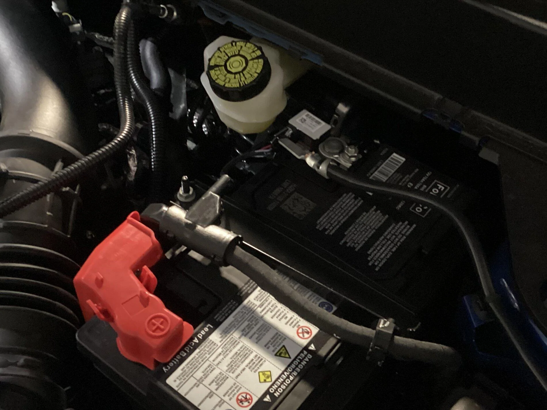

My brothers Chevy Malibu also had a small motorcycle sized battery in the trunk area just for the stop start feature.

Pretty much nobody has one yet to do any testing on this, but the manual lists "Towing a trailer" as one of the things that "may cause the gasoline engine to start or remain running."
I don't know if "Towing a trailer" means being in the "Tow/Haul" drive mode, or having some trailer lights plugged in, or tripping some kind of sensor that detects the additional load.
If your trick works, I suppose you could call it "disabling the auto start/stop," but it's not like actually switching it off. Tricking the computer into thinking you are towing a trailer could have other effects (gearing? braking?) that you might not want.

The reason for two batteries is to prevent “voltage dip” type issues during restart. The smaller battery is disconnected from the main battery during a stop/start event (Grand Cherokee) via a large relay. The single battery variants have a boost dc/dc converter to raise the voltage on sensitive components during restart (Cherokee). This module will contain some largish capacitors. It only needs to boost for a few milliseconds. Newer stop/start have dual solenoids on the starter motors to reduce restart time and decrease the size of the boost dc/dc converter. Hybrids by design are always turning the ICE on and off. Disabling that function would effect driveability.
