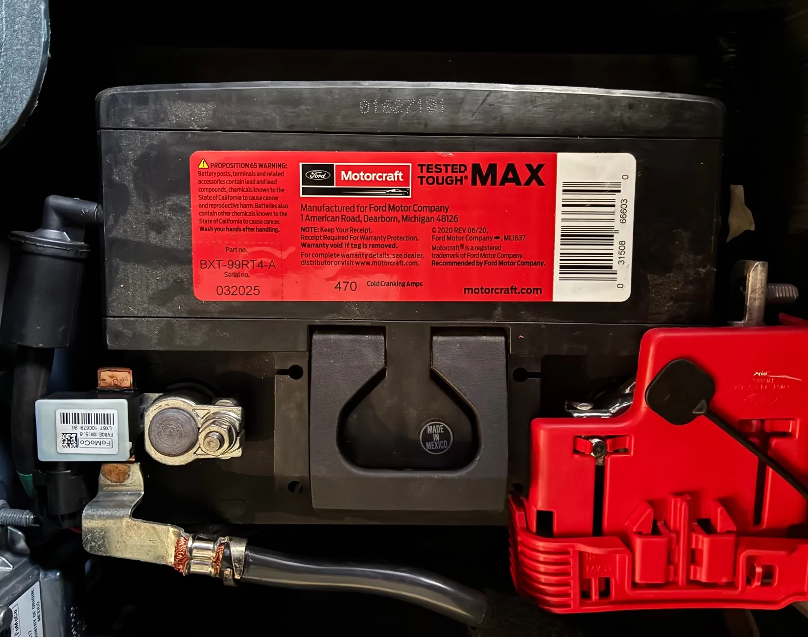

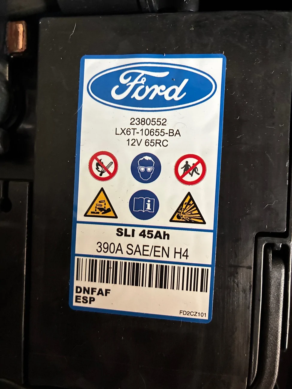

Local dealer just replaced the battery that came with my 2024 Hybrid with the battery that my owners manual says is the correct battery. I told them I was annoyed by the constant Deep Sleep notifications, and that I was worried about my upcoming 3200+ mile road trip. Also told them that the battery in the car did not match what my owner's manual said should be in it. Car has under 10K miles on it now. I have never had any real issues other than deep sleep. Always starts just fine.
They measured 43 SOC, even after the half hour drive there, failed the battery and replaced under warranty.
This is what the truck came with when new:
This is new battery:
I don't believe Motorcraft sells this anymore - Ford Parts website says it has been replaced by BAGM-H4. So I did not get an AGM replacement, but at least I now have a new battery that should have been in there from the beginning, and it should get me through my trip fine. I will get a NOCO G5 to help keep it charged, since I obviously don't drive it daily.
And if they ever get the issue figured out for good...
