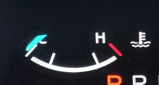

If the coolant temp is below 120 F, ICE will be kept running until it is. That's the outside edge of the 1st tick mark on the coolant temp gauge, when the outside edge of the arm matches it.
Here's the wrong side of that 1st tick.

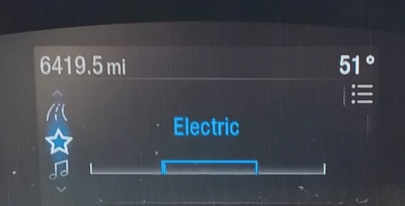

I can't say how much percent HVB I have, but I've seen it go down WAY lower and still be in electric mode. To me, it very close to full.

So this is overfull you might say. Way beyond the word Electric, where 70% normally lands.
So not this long, normal back at the tri?
Actually - it'll display this big sometimes (not sure how to make it do that, but always after initial start), and the SOC will still be the max 70%, actually a little over usually.
At this point it'll allow up to 15% abouts (what the MY25 has as a max) power, almost to 123 Amps.
And you are sure not going over the 10% power request?
How full is the box with solid blue when you have the ICE turn on?

I'm going to say it's near the "I" or the "r".
I am absolutely positive I am not at 10.
I'm thinking I'm very close to charge.

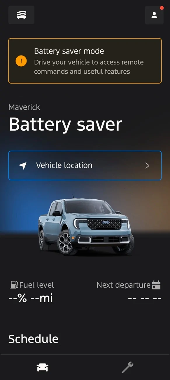

As soon as the temperature dropped below freezing - kaput! I can't start the truck remotely to warm it up. I drove it plenty of miles each day this week, as I always do, 100+ per day.

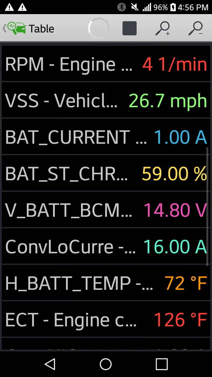

I have my code reader plugged in and the hybrid system battery had a 59% charge when I parked it last night. I'm going out for breakfast after chores and I hate the idea of paying for features that are disabled when I want to use them. I'll check the state of charge and voltages before I start.

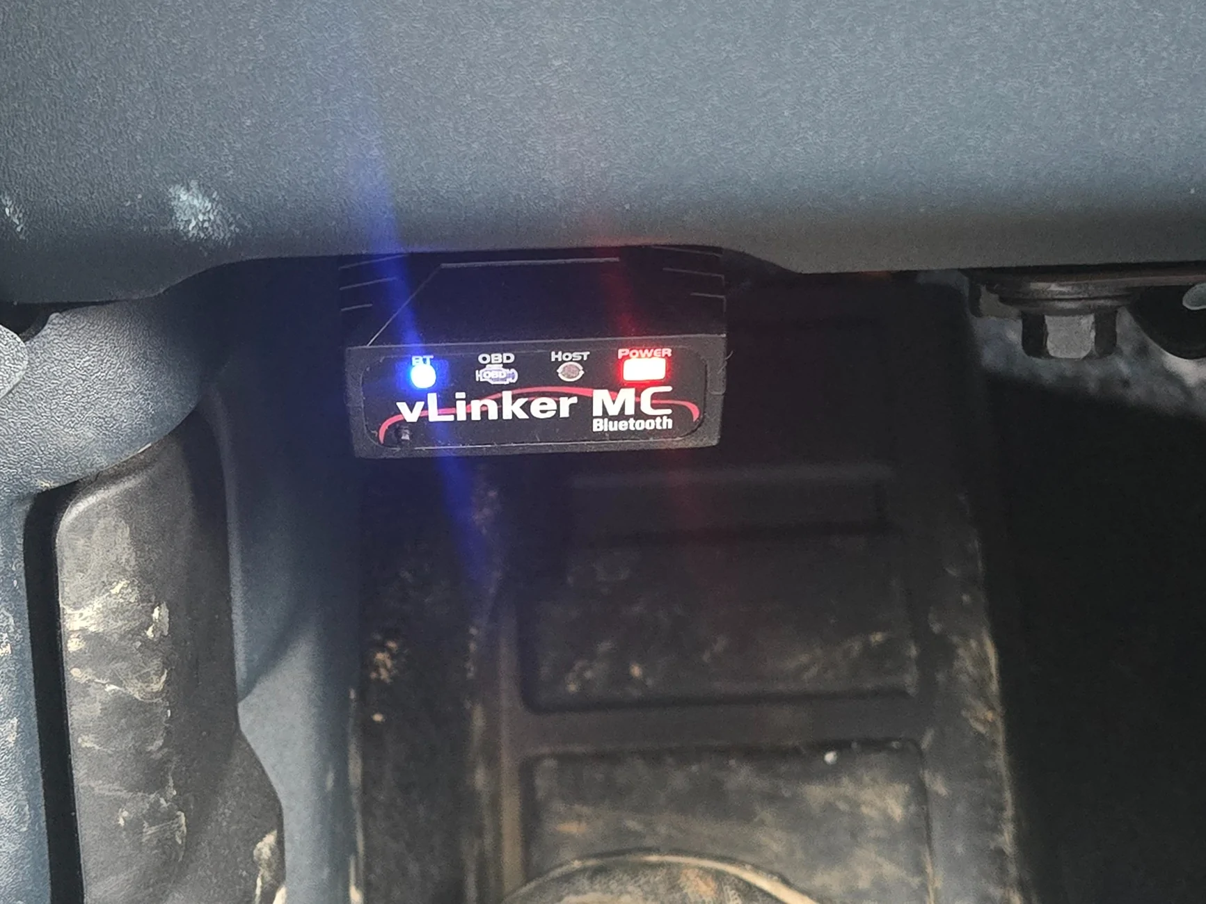

Well, well, the OBDII port is not operating. No data. Probably another weird electical fault. My FORDs seem to have plenty.
HeyBales
May 3, 2024
5,202
4,916
KC Metro area
It can get into that state, even with full 12VB, where the reader doesn't get anything from the truck in Accessory mode.
I have to click it to On, get the Green icon in Forscan Lite, and back to ACC mode. (24XLT, so keyed).
So while there is maybe 2 seconds of charge being thrown at the 12VB during the On time, if I quickly hit the Play button in the app to see the data - you see it drop right back to where it was. Hit the brakes to drop the surface charge.
Then you can see it again.
