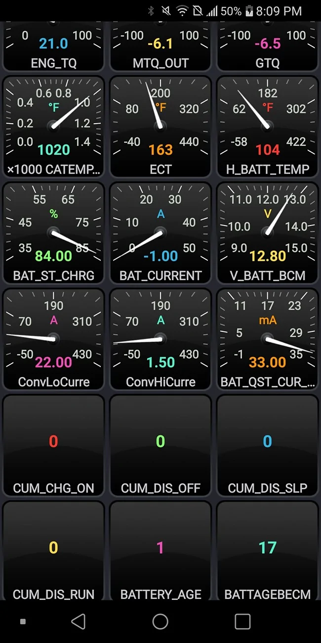

Well - was trying to find a decent hybrid 12V battery thread to put an update in.
Not a case of search NOT finding anything!
Way too many to select from.
Maybe I'll update others.
Another thought on what's going wrong.

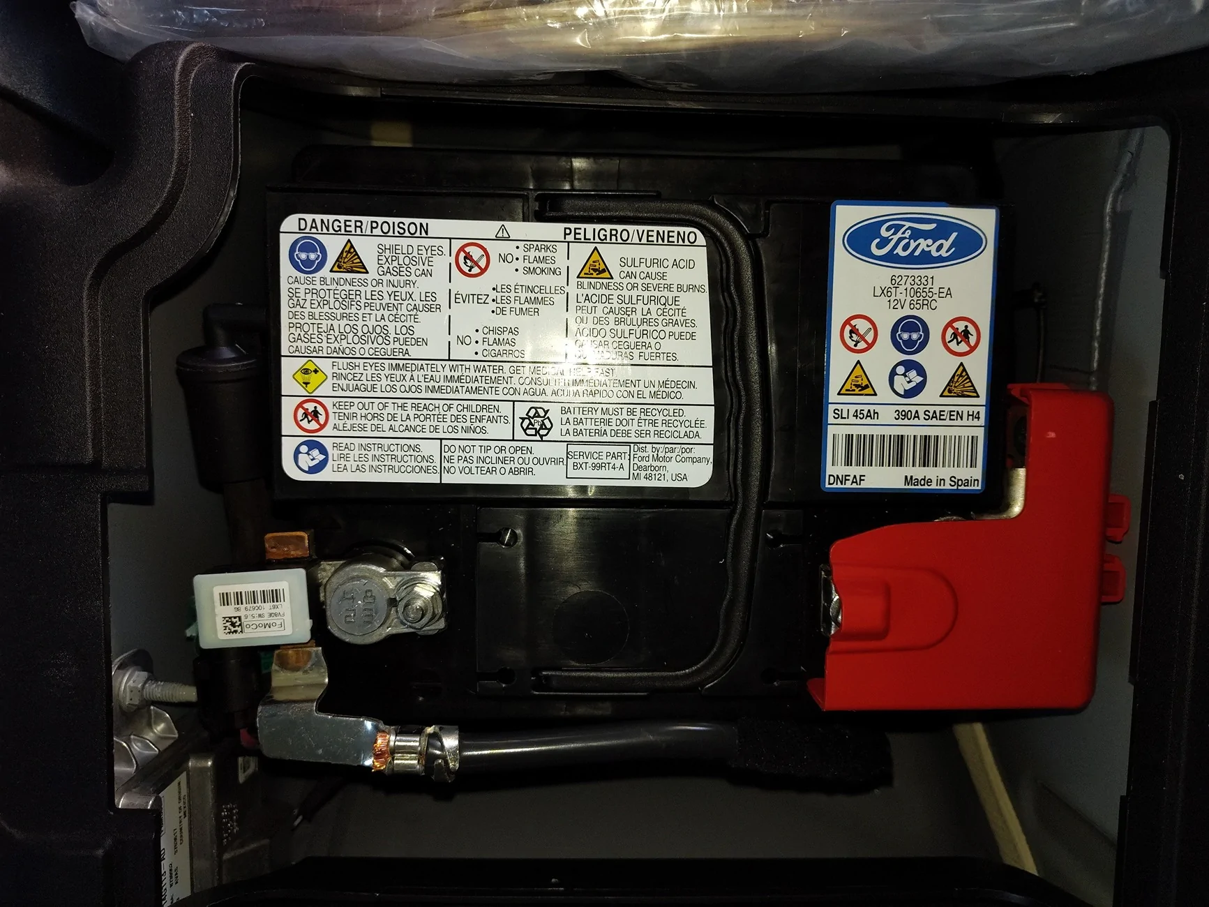

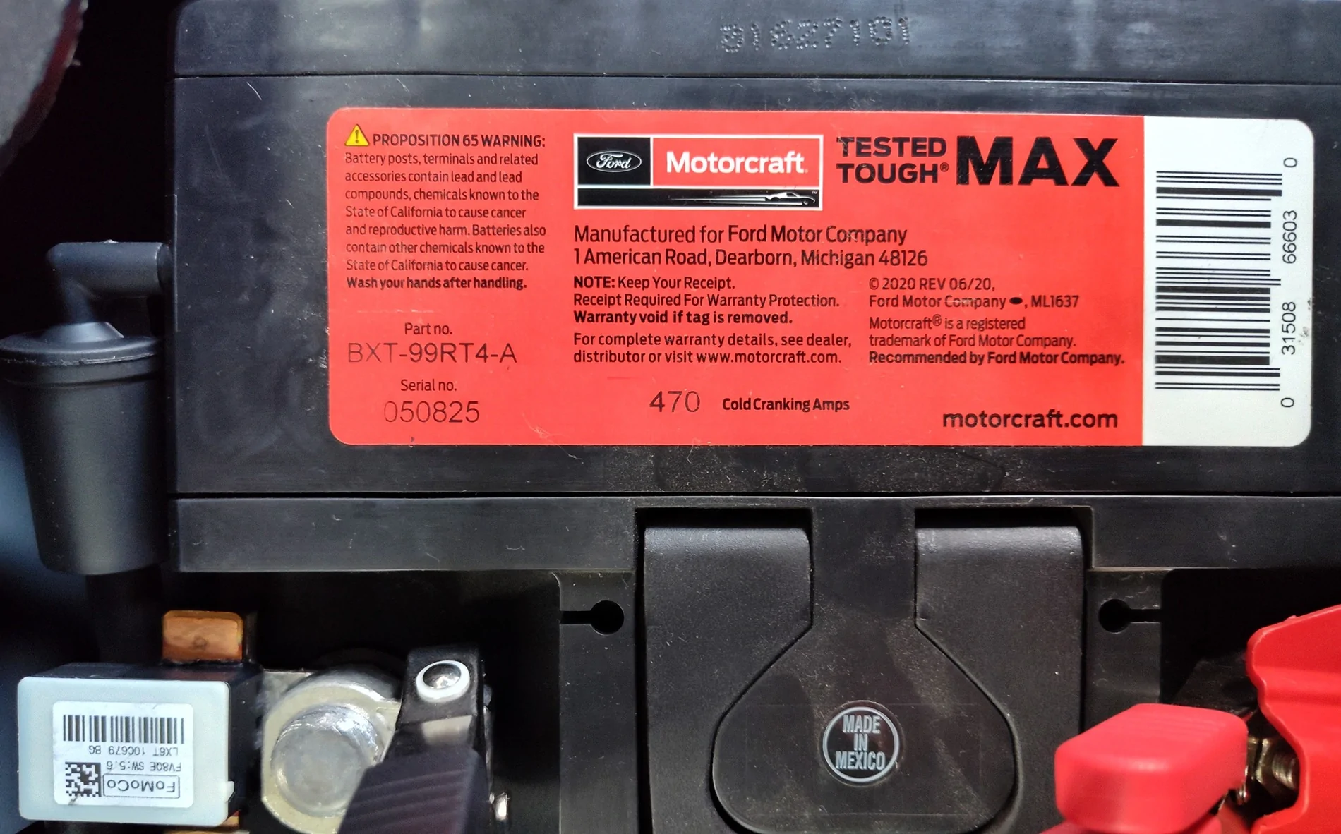

Warranty replacement battery after my use 4/23/24 to 7/25/25 - 15 months usage.
Though Activated 4/8/24 and mfg 48 wk/23.
390 CA or CCA? / 65 RC (really!) / 45 Ah (always tested 100% SOH to that till end, bad tester)
New battery mfg 5/8/25 - newer 585 CA / 470 CCA / 65 RC / ? Ah
Recharged to full 7/26/25.
IIRC key-Acc to Ford's special SOC 83% 12.6V, and with a short drive got up to 85%.
Which is a full battery charge. 85% SOC. So stupid.
Interesting that while driving and engine running - the 12VB is having a 1 Amp discharge, for just some seconds that I caught it for screenshot.
I guess that's why there is a PID for battery cumulative discharge running - prior battery was at 0 for that still.
I guess the age of battery in months never gets reset. BS / BMS Reset routine Zero's out the Cumulative PID's and that age in days.

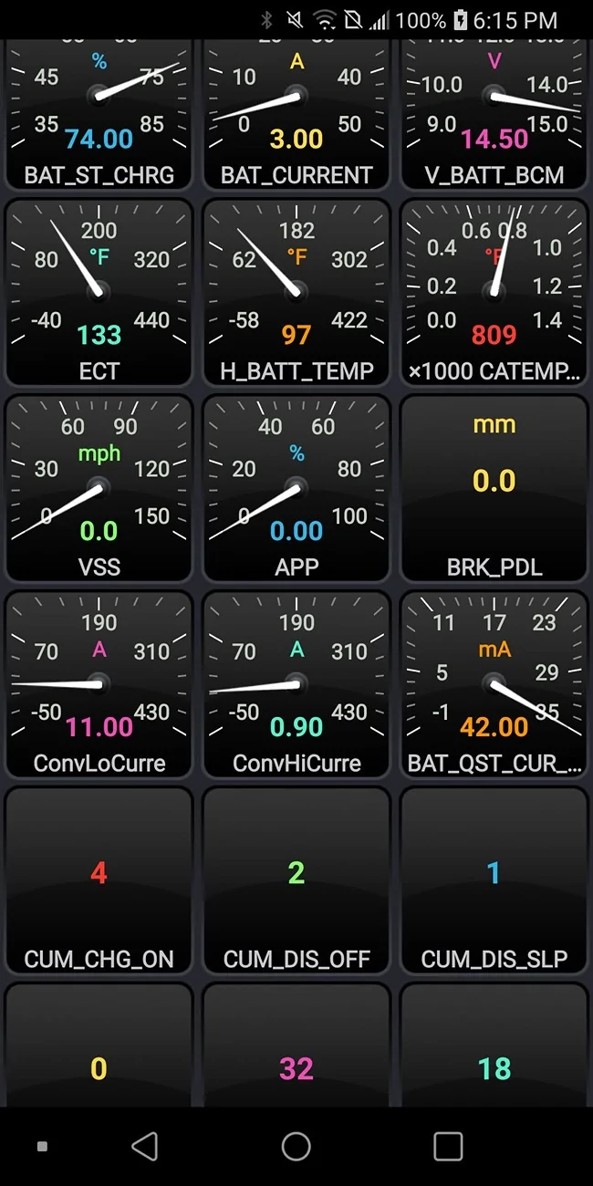

So here's the interesting thing.
I've been tracking before Key On and HVB brought online, the SOC%, V, and prior sleeps Battery Quiescent Current (which is tracked under Cumulative Dishcharge Sleep Mode), still can't decide if avg or max.
Last 32 days the SOC% & V has of course been dropping steadily - the undercharging issue.
But here's the PID's of what it thinks the cumulative figures are. Based on the sensor on the negative post - which is supposed to be reading amps, I'm assuming the system can tell time correctly for Amp hours math.
This is after driving for a bit, started around 12.1 or 12.2 V, at 74% SOC it's already dropped to only 3A of current, no longer attempting to get back to 85% it appears.
But from the Cumulative readings - the BMS thinks it's ahead.
4 Ah cumulative charge, but only combined discharge of 3Ah.
Even if that's 3.55 rounded up, and 3.45 rounded down - the system still thinks it's ahead.
But the drop proves it's not, by a decent amount.
I'm really thinking that ammeter is not accurate for one direction mainly.
Maybe there's another reason for it's confusion.
Truly just battery degradation, like it's loss just sitting on a work bench, in 32 days?
