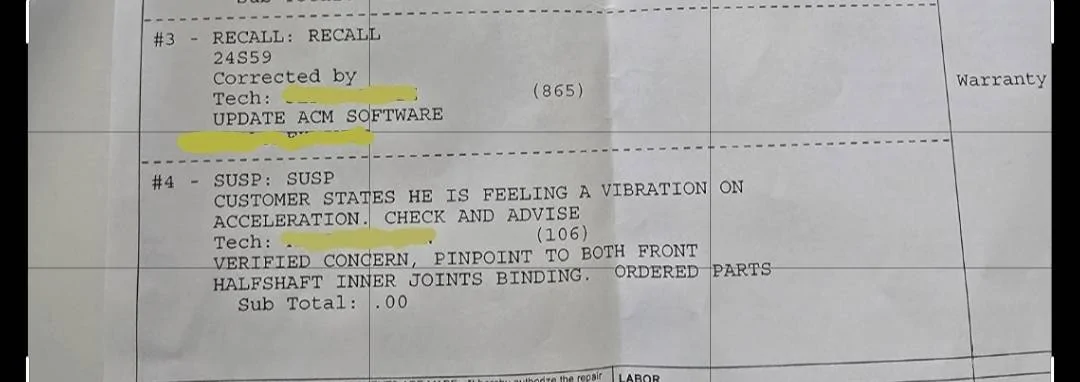

Having the same issue with my 22 XL AWD. I bought it used with 15k miles, and it's at the ford dealership now being inspected for the issue. I'm curious if anyone knows whether or not aftermarket tires, rims, and possible lift will affect the warranty.

Covered under warranty, but parts are on back order. They are saying about a month out.

Haha, yeah all it is is a CV axle but they will replace both.
Best of luck!

aitch-2-oh
J
Nov 15, 2021
375
727
Chicagoland
Taurus X
Piggybacking on this thread after a ‘half shaft’ word search within this site: I was experiencing the same shudder on acceleration, but a slight vibration was always present at low speed.
The dealer now has it, confirmed my diagnosis and is waiting for the part. I’m hoping the fix is permanent.
36k miles, all trouble free until this. Stay tuned.
