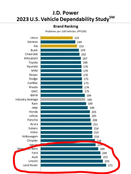

Don't get me wrong - I love the look and style of my truck....but the overall build quality just does not seem good. And for those who say it is a cheap truck, mine was $31k. Sorry but that is a good chunk of change. I understand economy, I do not understand sacrificing quality for economy, which is what seems to have happened with the Maverick. Do they want to be the Yugo of the truck world? (I'm using that extreme of an example only to make the point).
I just realized, seems like almost every post I make on this forum is negative.... and I'm generally not a negative person, not a complainer by nature. My apologies for that.
It's sad that I am kinda nervous to put a lot of miles on my truck. It mostly sits in my garage looking pretty. This coming from someone who has put 70,000 miles on a car in one year, more than once.
I posted this in another thread, it is worth re-posting...speaks for itself. The JD Power numbers do not lie, it's the one survey you can pretty much bank on:
