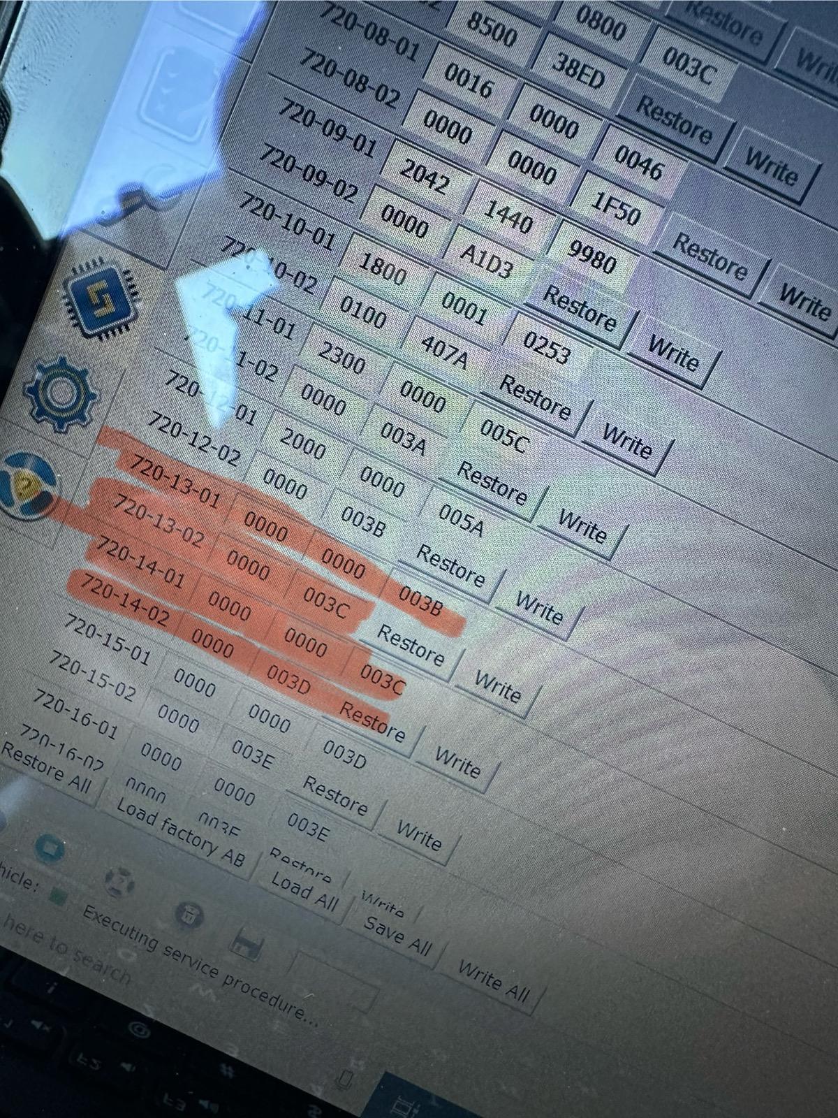

Hello everyone!
I finally found the way to disable the ANNOYING Seatbelt information screen that comes on when you start the truck and stays on even after you buckle your seatbelt. Thank you to 2023 F250 forums for the coding information.
DISABLE SEATBELT INFORMATION SCREEN
1. Open IPC AS BUILT
2. Change line 720-13-01 and 720-13-02 to ALL ZEROS. And WRITE the changes. Click yes to let Forscan correct the checksum.
3. Change line 720-14-01 and 720-14-02 to ALL ZEROS. And WRITE the changes. Click yes to let Forscan correct the checksum.
These coding changes worked for my 2024 Maverick XL AWD ECOBOOST. These changes remove the seatbelt information screen entirely and also disable the seatbelt chime and light all together. I would love to hear from other members to see if these changes work in your Maverick! Also, I have the smaller instrument cluster. (The 4 inch Instrument Cluster)

I found the coding to disable the menu so it doesn’t really matter. Idk why anyone would want to keep that stupid seatbelt menu. There are times where it will not disappear at all unless you hit ok and in a recent update if anyone in the car unbuckles the seatbelt, including the back seat, it will lock you out of your entire cluster until the seatbelt is buckled or it detects that no one is in the seat anymore.

I’d rather do my Forscan mod and delete it all together. What if you have rear passengers? Also on the 2024s the screen does NOT disappear after you put on your belt on. It stays on for 1 full minute after unless you click ok, which it won’t let you click ok in some situations.
