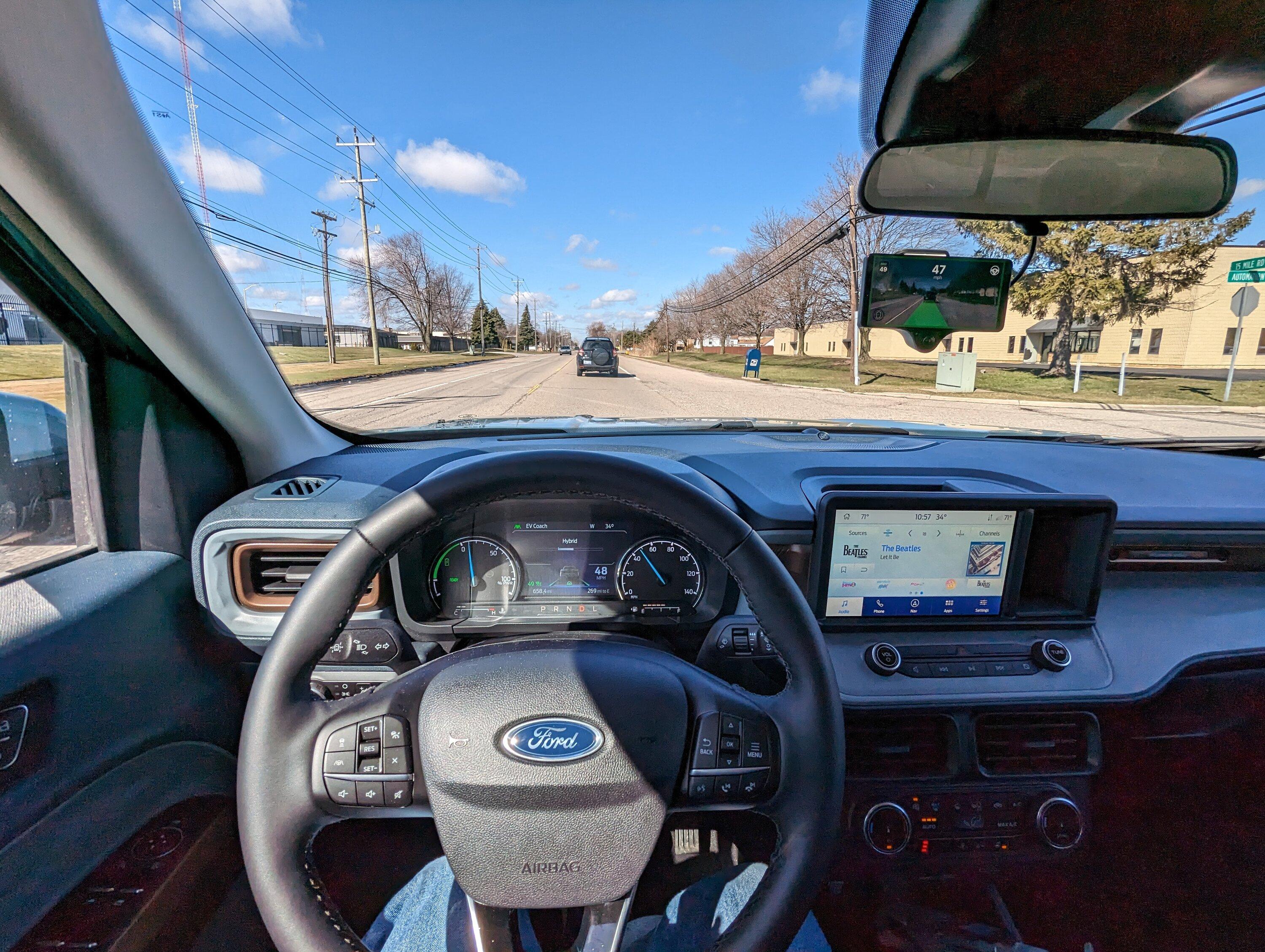

Ford Maverick Has anyone tried OpenPilot on the Maverick? PXL_20230402_145758142
It works. Need ACC or lux copilot 360 with a CCM added. You need to run the ford-devel branch for now and need an angle adapter since the windshield is too far upright. It's nice for long drives on the freeway.

What's the difference between ACC on the freeway and Open pilot?
entheogen
Feb 9, 2023
Sacramento
I can't speak for the branch that the poster is using, but a goal of open pilot is to have speed control on cornering. That's something I believe bluecruise intends to do but not something ACC will ever do (because you can't determine speed requirements with radar alone). It'll also have different algorithms for predicting traffic/ merge/ lane change control. Likely going to be more refined and continue to receive updates on the OP official branch. These are just some examples but I haven't been able to do a side by side comparison myself yet so this isn't a complete/ definitive list.

You need to run the Ford-dashcam branch for it to work on hybrids and need an 8 degree mount for it to see properly. It works out if the box with the angle mount on eco boosts. You can 3d print one or buy one. If you're adventures, sunny pilot fork works with some slight coding changes for hybrid to work and that will slow down for turns and do all sorts of cool stuff you can tune. Sick with Ford-dashcam if you aren't wanting to get creative. Also adding ACC to a car without it isn't terrible but it's definitely a weekend project and about $700. One day to put the hardware in and one to mess around with forscan. I'm in SE Michigan and can give you a test ride if you're that way.
