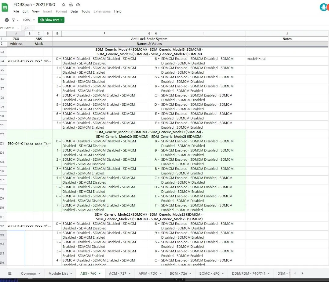

Ok! Got it fired up and poked around a bit. My first goal is to enable sport mode on my FX4 (and hopefully figure out the settings for enabling/disabling all modes on any trim). There's a bit different structure for drive modes from the F150 and from the new Bronco, and I haven't found anyone on the 2020 Escape or Bronco Sport forums that's figured it out for theirs.
Could anyone with a non-FX4 maverick post their VIN? With that we can read the original as-built settings using the ford service website. Alternatively you can go to https://www.motorcraftservice.com/AsBuilt/, put in your VIN, and tell me what it tells you for line 760-04-03.
Thanks!
Edit: I am dumb, there's a list of VINs like 4 posts up. Looks like FX4 is 0000 0001 E150 and non-FX4 is 0000 0000 6BD9.
On the F150/Super Duty one of the first values is used to set which configuration of drive modes that vehicle has. However, on the new Bronco fullsize, it looks like each mode can be toggled on and off individually. (https://www.bronco6g.com/forum/threads/2021-bronco-forscan-thread.844/page-15#post-963234)
It seems like there's a 0 for both FX4 and non-FX4 in the first block so likely we are just looking at the last couple characters on the Maverick.
