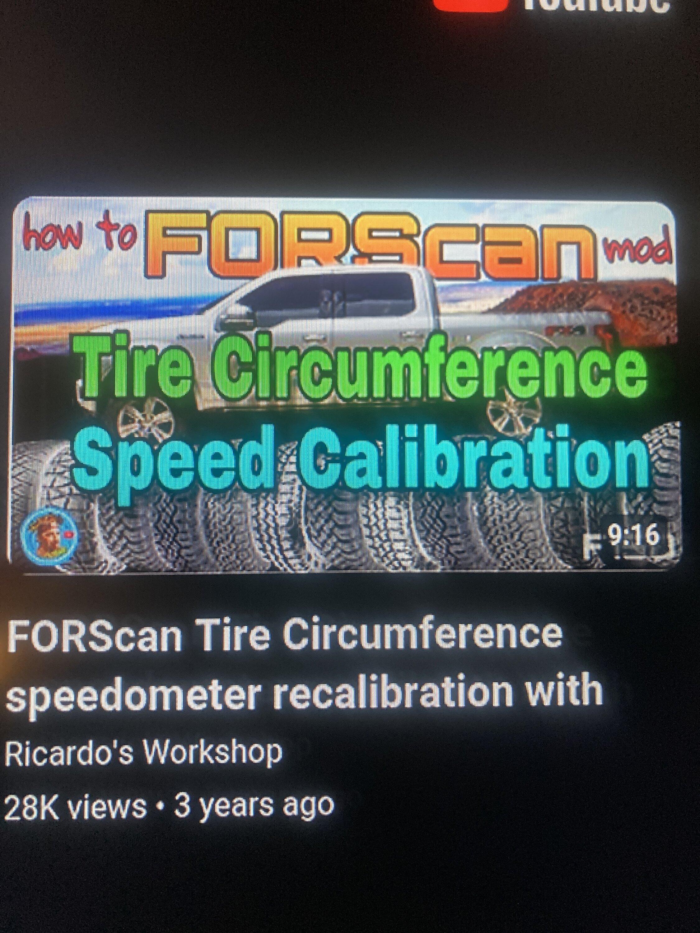

Has anyone figured out if we can adjust the tire size for the speedo? Is there only a specific range that will work?
I did see a place where it appears you can change the tire 🛞 size but that was on the YouTube video I watched & am not certain due to never trying it myself yet.

Ford Maverick Has anyone used ForScan yet? image
Someone asked about tire size 🛞 recalibration…YouTube this.
