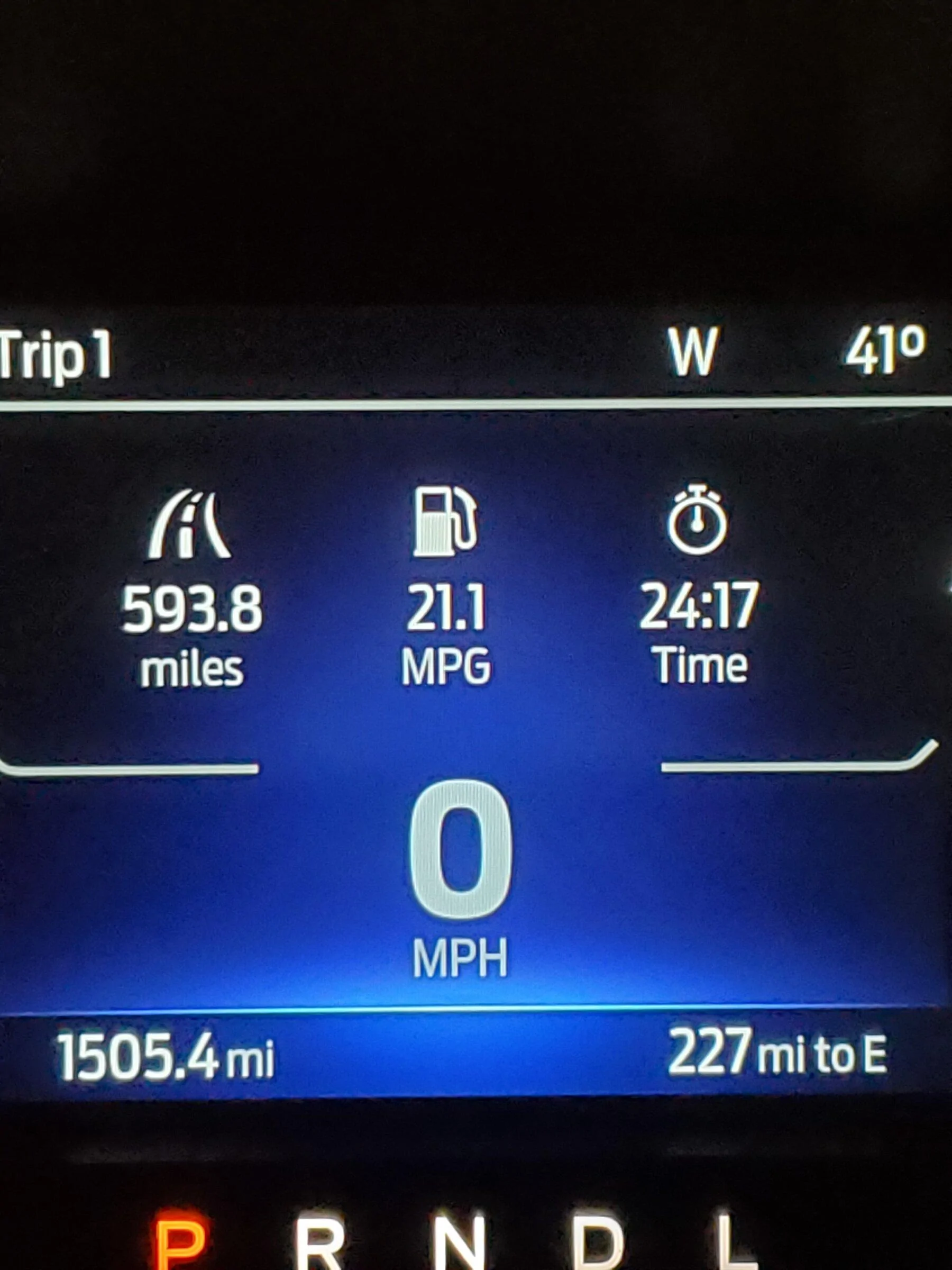

I let my truck warm up almost EVERY time I drive it, up to the 10 minutes. Mostly that's to the gym 1 mile away 5 days a week. It has probably idled more than been driven at this point. 1500 miles since Oct. I do get on it once and a while. There also was a leveling kit on it since Nov maybe. Dash shows 21 mpg, last longer trip was 29. Something seems wrong with yours.
Ford Maverick Ridiculously low Gas mileage ENOUGH already WTF is going on ? 20220305_155521[1]
