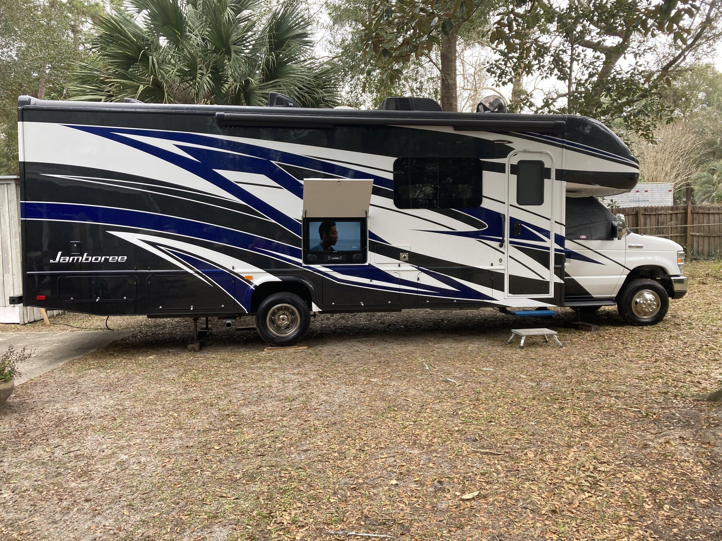

I would love 20mpg… I am lucky to get 10mpg, usually closer to 8.
Ford Maverick Ridiculously low Gas mileage ENOUGH already WTF is going on ? F6993E2D-5BAE-4A31-9BF3-A189CB0356E3
