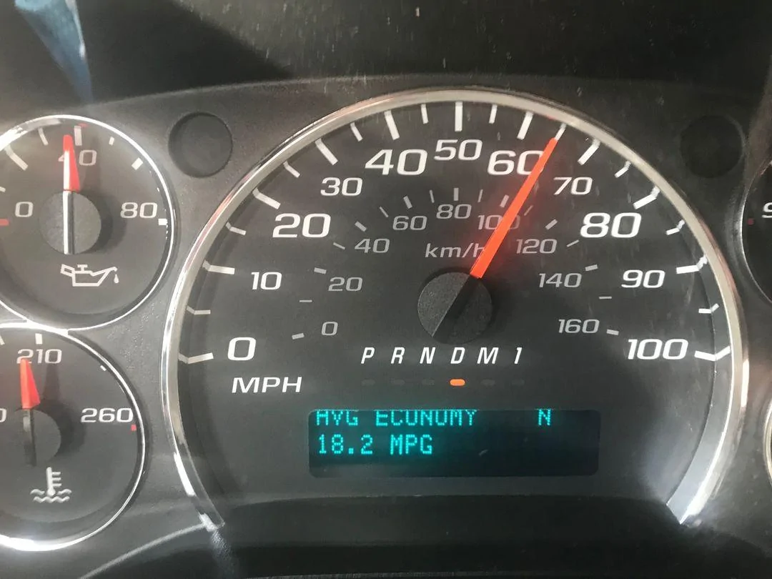

With my 4k XLT LUX with the 235 Falken Wildpeaks in the cold of Maine doing 95% city driving to work a few miles away I'm getting 18.2mpg of the computer. Fully tracking says it should be 17.2mpg and that is with a mix of remote starts and non remote starts. I don't baby it but also haven't went over 4k rpm only at 500mi so far so may still be breaking in. That is still almost 2mpg better than my 15 escape 2.0l AWD was getting in same conditions.

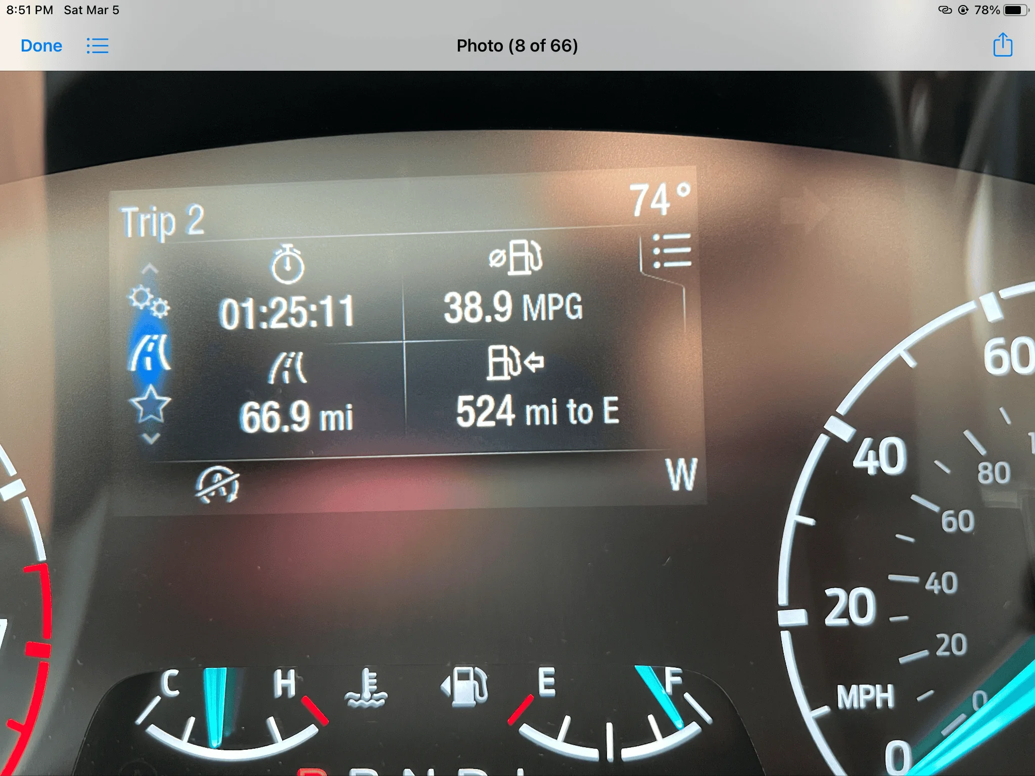

My son got this driving to work and back at 65 mph just to see how good his mileage could be. EB XLT

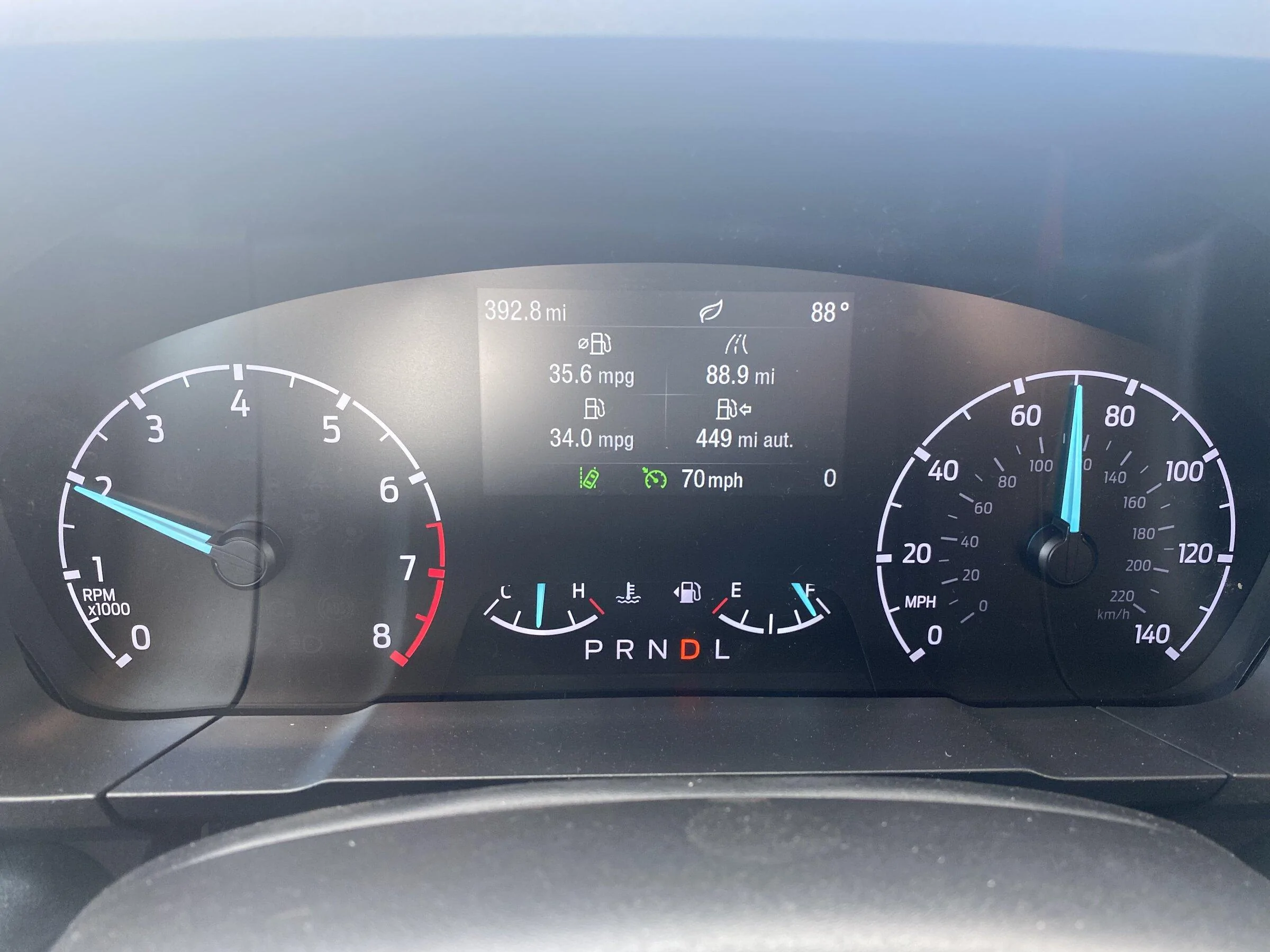

Something is wrong on your Maverick!!! That’s was today a 70mph with 5 adults inside from Tamarac, Fl to Naples Fl. Maverick Ecoboost 2.0 AWD. XLT (not FX4)
