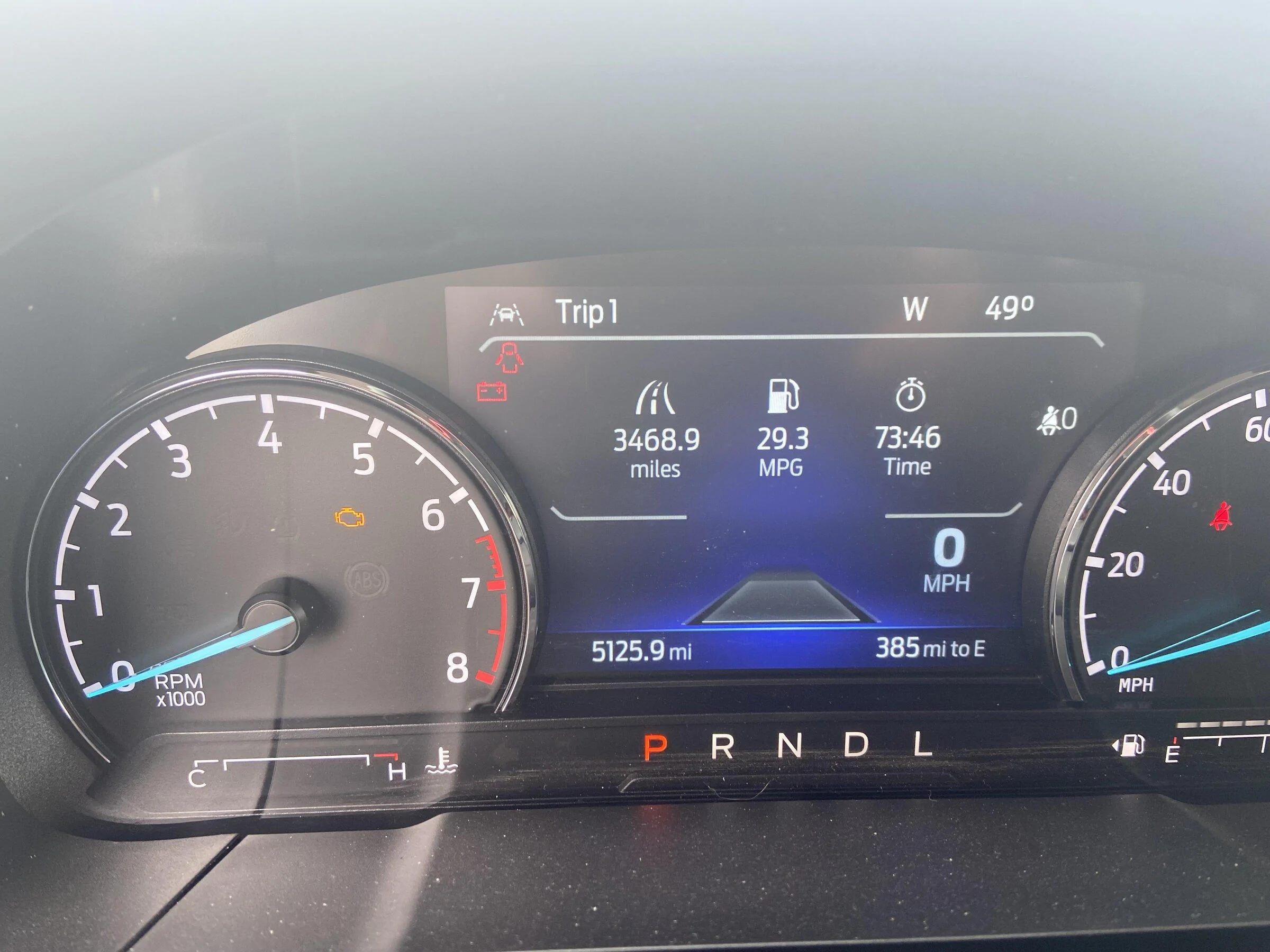

This is what I am getting. Eco fx4 4k Lariat Lux all original. using only 87 60% hwy, 10 city 30 % nasty dirt roads. Hand calc's usually yield 4-5-6% less than the computer. But this is over 3468 miles. And most of my trips gain over 1,000 in elevation, of course it's down hill back. I would guess yours can be better, but those tires hurt.
Ford Maverick Ridiculously low Gas mileage ENOUGH already WTF is going on ? IMG_0293
