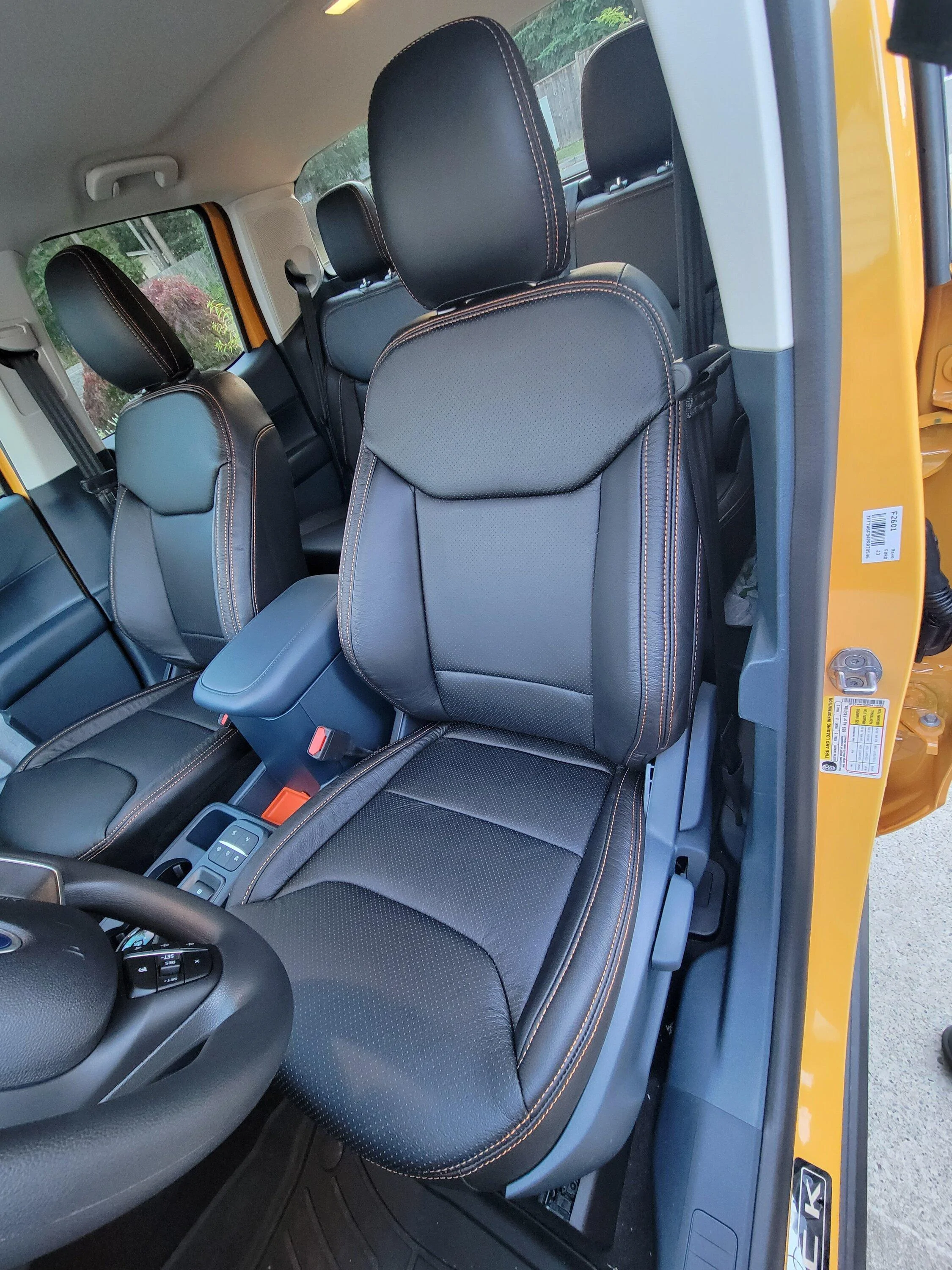

I have a velocity orange truck so I love them, but they are tangerine, not orange. I got the seats recovered in black leather with orange stitching, it looks amazing with the tangerine accents 😍

See, and the center console is getting recovered in a week. And the steering wheel has been swapped out as well.
