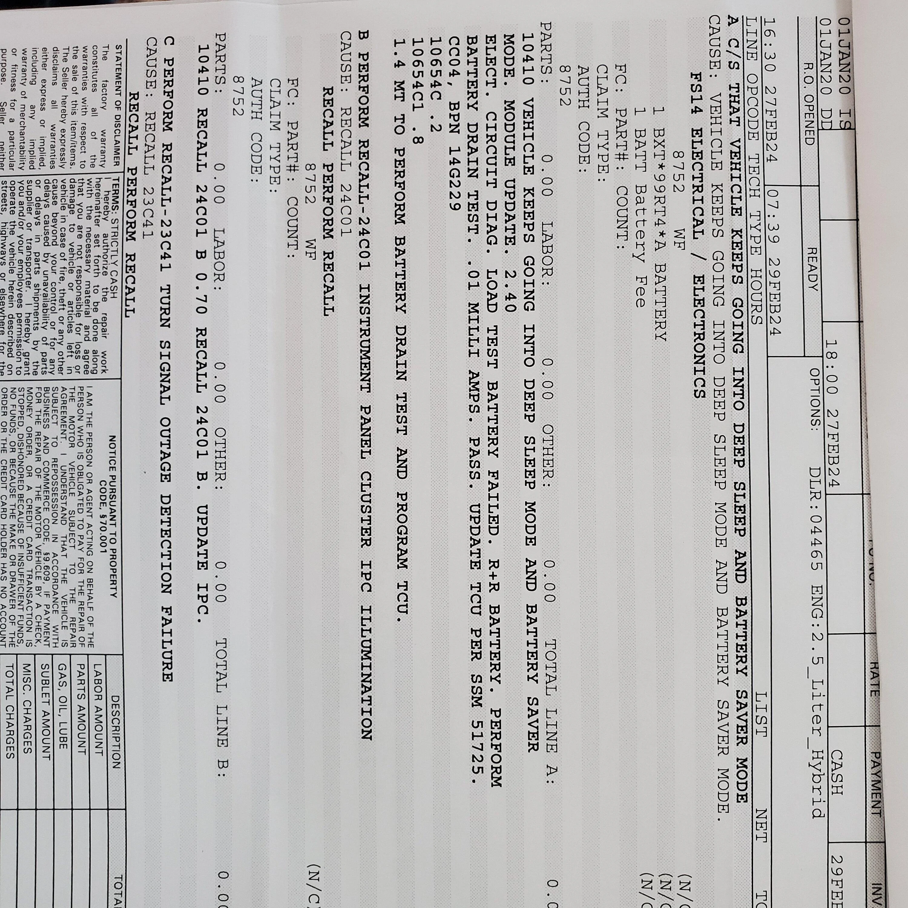

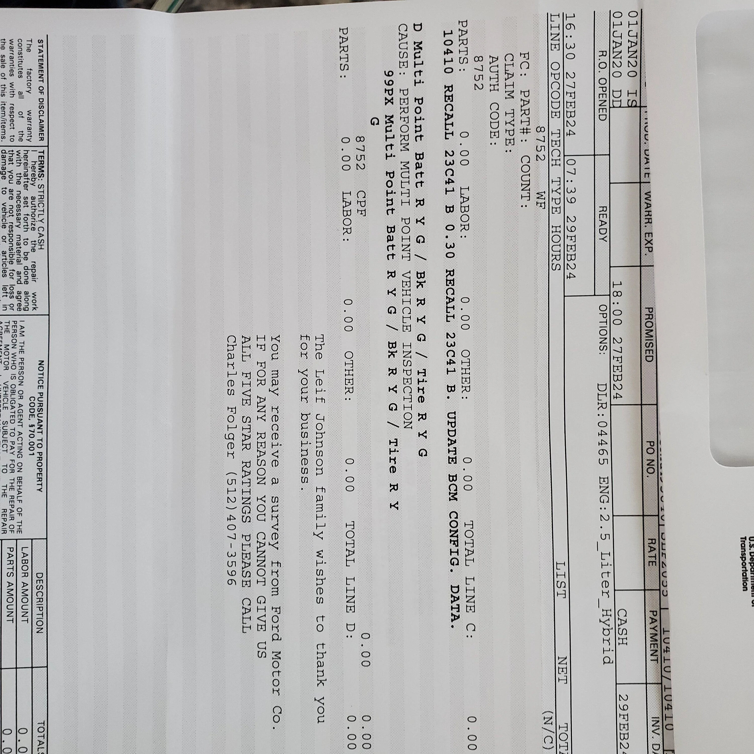

22 XL hybrid taken to service for couple deep sleep alerts 2/28. They kept one day, replacing battery, reprogramming battery monitor, reprogramming blinker warning, reprogramming instrument lite. No charge.
Already did catchy brake thing twice and one oil change last year. Now at 14K. Feel pretty good about the vehicle at the moment.
We'll see...

Ford Maverick Recall #24C01 - Instrument Panel Cluster IPC Illumination - 2/26/2024 20240301_074343
Ford Maverick Recall #24C01 - Instrument Panel Cluster IPC Illumination - 2/26/2024 20240301_074404
