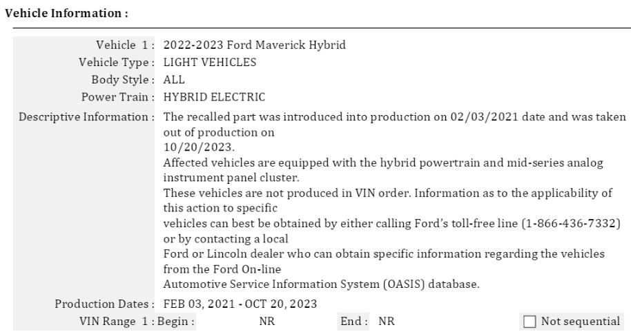

I see this recall in Fordpass app. I will go by some time this week and see if I can make an appointment. I really don't want to take it in.

It's not just brightness of the gauges, the notice also says telltales may fail to illuminate. That could be a Check Engine light, for example. This might be a good one to have done.

More than that. The entire backlighting can fail to illuminate.

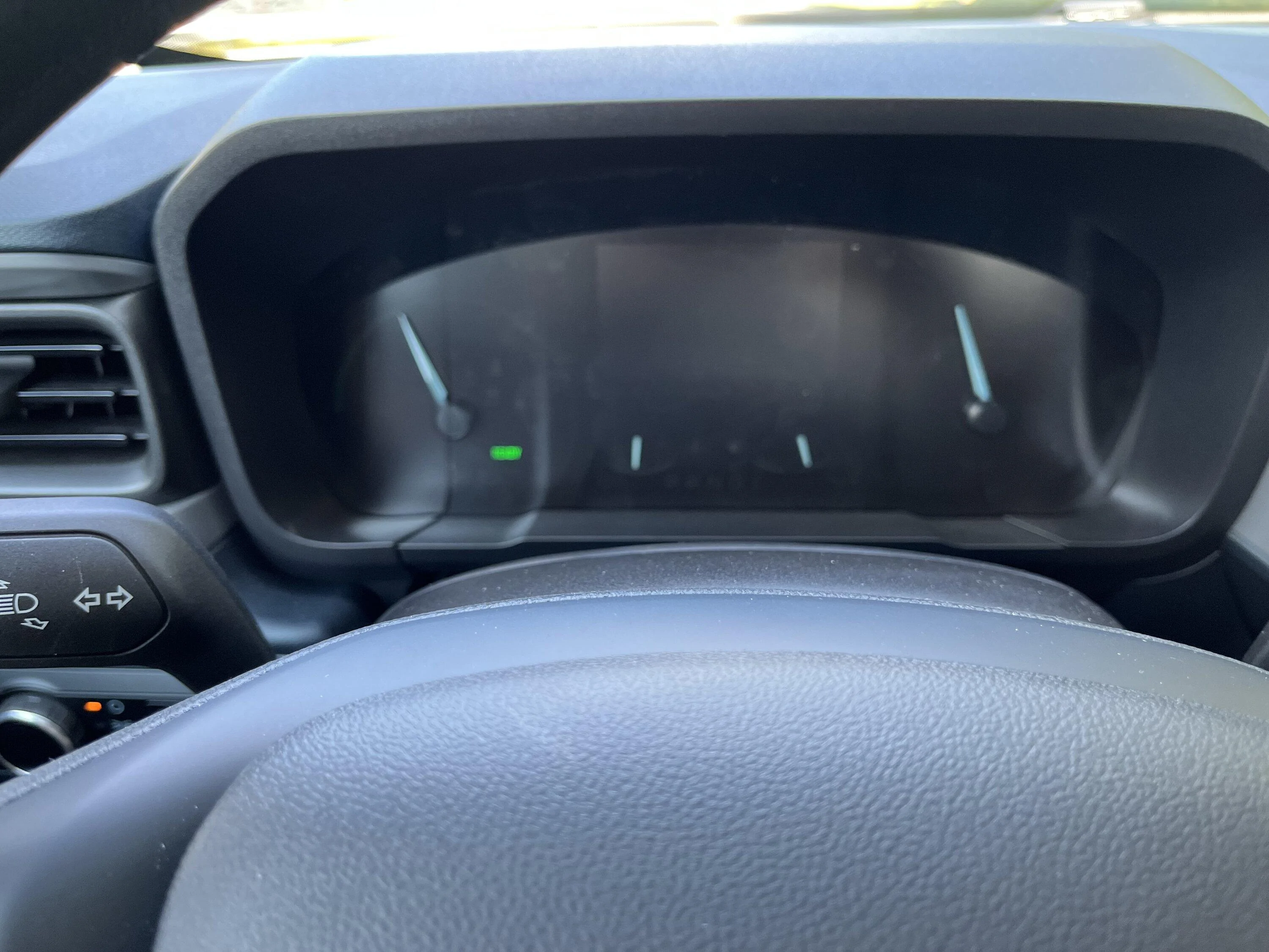

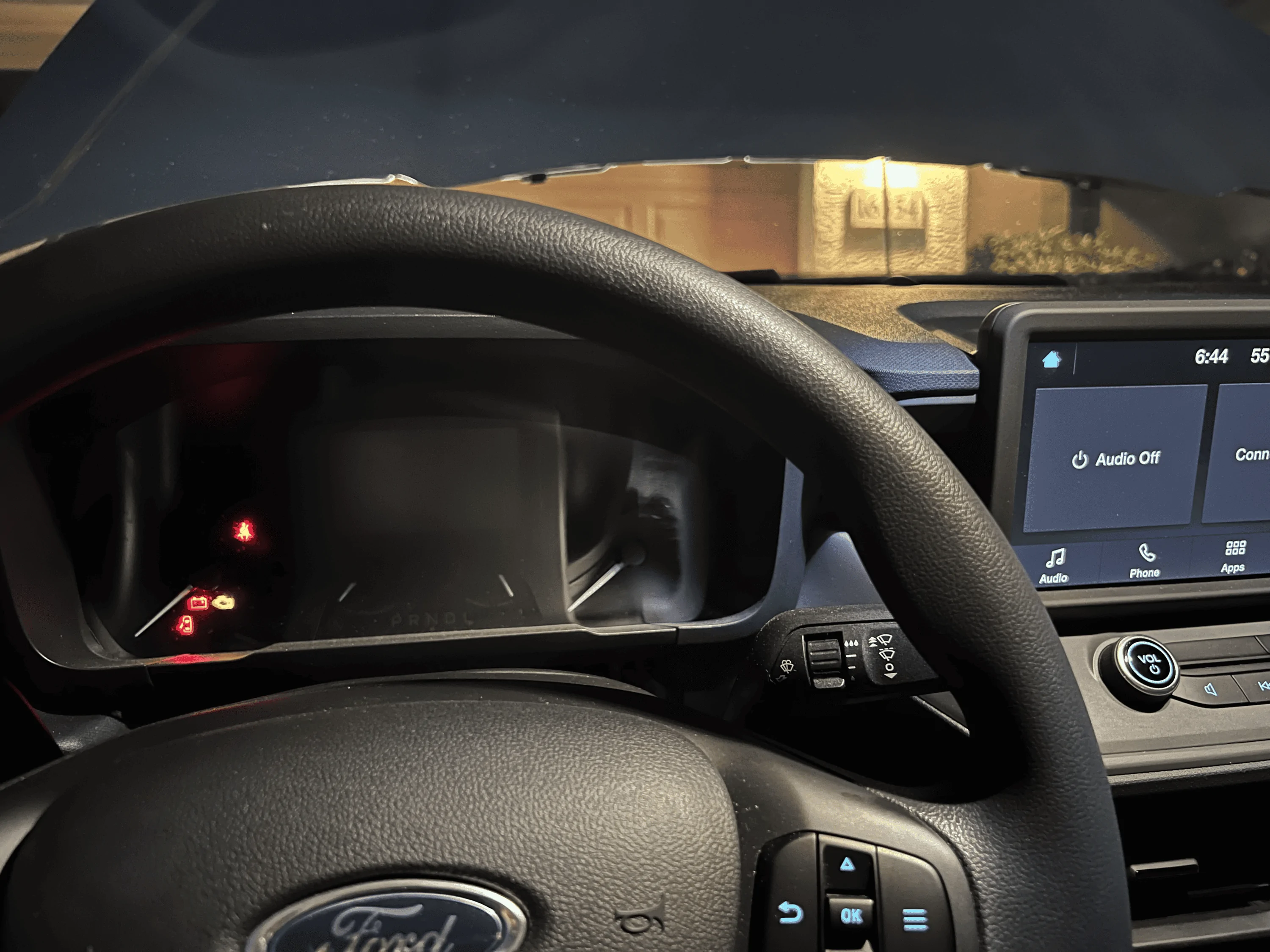

This is a pretty important one to address. Should this bug crop up, your IPC will look something like this. Won't be able to read your speedometer, et al...
Had my 2023 XLT instrument cluster go out on me. The fuse was blown, but the real question was why. 6,000 miles. The dealer had to replace the IPC cluster. Ford had a recall last yr w IpC on Escapes. This cld be a official recall on the Maverick very soon.
