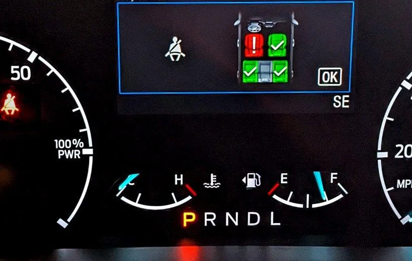

Had both 24C01 and 23C41 recalls done at the same time. Now, when you unbuckle the seat belt when the vehicle is on, you lose the ability to use the instrument cluster menus until you either open the door and/or re-buckle your seatbelt.
So let's say you just parked and wanted to check your mileage or tire pressure, you must either open the door or re-buckle. It's annoying.

I also noticed this change after the recalls, too. At least was able to disable the damned chime for the driver's seatbelt again after the recalls, but this new nag box won't go away, and eventually returns after hitting OK. I only drive w/o my seatbelt when going from my house down & up a long gravel private road to the mailbox.
I suspect Ford added this additional annoyance to increase their NHTSA seatbelt/safety ratings for the Maverick.
All the nanny-ism annoyances on this vehicle spoil what would be an otherwise great vehicle user experience.

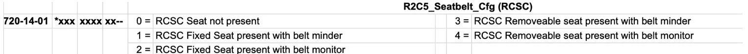

If you would like to keep the Minder (the dash light and chime) and not the Monitor (the seatbelt screen) I would suggest doing the following coding based on this diagram and my original coding in my Maverick.
720-13-01 9100 0001 8000
720-13-02 0110 1000
720-14-01 1000 0000 0000
720-14-02 All Zeros

My 720-14-02 was already ALL ZEROS from the factory and yours probably was too. My 720-14-01 was ALL ZEROS except for the first digit which was a 2. In the picture below you can see why I changed this line of coding too! The last two numbers of each line of code are just checksums. Glad it’s working! Thanks.
