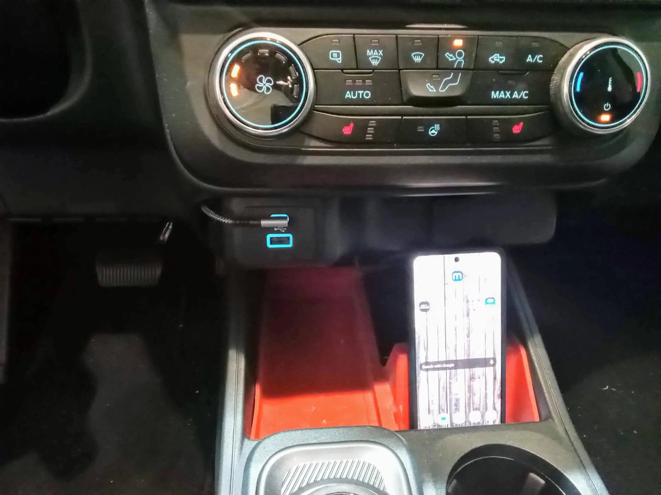

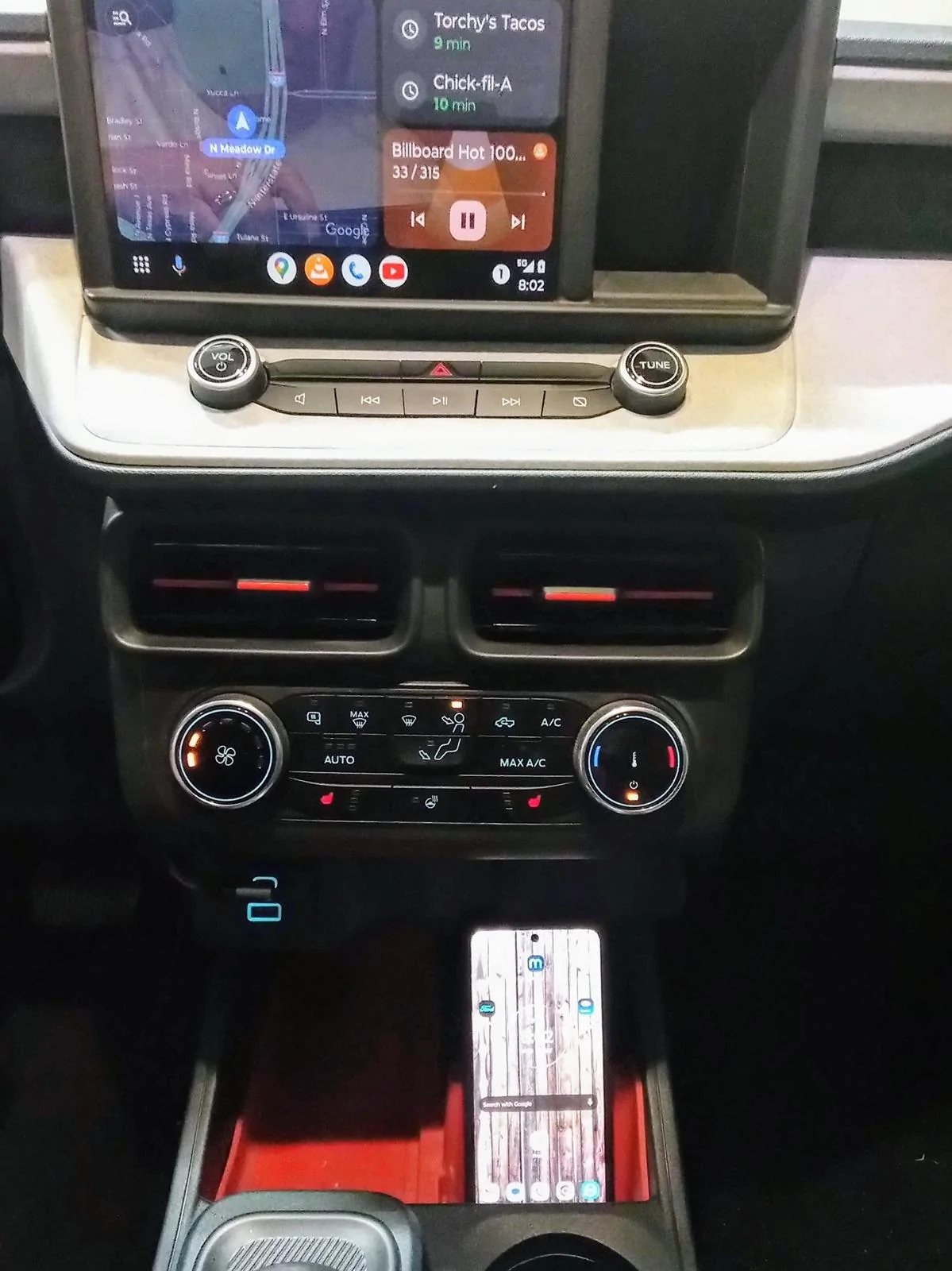

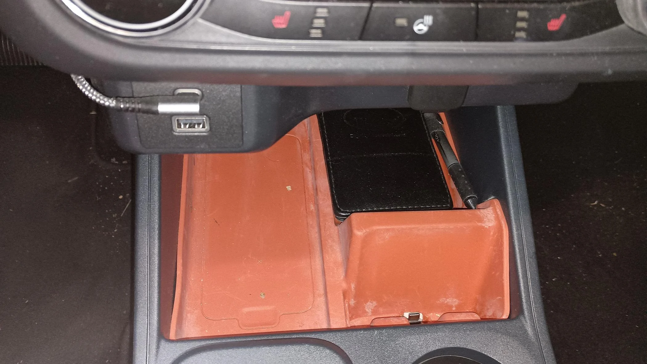

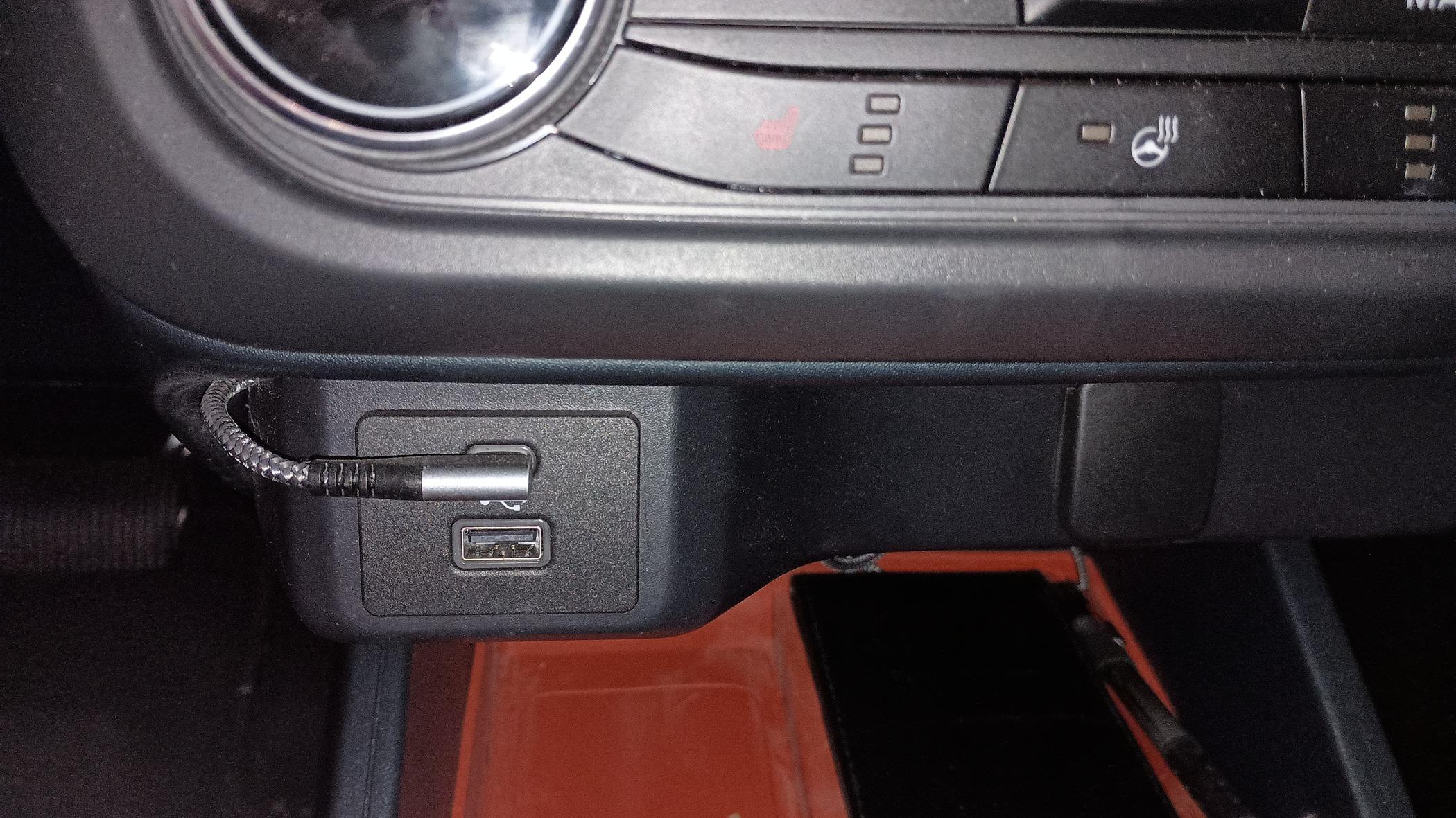

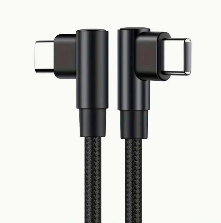

I have the same Moto G Power and if using BT, it will drop calls. I have found that using the USB cable connected through Android Auto will eliminate this issue. I did a simple mod to plug the phone in to the orange storage area just beneath the the cigarette lighter outlet. It work very well for me. Please know that your phone must be unlock when you plug it in for it to connect to Android Auto (it may take about 3-5 seconds and my ask for permission to connect).

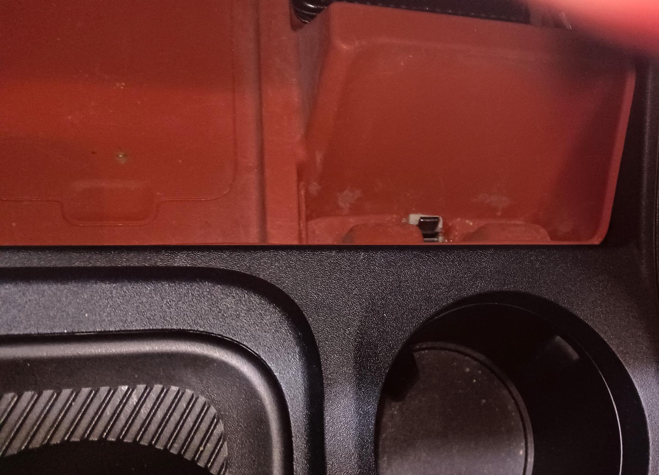

I used a trim tool to pull the trim piece where the cigarette light and USB sockets are mounted and used a small file to on the left side to make a small grove so the USB cable would not get pinched. I ran the other end of the cable to the back edge of that mounting trim piece (there is a lot of room in there where you can leave any extra length of cable you don't need). Then ran it down under the orange tray's center raised area and the cut a slot just big enough to slip other end of the USB cable though and where it would come out just enough to plug into the phone. I did have to place a bit of extra silicone glue under the back side of the orange tray so to create a solid mount for the USB plug.
The phone now sits snugly under the cigarette plug so the phone does not move out of place when driving. After taking the phone out a number of times the orange tray will stay in place.
