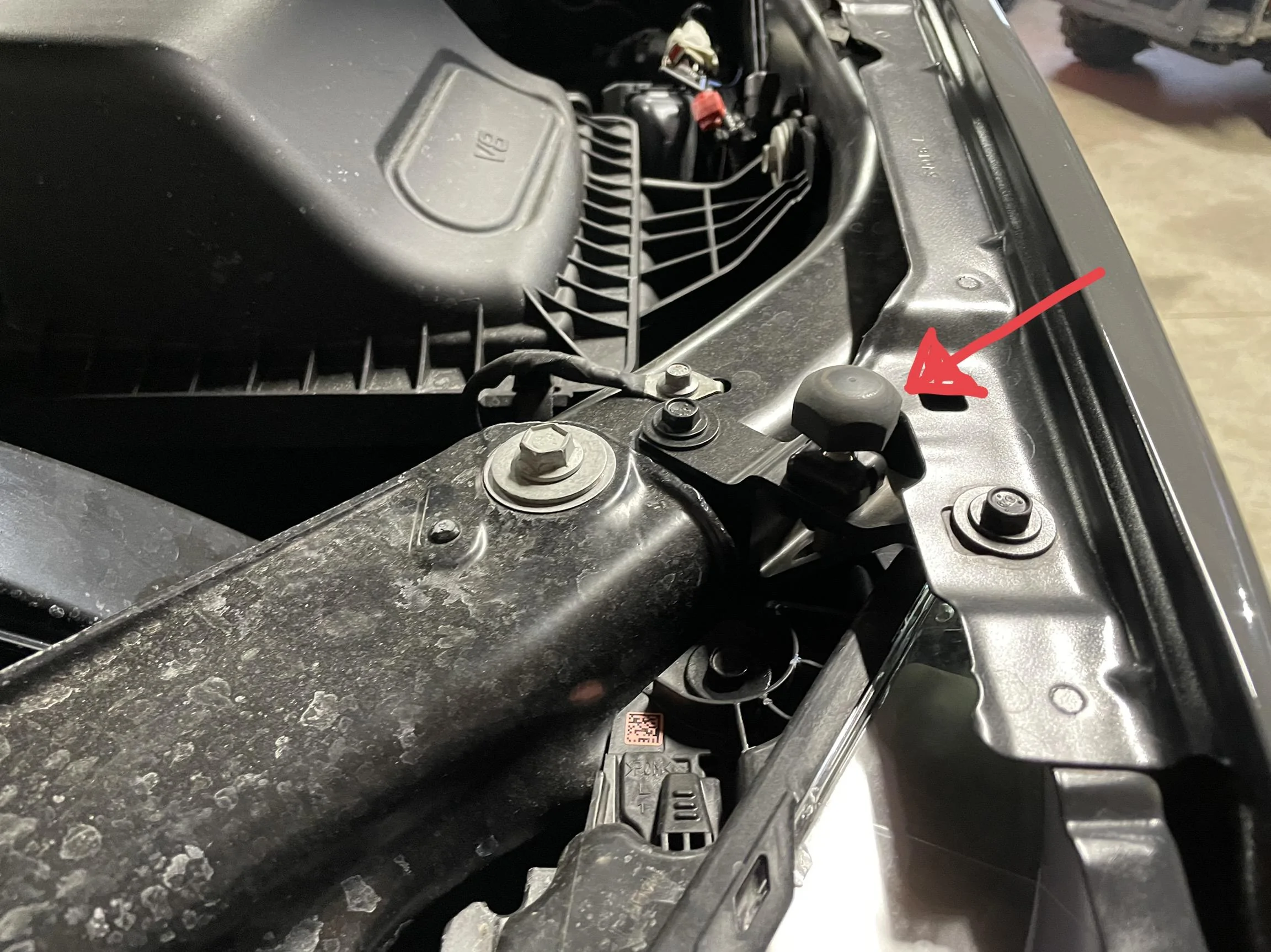

My rattle started sometime around 1000 miles. The noise seemed to come from the dash area. I tried a suggestion from another forum .. removing the triangle mirror bolt cover inside the vehicle. Tighten the two mirror bolts and the trim bolt and then tape all touch points with cloth wire harness tape. This did not work for me.
Today Iā€˜m almost positive I figured it out. It was the actual hood that was rattling. Go to the front of the truck and grab the edge of the hood and try to move it up and down. When I did this, there was movement up and down. Open up the hood and locate the two rubber hood stops. They are adjustable. Rotate counterclockwise .. extend them so that when you close the hood it meets those rubber bumpers more firmly. There should be no play. Continue turning the bumper until all play is eliminated.
