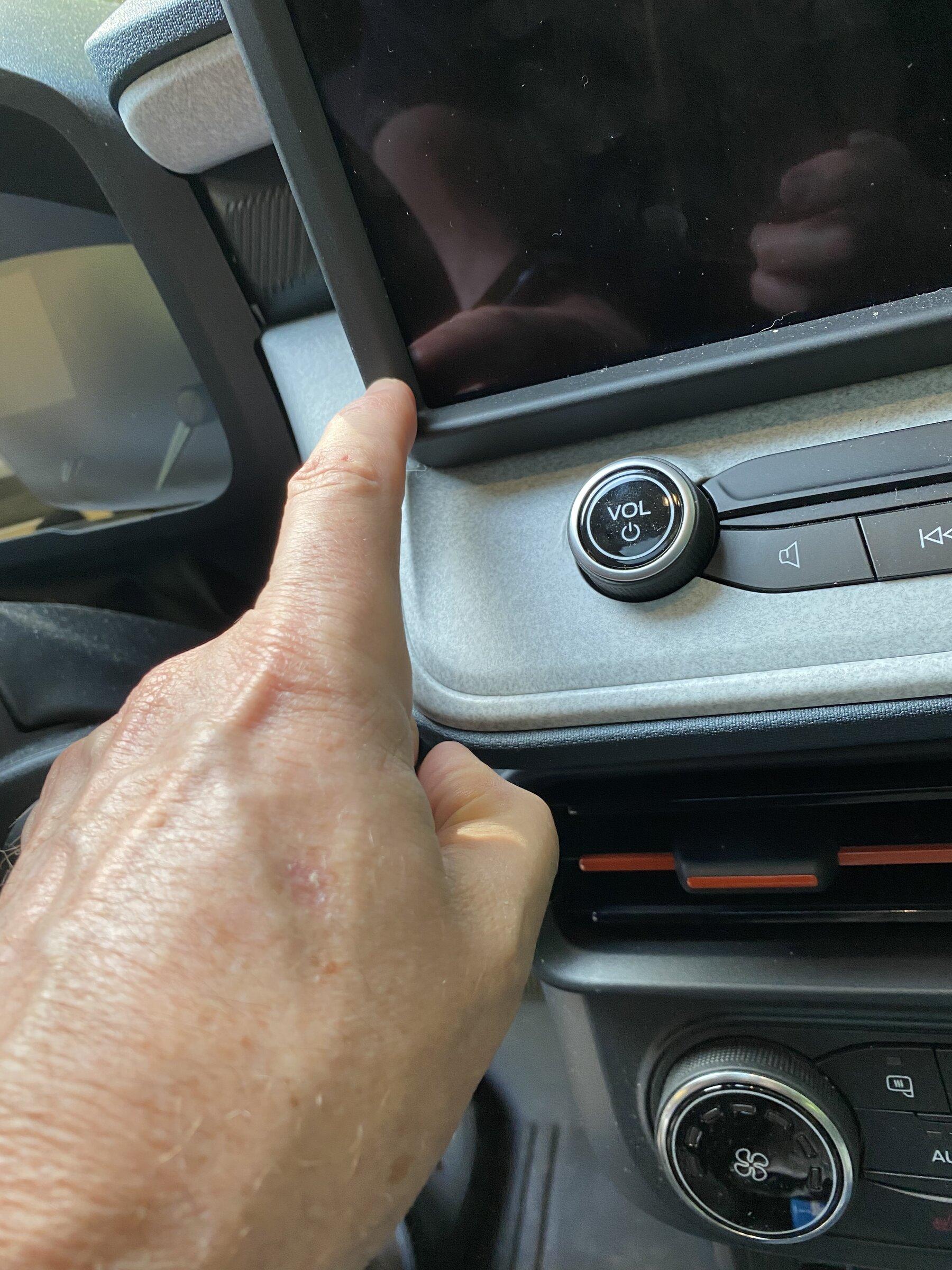

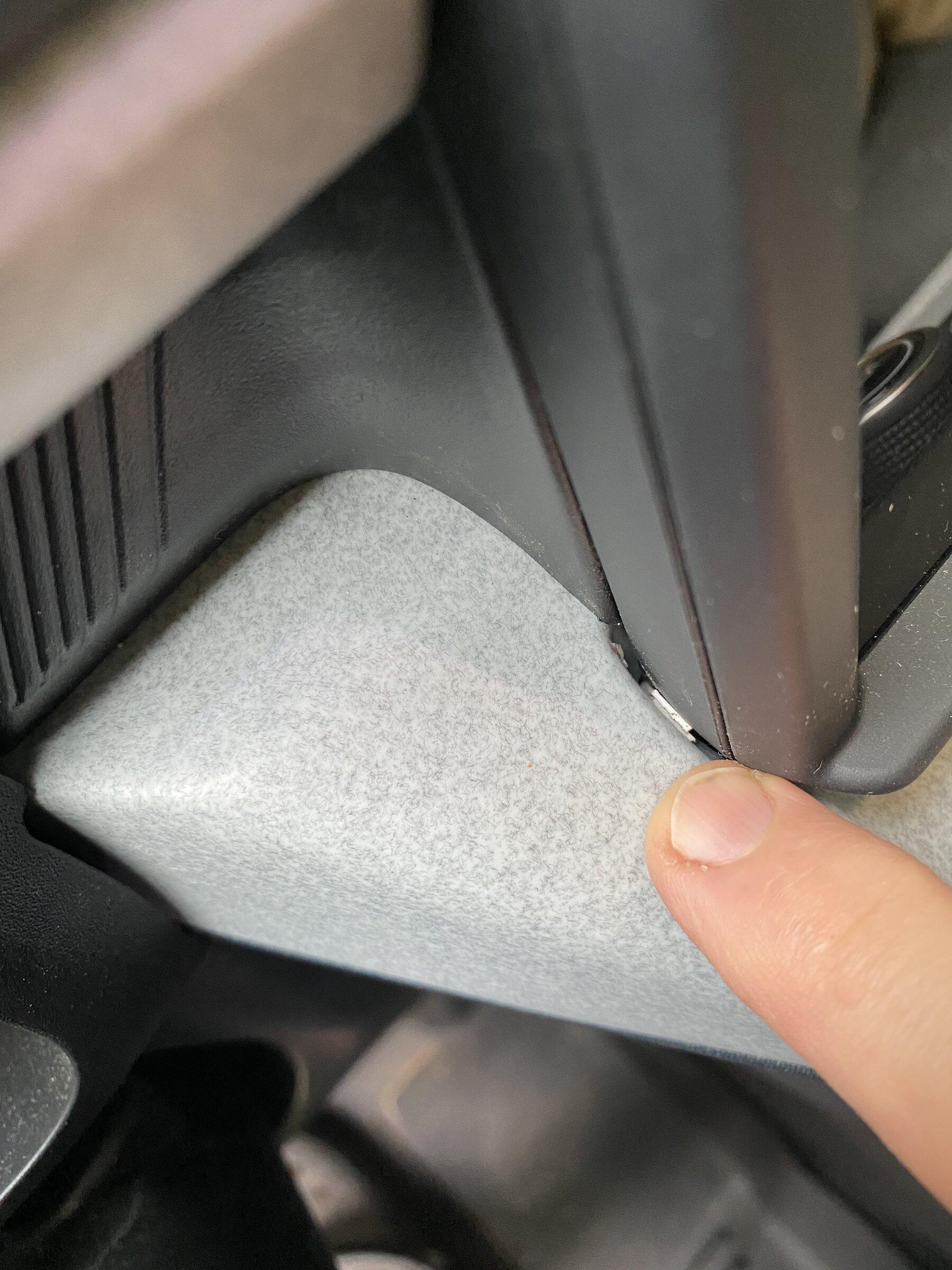

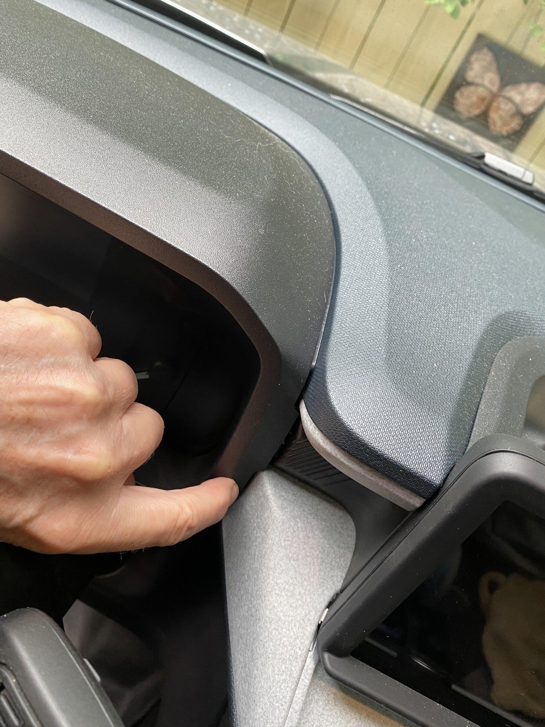

I’ve had the rattle for a month and it sounds like its the center of the dash. Today I just started tapping on the door dash area and replicated the sound from the radio screen. Tapping the blue color housing that holds the screen. Incredibly loud just by barely tapping where my finger is. Did not drive it today to try and fix it but if that isn’t it it will be it at some point. There are several places around the corner of the instrument panel you can tap and get a rattle especially on the right side of dash panel to the left of my finger.

I pretty much fixed my rattles by inserting padding so hard plastic wasn’t hitting hard plastic. Where the screen housing hits the dash I stuffed in padding and where the curved instrument panel meets the dash beside the screen I stuffed in some black padding. Drove yesterday and it eliminated almost all rattles.
