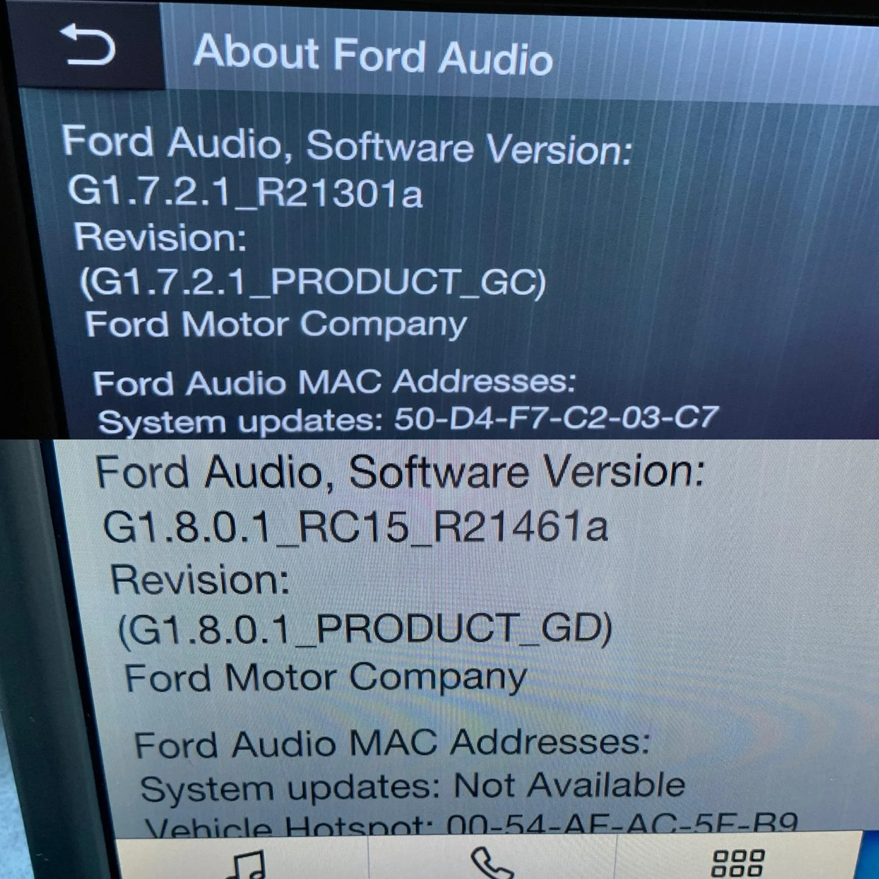

Can someone post the latest software version so we can see if we are current?

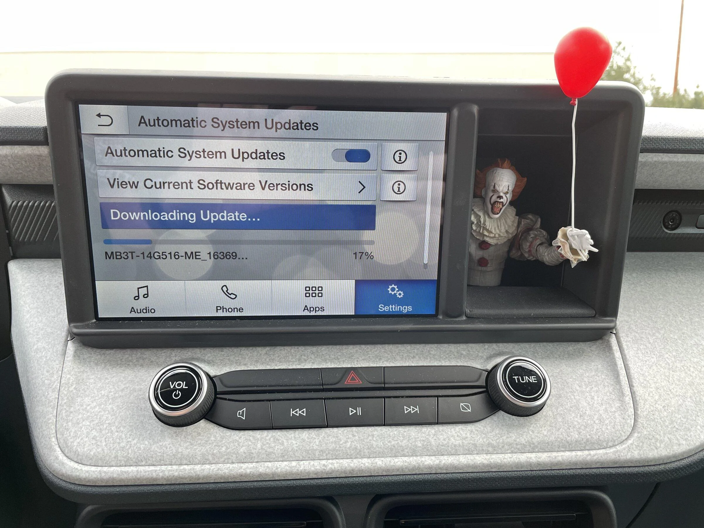

Not entirely sure if this has been said so sorry if I’m repeating someone. But I can confirm u can update the software from an iPhone hotspot. It notified me that the update installed after I did the master reset (hold radio power button and forward track button simultaneously until screen goes black). No need to restart the whole truck if u don’t want to

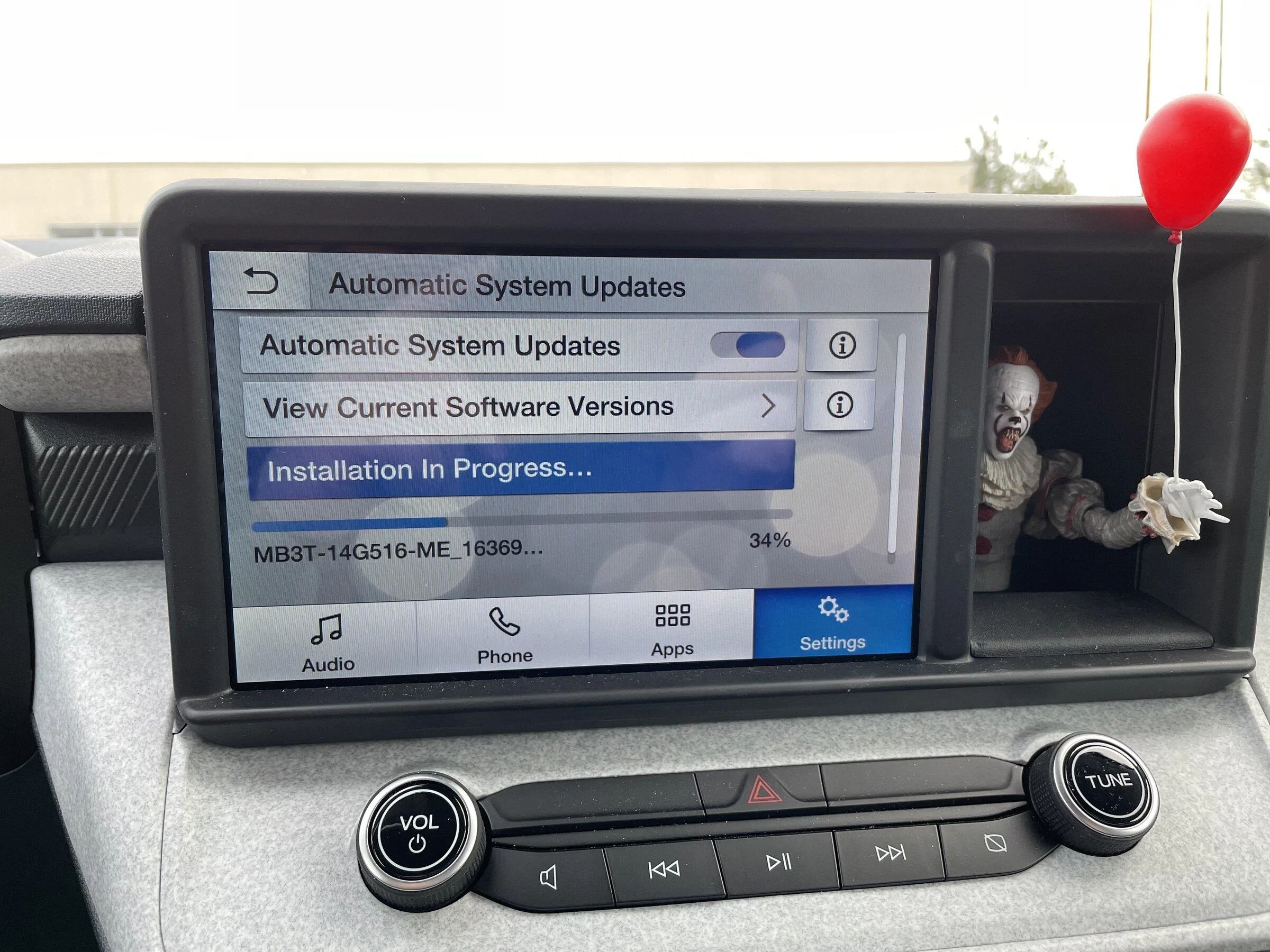

finally after a second master reset it downloaded and is now installing hopefully it goes thru.
AWESOME Pennywise....
