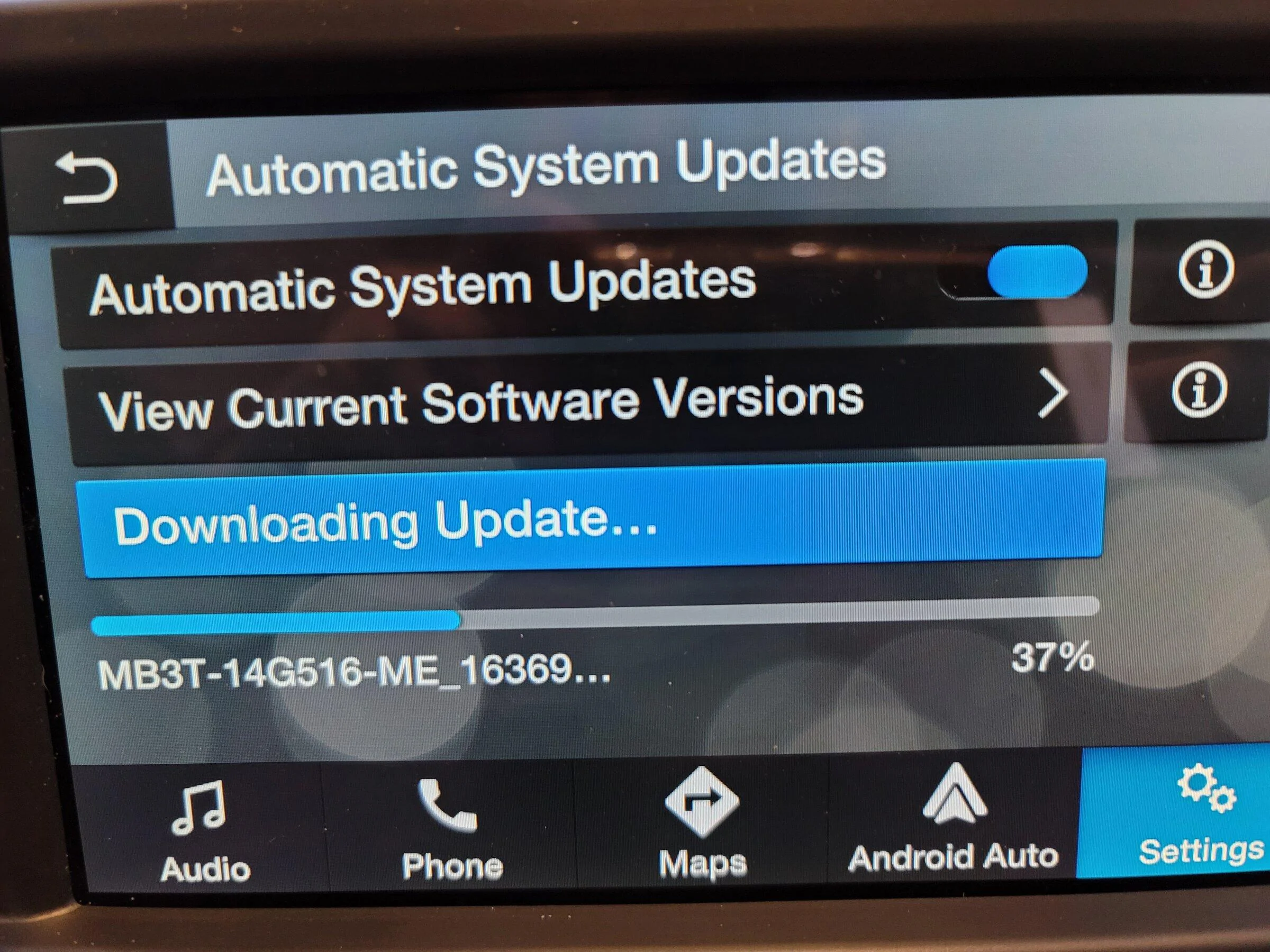

When mine got stuck for more than 10 minutes at the same percentage, I just started again.
How do you restart it?
I disconnected the Wi-Fi and nothing.
Also turned truck off and restarted that didn’t work either.
Been stuck at 94% for over 25 mins.
I even prioritized the Mav’s connection on my home network.
Been 3 hours and 38 mins.
Now I have hungry kids and an angry wife waiting too since I have been sitting in the truck this whole time. Burning $3.75 a gallon gas too…

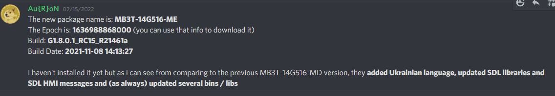

From what I have seen, appears to be no direct option for non Sync 3 radios.
Depending on which version of firmware this is, here is a screen cap from a Discord forum with the changes to the existing firmware 1.8.0
This firmware version G1.8.0.1_TC15_R21461a is exactly the same as to what came with my Maverick Hybrid that was build 11/29 and shipped 11/30.
So this firmware is not new.
If you do have older firmware it is a good idea to update as it fixes many of the radio issues.

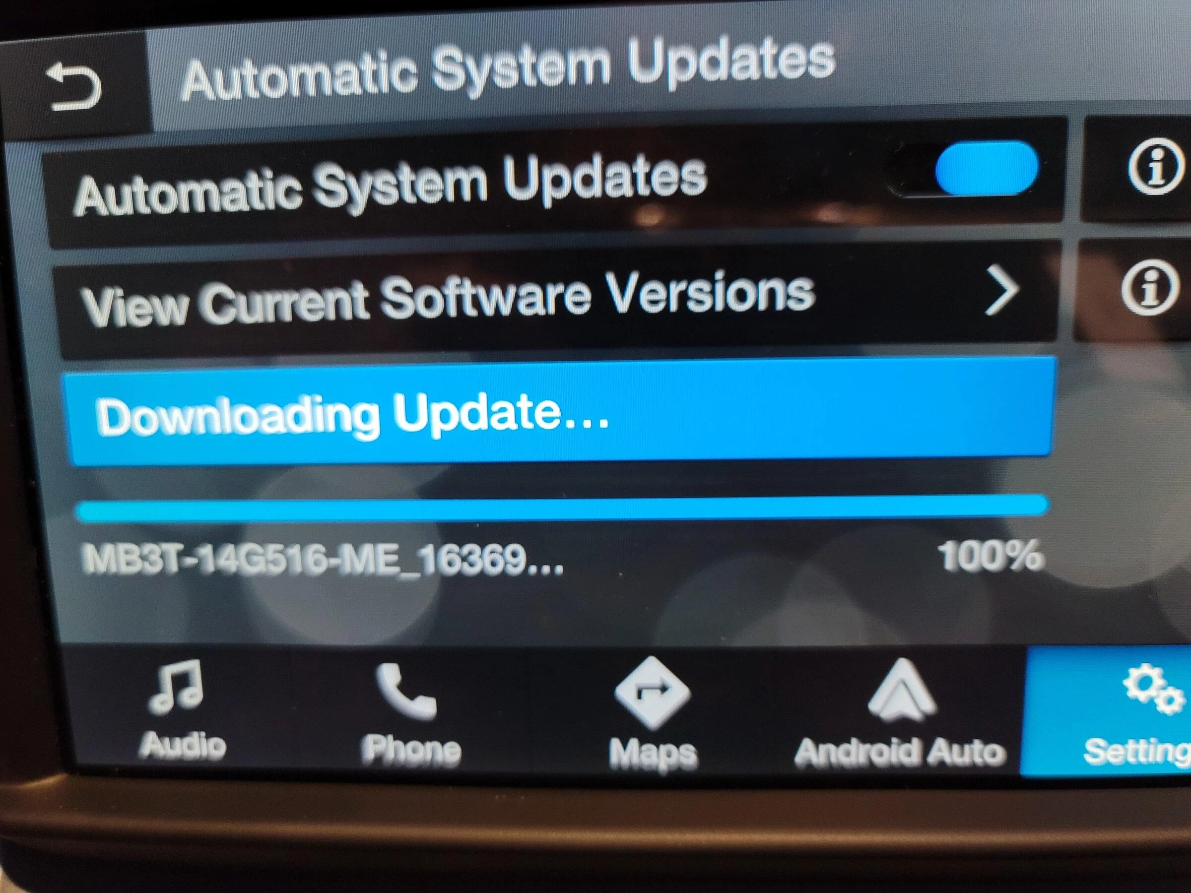

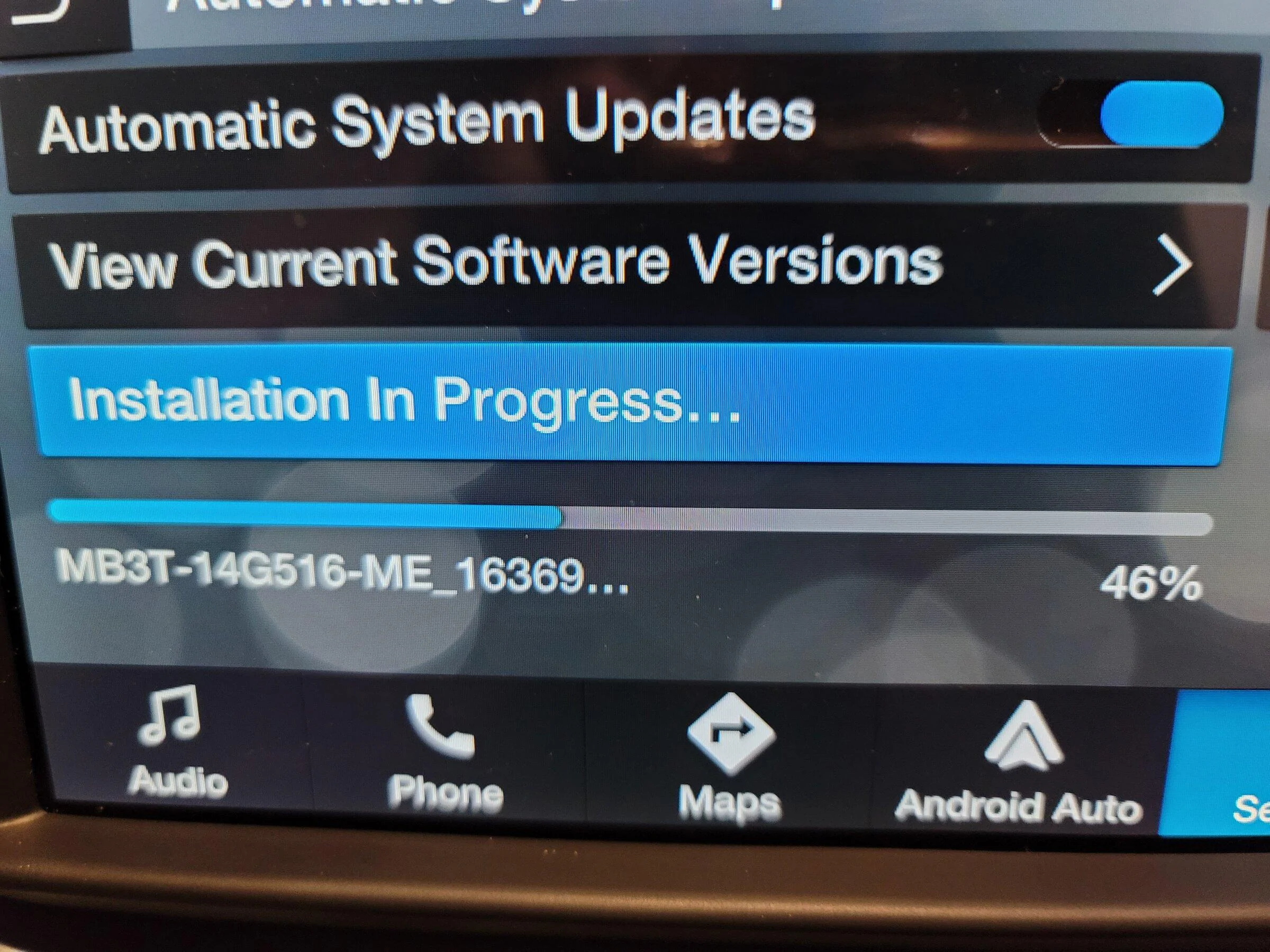

It's chugging right along...not having any issues, it's now 100% took less than 5 minutes using the Maverick wifi. Its installing now 100% complete. It didn't mess up my Wireless Android auto either, Woop!

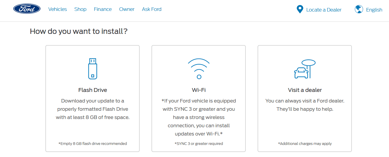

Is there no option to update with a thumb drive? My Sonata could be, using a compressed file from the MyHyundai website.
You can indeed choose to update via thumb drive for most updates (some require install using a programming head at the dealership). Check the Ford.com website for more information.
