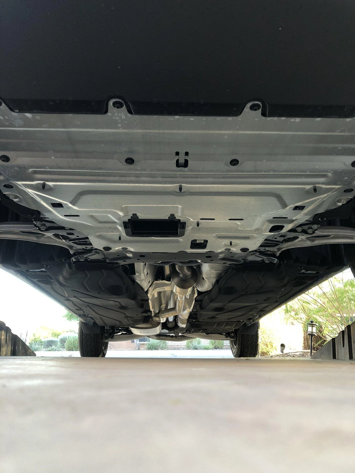

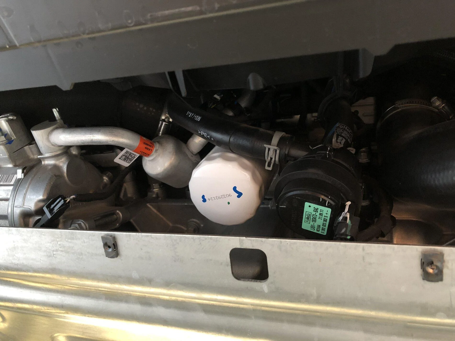

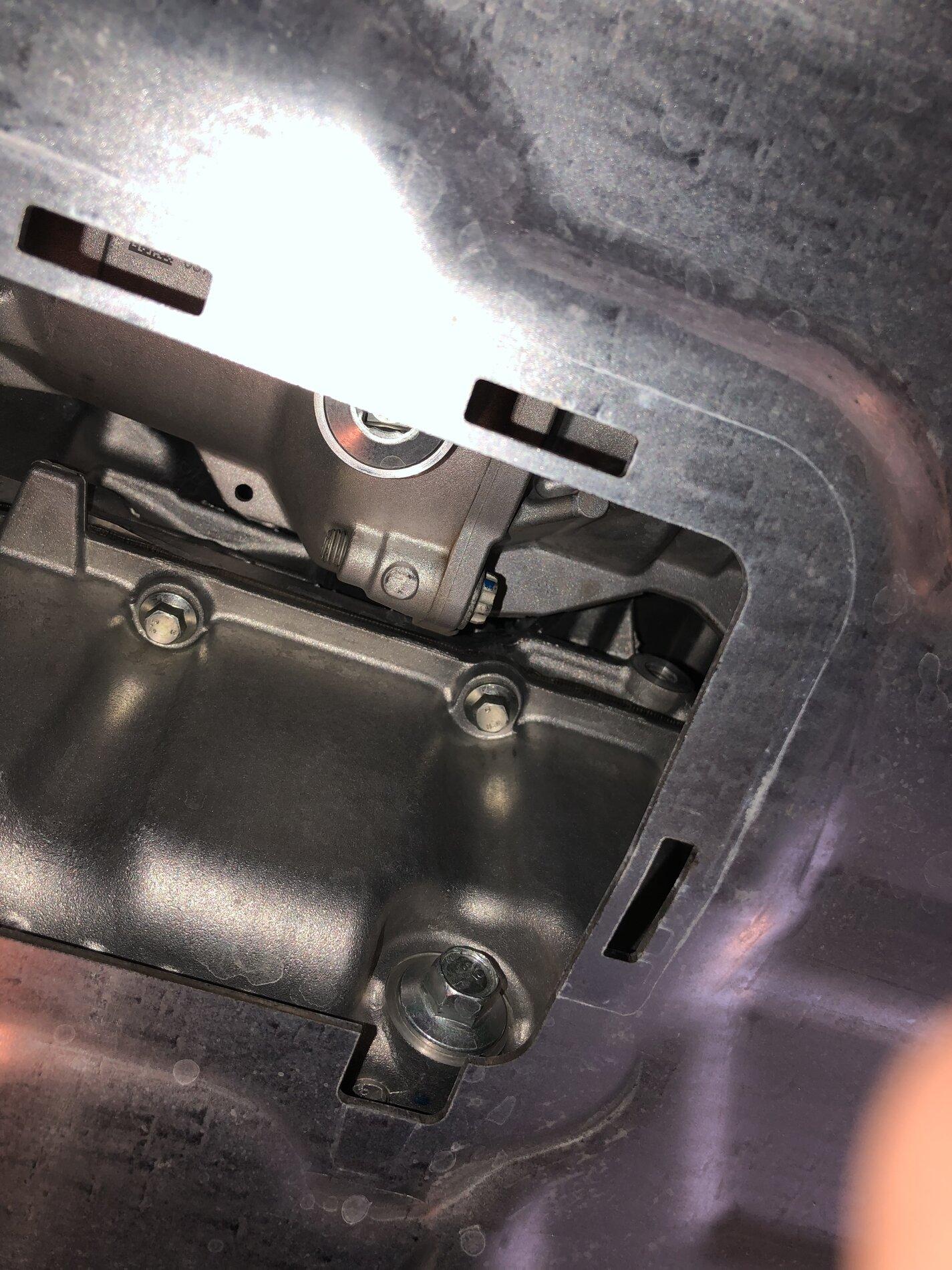

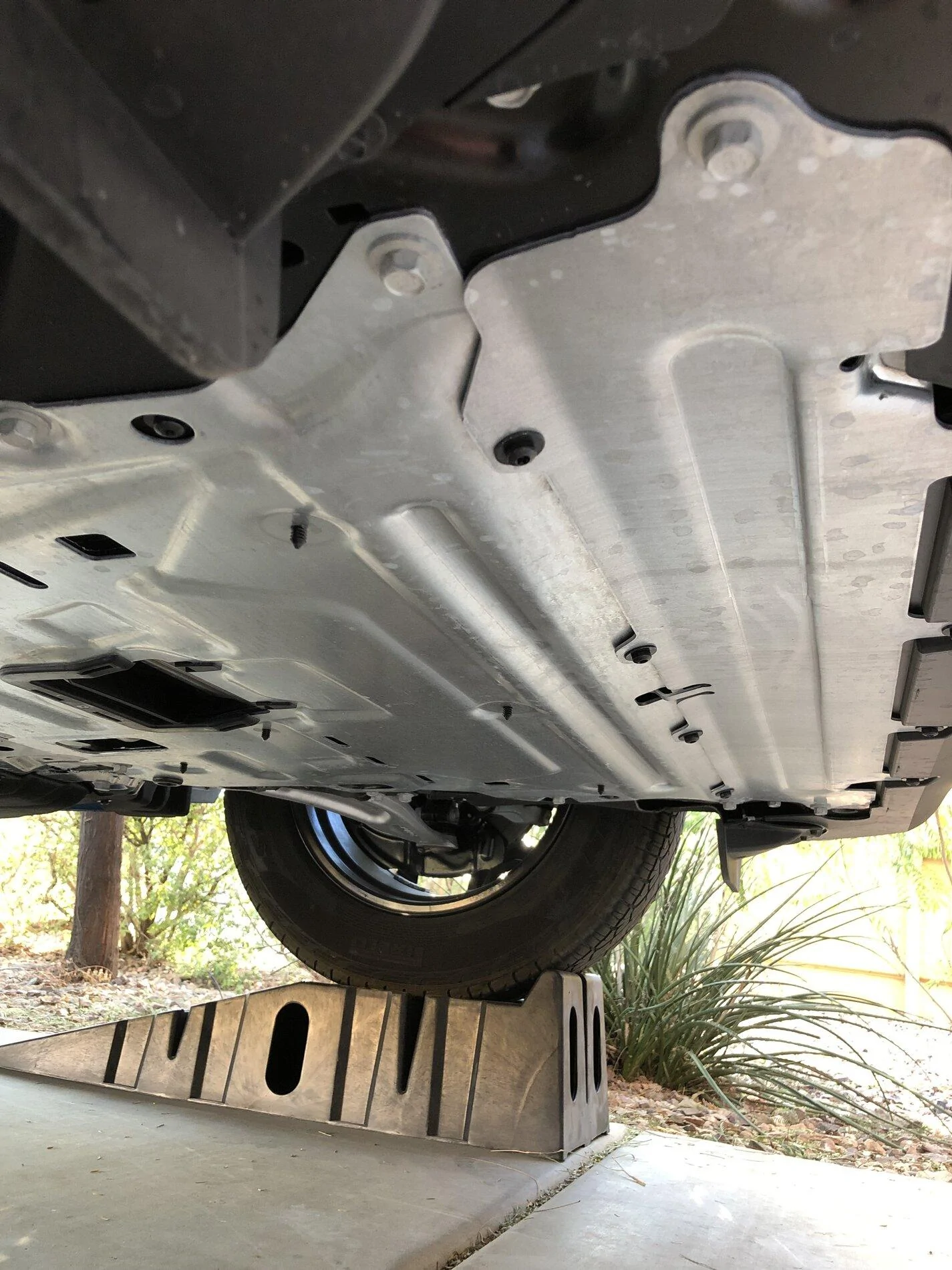

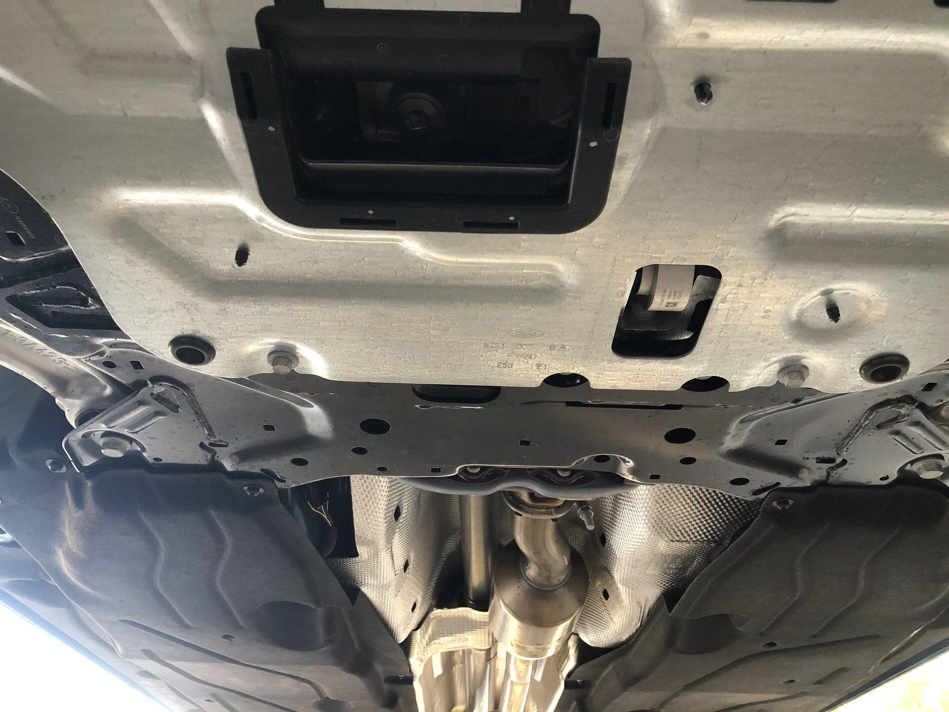

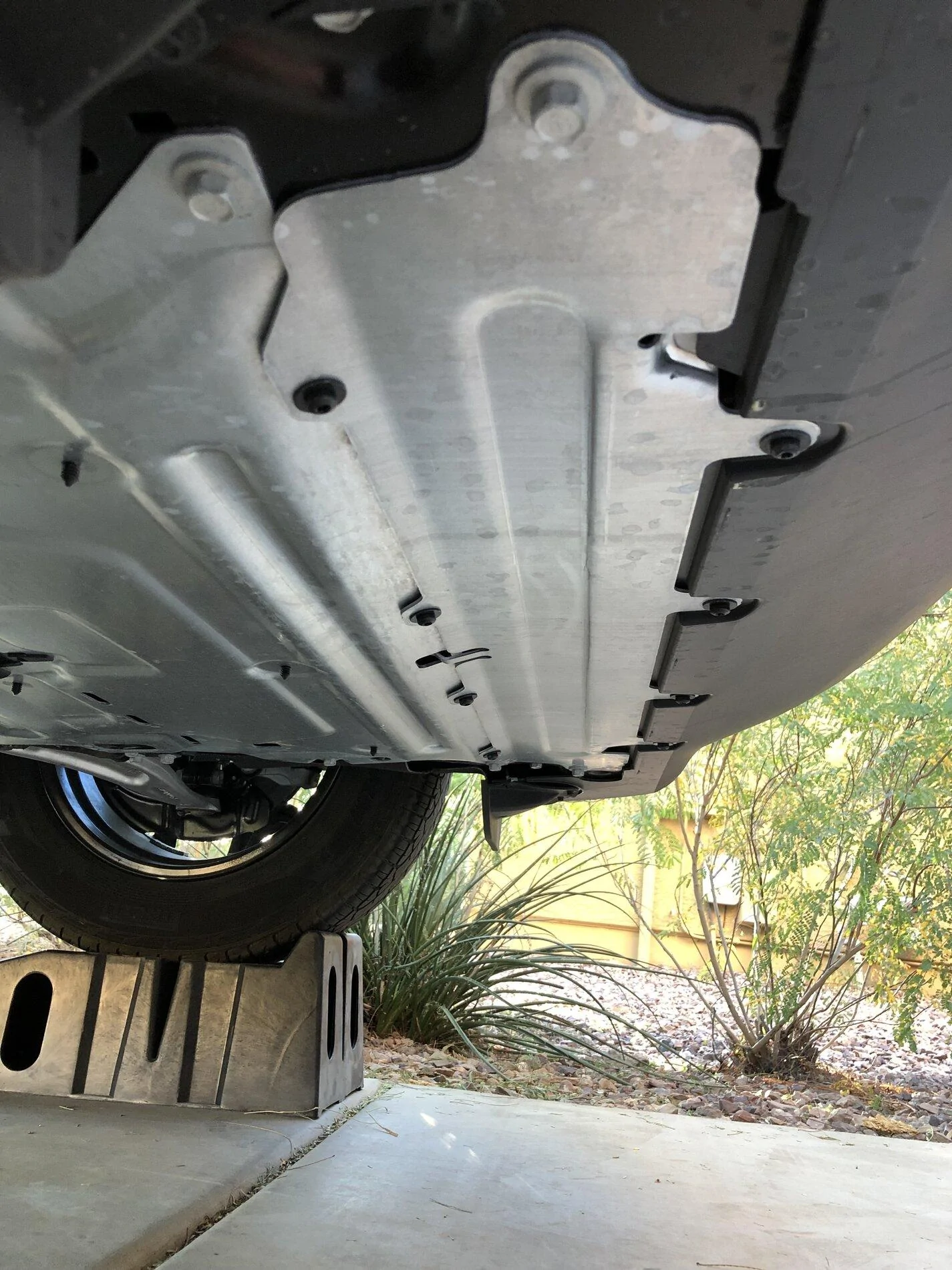

Updated with photos of skid plates that need removal for an oil change - posted by @thunaman (link to post)
Ok Gents, I have taken delivery of my FX4 Maverick today, I can confirm you will need to remove a panel that runs the full width of the truck, and about 6-8” “deep” from the bumper to the main skid plate. The rest of the skid plate is a single piece that covers the rest of the engine bay -- see photos below.
As you can see there is a large panel on the front you need to remove to get to the filter. and a small plastic air scoop (transmission cooling?) in the middle you need to remove to get to the drain plug
All in it took me about 10 min to remove, take pix and replace.

Wow! Two different drives and probably different threads too, probably intentional....but dumb!
Thanks for the foto's!

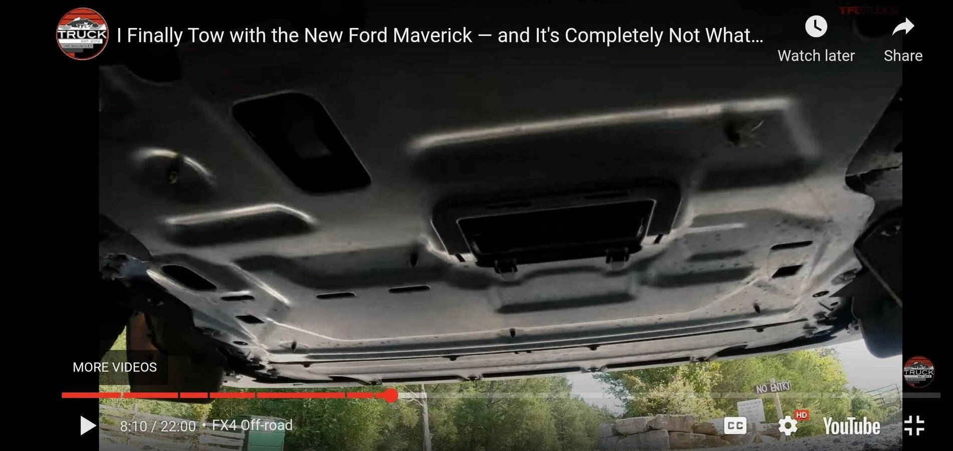

A good video has already been done for changing oil on FX4 with skid plate, pasting the link below. Others have mentioned making an access panel so you don't have to remove the skid plate. I intended to do that but the location of both oil drain plug and filter are such that it's not practical, so you'll have to remove the skid plate. It helps save time and effort to use an impact driver, altho the first time you do it you'll have to break loose the six (6) 13 mm bolts that are Loctited in from the factory (nobody knows why), with a socket wrench and possibly an extension. Here's the basic procedure:
  1. Drive onto ramps and put in park.
  2. Remove front (4) T-27 screws with impact driver.
  3. Then remove (6) 13 mm bolts (socket wrench or impact driver).
  4. Change oil as normal.
  5. When finished oil the bolts so they'll be easy next time with just an impact driver.

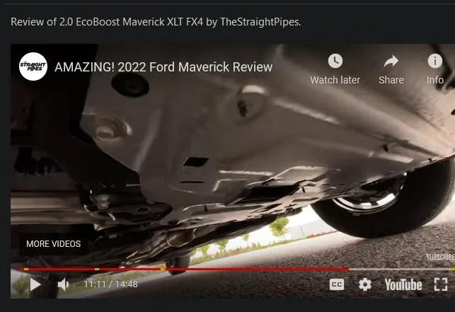

I put one of those our Outback, so far so good.
Looks great, also looks like you didnt need to cut anything. The plastic air scoop on yours does it just snap in from underneath? The one on my 4K snaps in on both sides of the fiberboard.

Completed 4th oil change on my FX4 Maverick today. Each time I’ve done it without removing the rear skid plate.
How did you do it without removing the rear skid plate?
MaverRick
Rick
Aug 5, 2022
500
684
2021 MachE 4EX 2022 Maverick Lariat FX4
I just removed the plastic air scoop to get access to the drain plug. Then I stuff some paper towels around it to stop oil from getting inside the skid plate.
