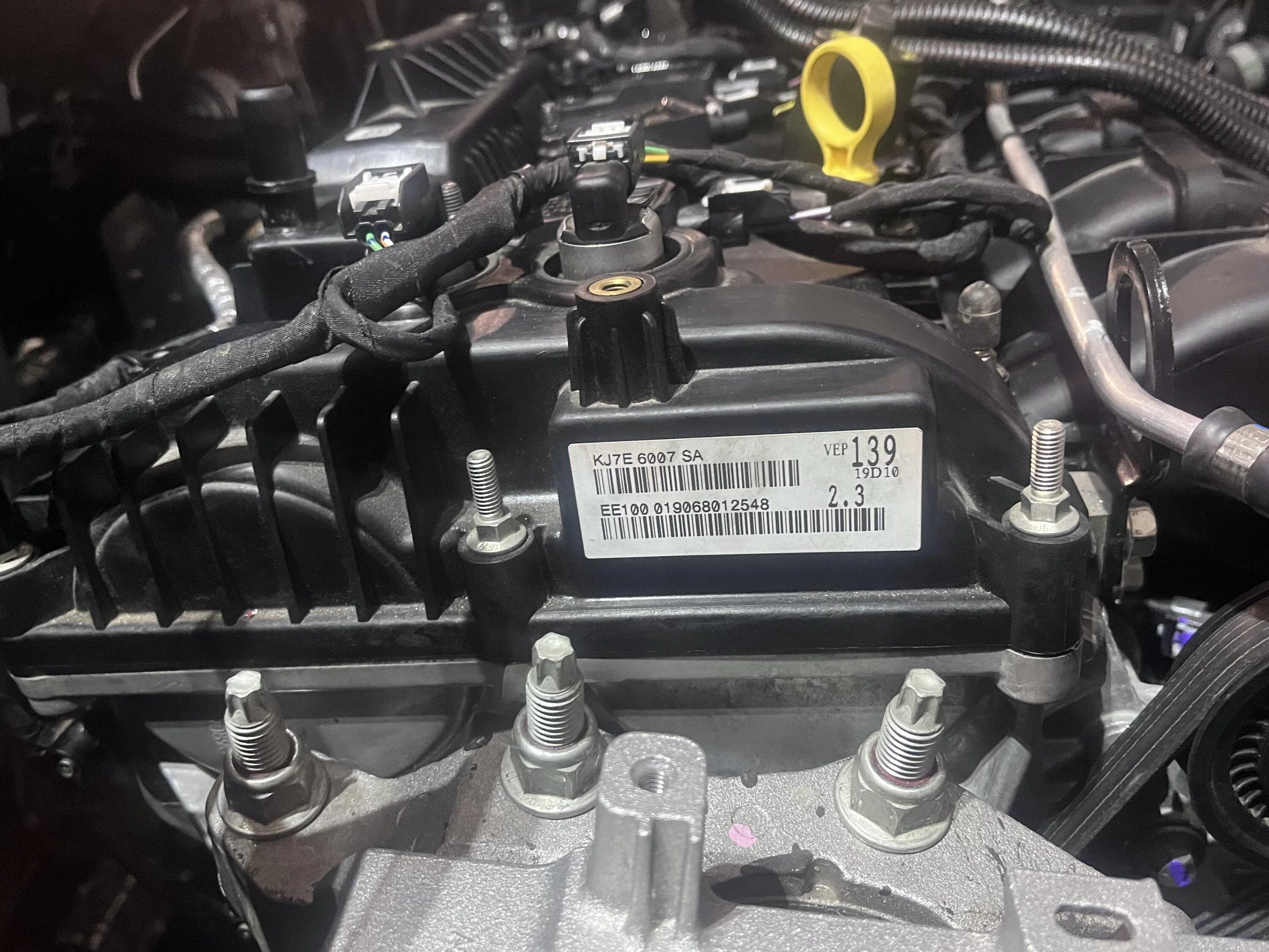

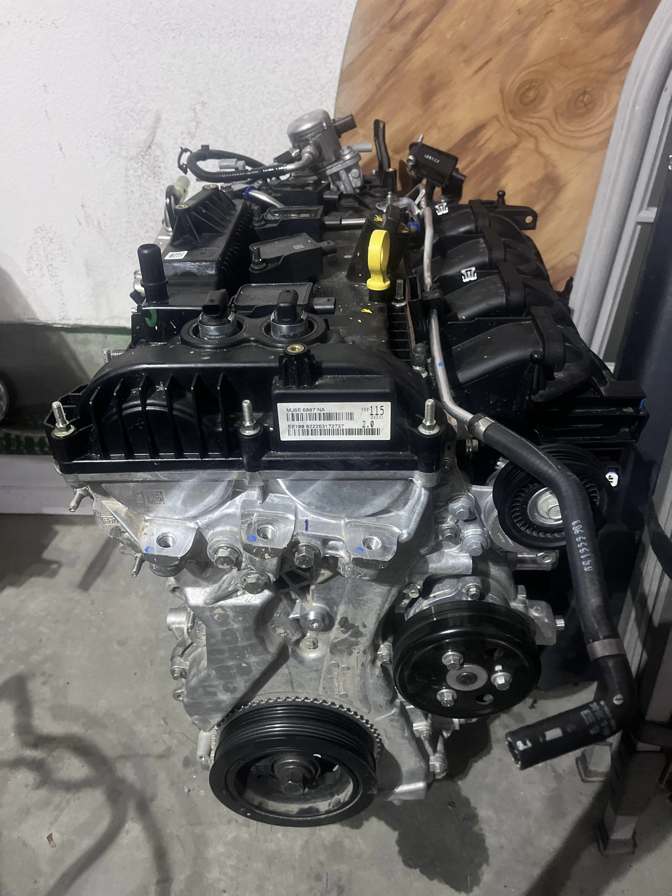

So far it’s been pretty smooth. Everything is a direct swap and the harness plugs are identical. I swapped the 2.0 harness onto the 2.3 just in case but it could probably be fine without.
The Corsair has a 2.0 with an optional 2.3 so I don’t see why they wouldn’t be compatible.
I know the trans is the weak point and I wanted to put a Corsair trans in but my trans only has 4000 miles so I’ll let it ride for now and see what happens.
Ford Maverick Project Mav 2.3 is underway DE723464-7686-4652-8D74-DFB6BF37C2A3
Ford Maverick Project Mav 2.3 is underway 5926EA15-04E5-4705-8A65-92FE6CE341F3

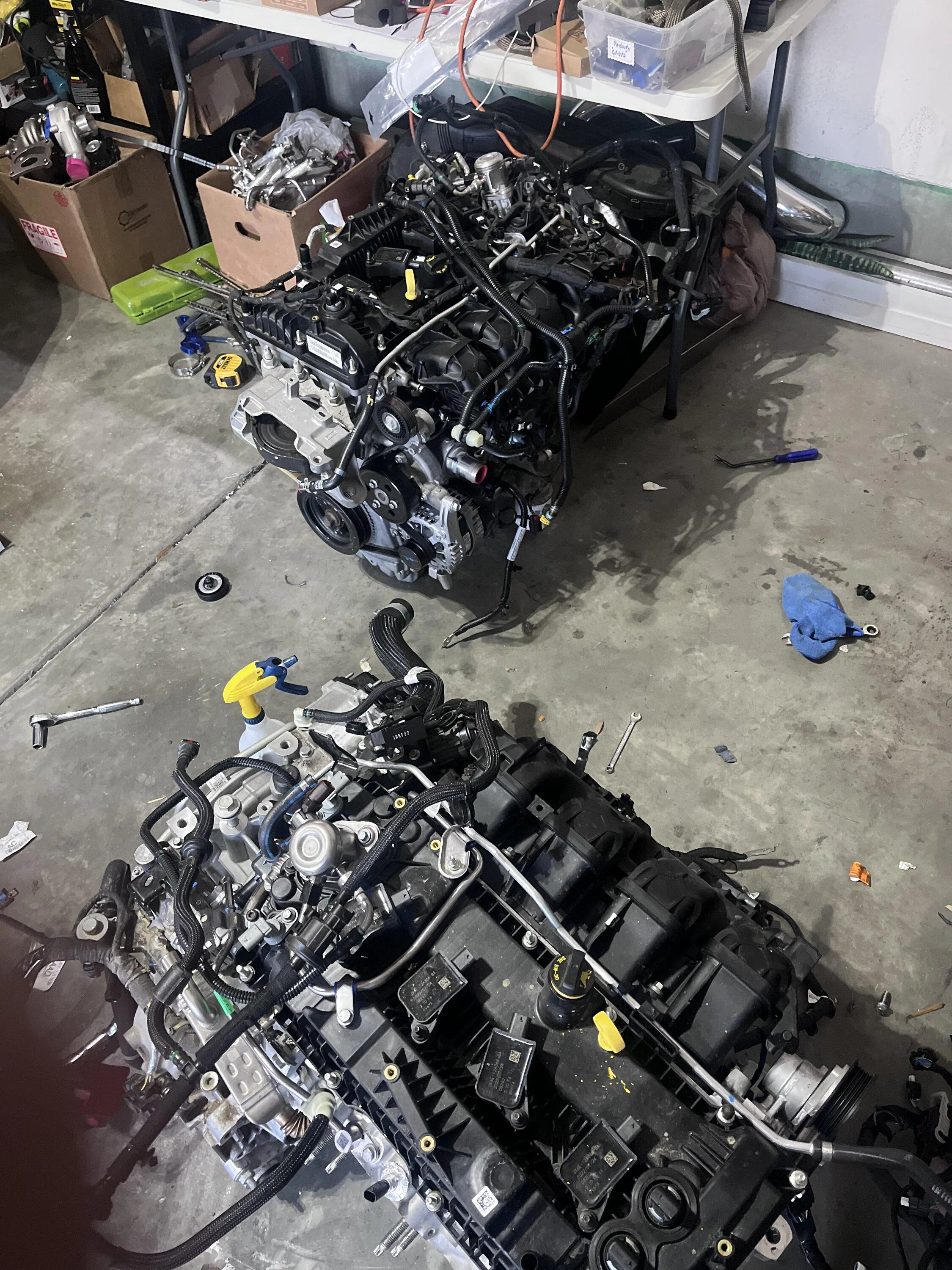

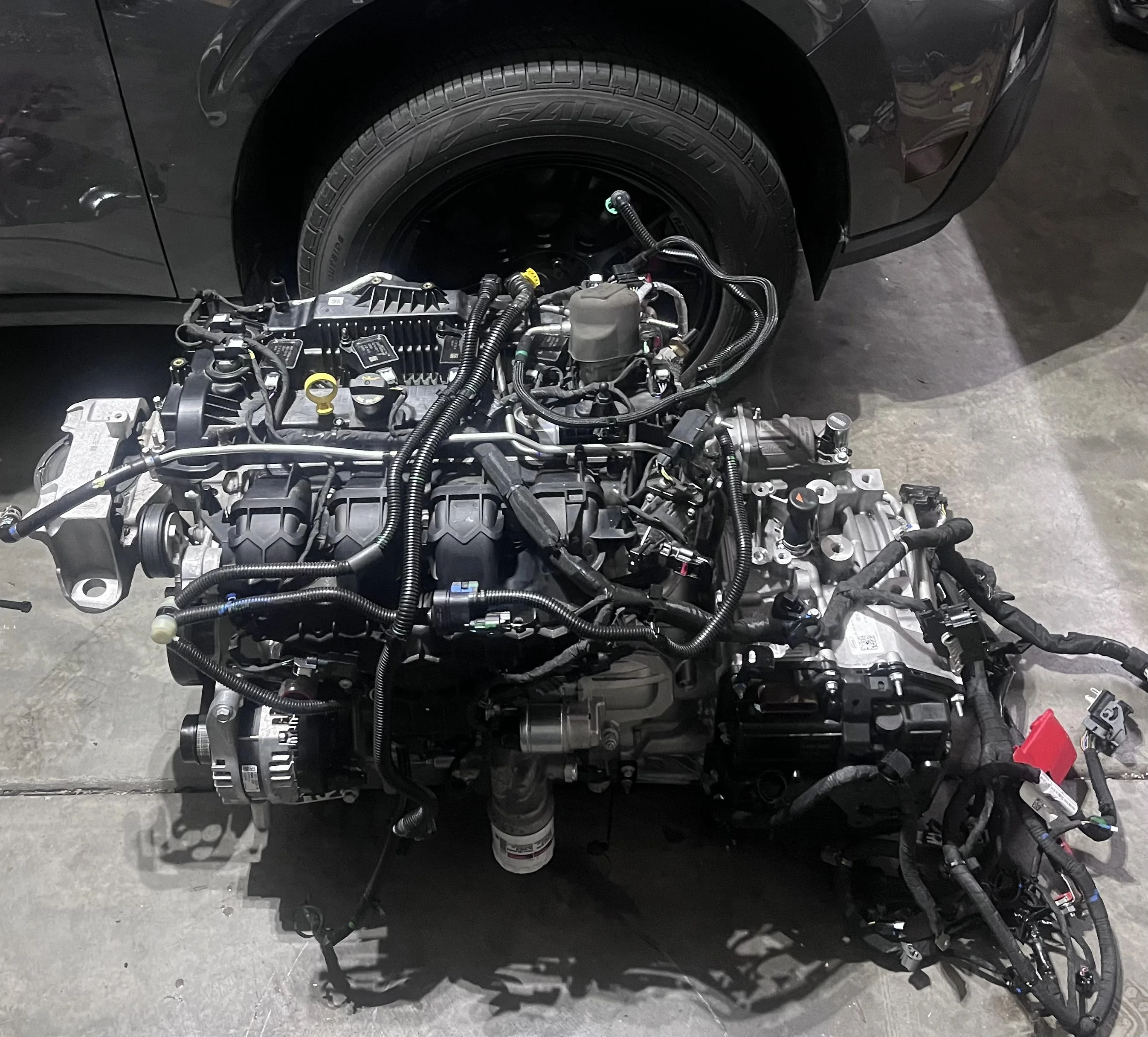

here’s the 2.3 with the 2.0 harness and hoses. Just need to swap the trans over and drop it back in.

I KNOW we’re in good hands with you! I cannot wait for the finish of the project.
It’s really verrrrrry exciting,

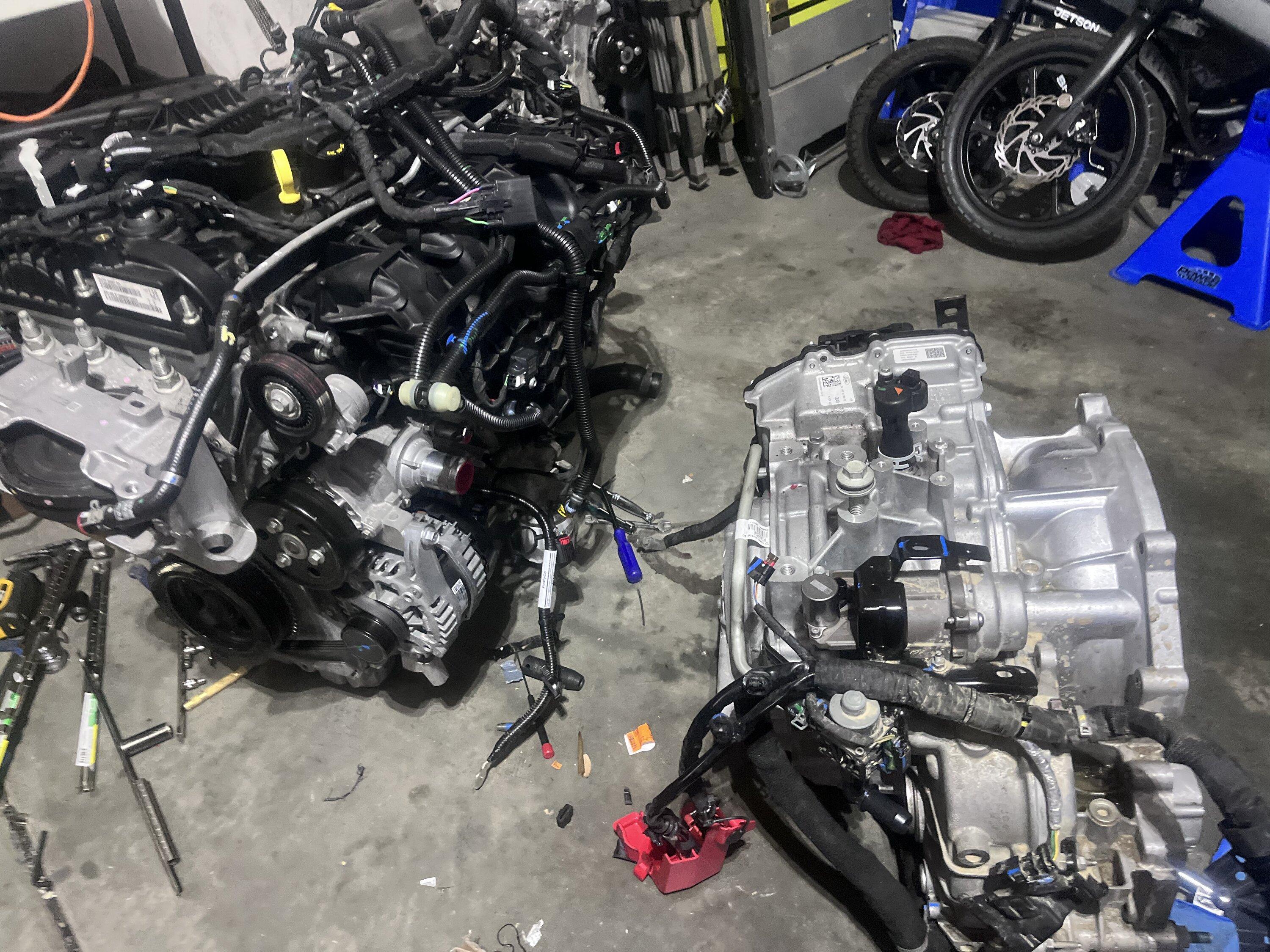

2.0 officially relieved of its duties. Will now be used for mock up of future projects.
Ford Maverick Project Mav 2.3 is underway B9E97633-03D9-460A-A783-A9EA451FBC9B

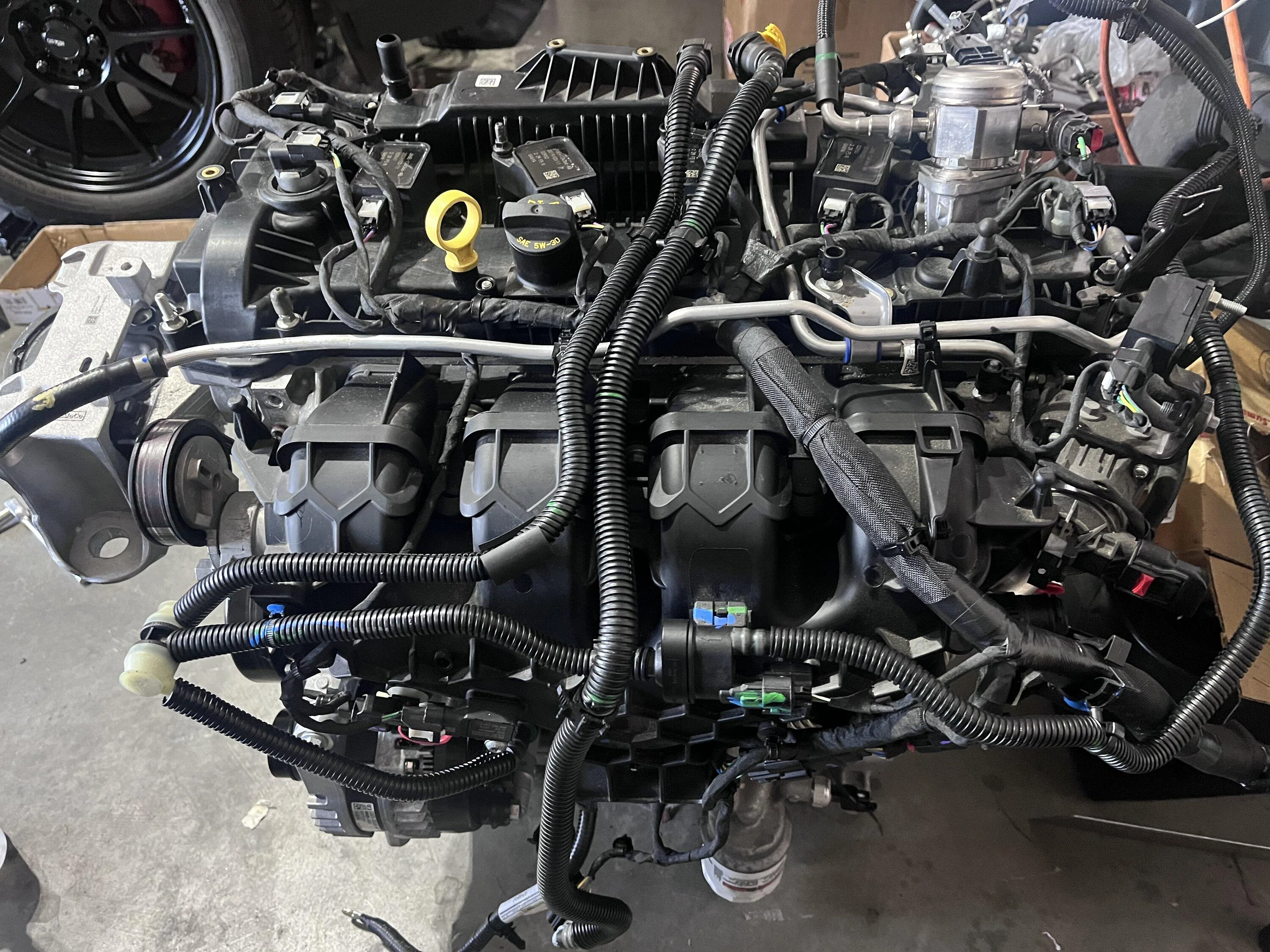

Fully dressed 2.3 ready to destroy this 2.0 trans. 🙈

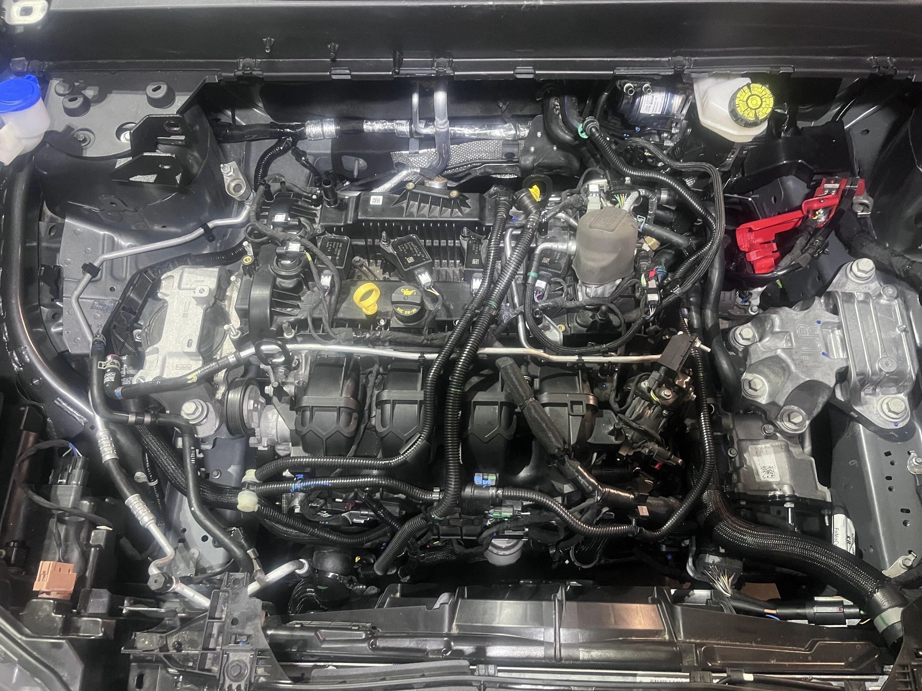

She’s ready to go back in! Should have her running by the weekend hopefully.

What a cool powerful tiny package! Looking forward to seeing all of your bits get added on!
