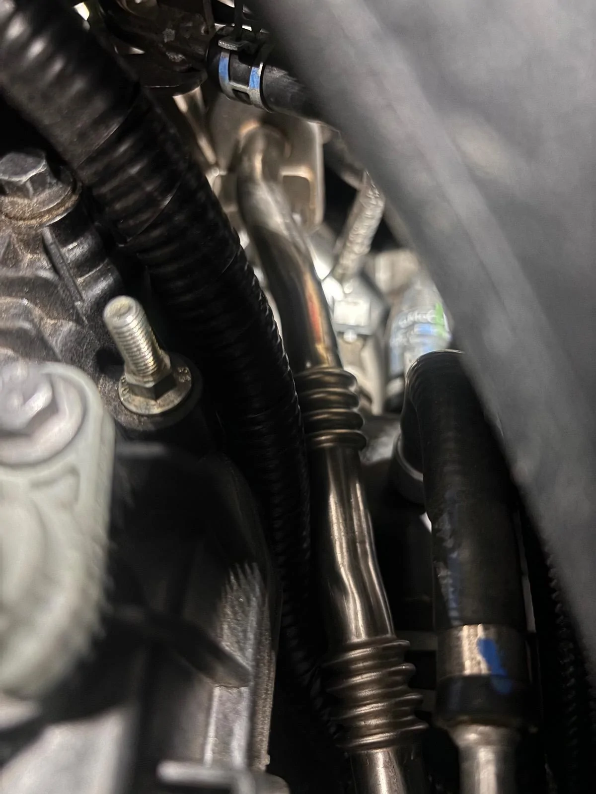

Yes the 2.0 block is better than the 2.3 and there are many ways to make power but the easiest and fastest way is with a 2.3 Corsair engine. You are starting with 45 hp and 33 tq off the bat without touching anything assuming you score the 46mm 2.3 turbo as well.
A tune alone adds appx 20% more power to the 2.0. So let’s use ricer math and assume the same for the 2.3 and add a tune, intake, intercooler, downpipe, and catback. The 4 people I know who have purchased a 2.3 bought a 57mm turbo as well. It would be a waste to go through all that and keep the stock turbo.
Add all that up and you have a Maverick that’s out of fuel at give or take 375 wheel. The Ranger guys with the same turbo and fuel upgrades are well over 400 to the tires but they also have a stronger transmission.
The swap was actually done over the weekend and only took long to get running because I was having a downpipe for the Ranger turbo made among other things. I used the 2.0 harness and only swapped over the line pictured below because of the plug location. The other issue was the turbo not making boost which turned out being that connector 1 and 2 on the waste gate is opposite on the Ranger. A simple wire switch took care of that.
If you can find a Corsair 2.3 for a decent price I say go for it. I did it by myself with no instructions or anyone to ask for advice. Not that it’s needed but if anyone doing it has any questions I’m happy to help.

You have pics of the pin 1 and 2 location on the ranger turbo to swap?
