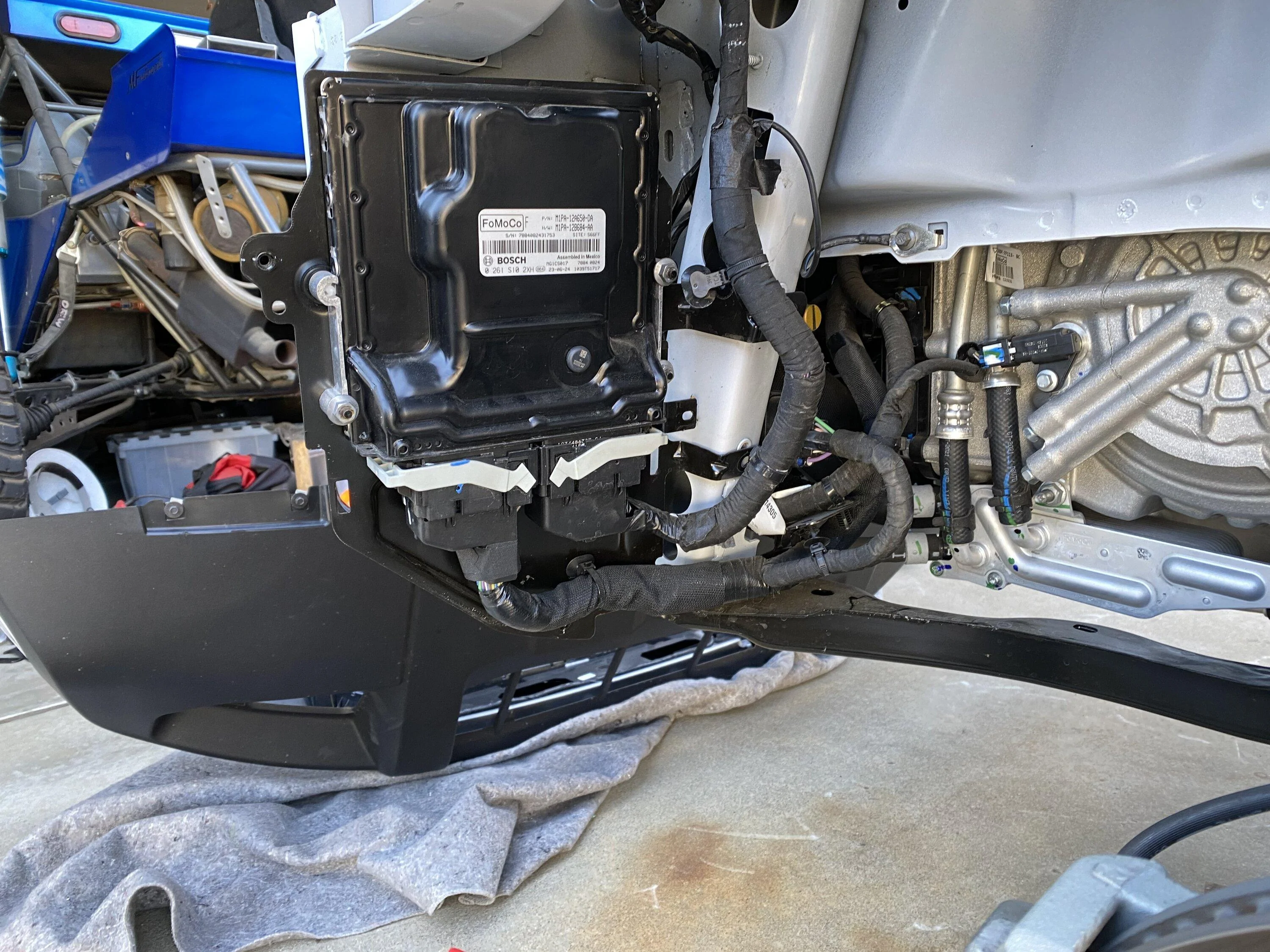

working on ecm relocate , just bad location from ford .
any puddles or mud over 10” at the bottom of the front wheel well will surround the plugs and ecm. The ecm is press sealed with a gortex style one way evap valve ,buuuuuuuuutttt. Not trusting any of that for large puddles!

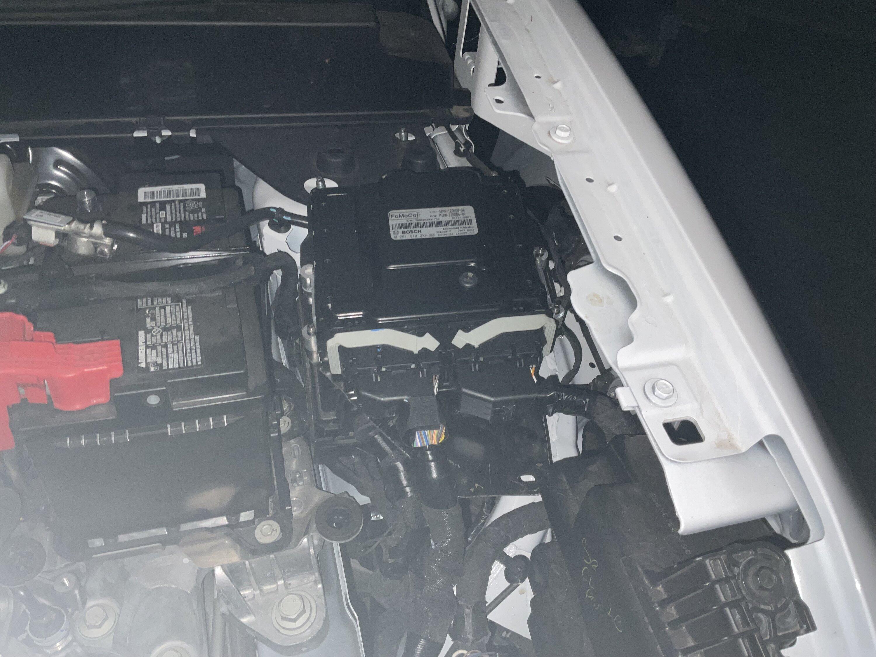

Going up top , look like everything reaches , just have to make brackets

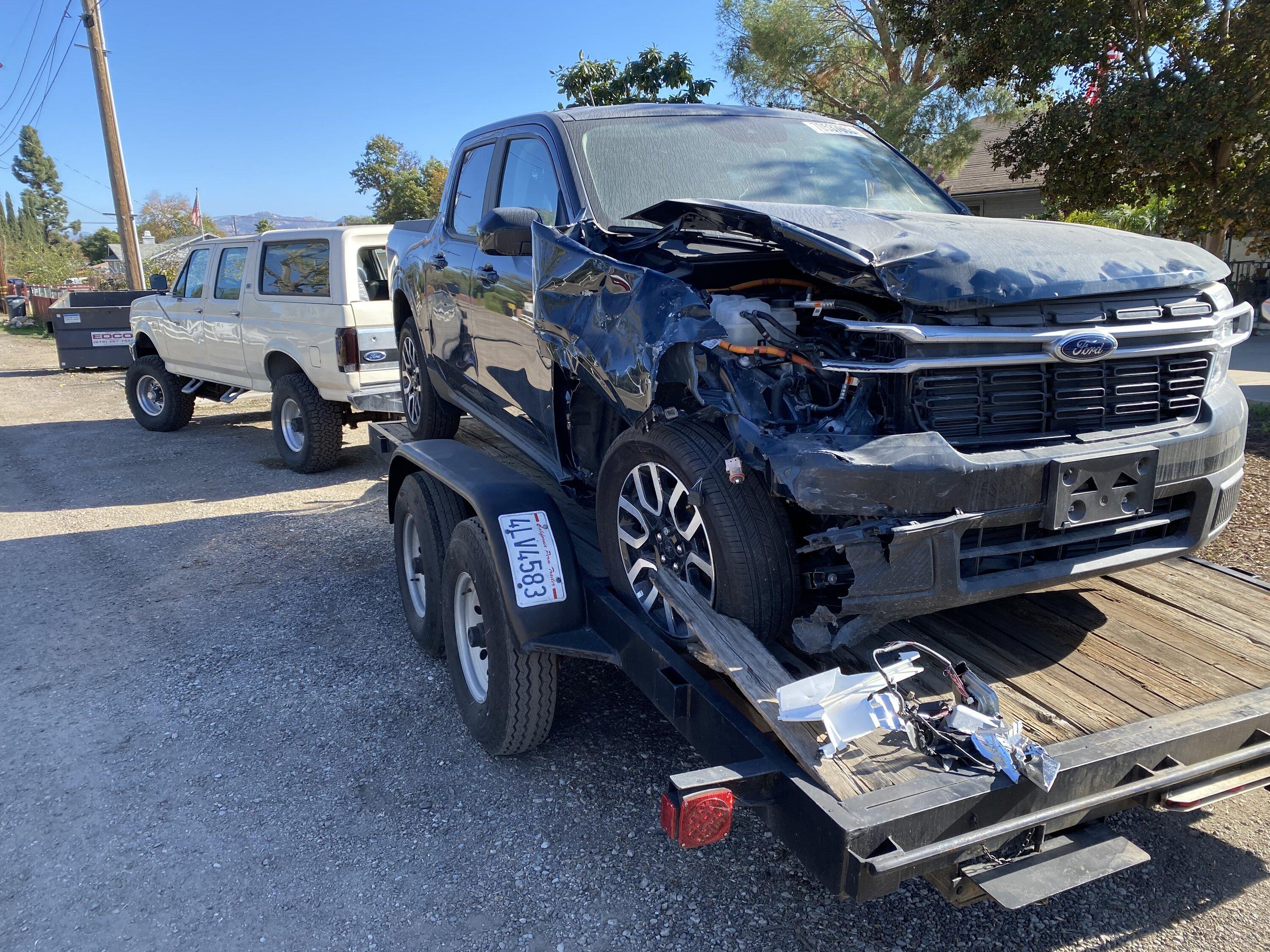

Only problem ,have to start on this 23’ hybrid lariat just got for 9900
