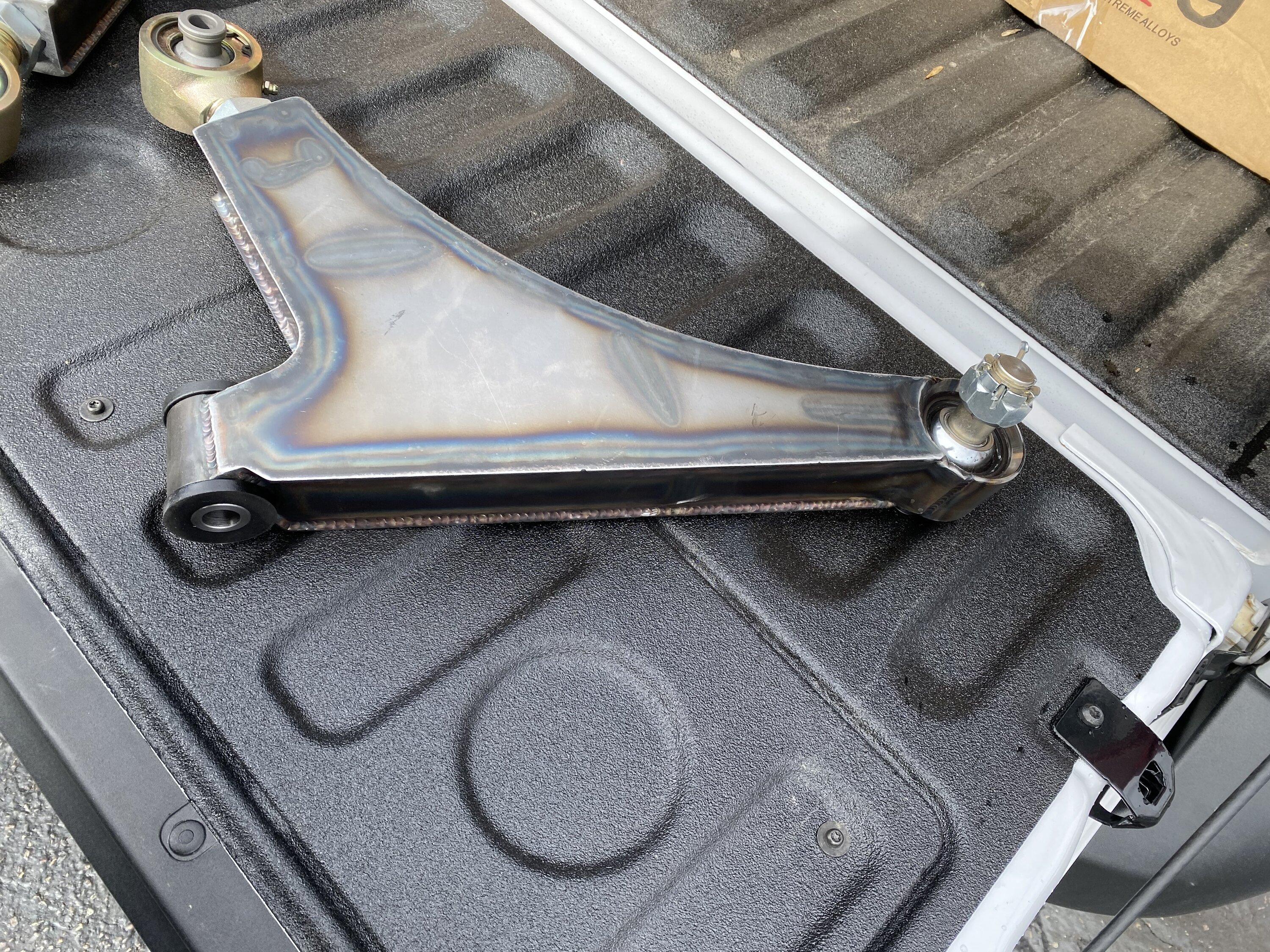

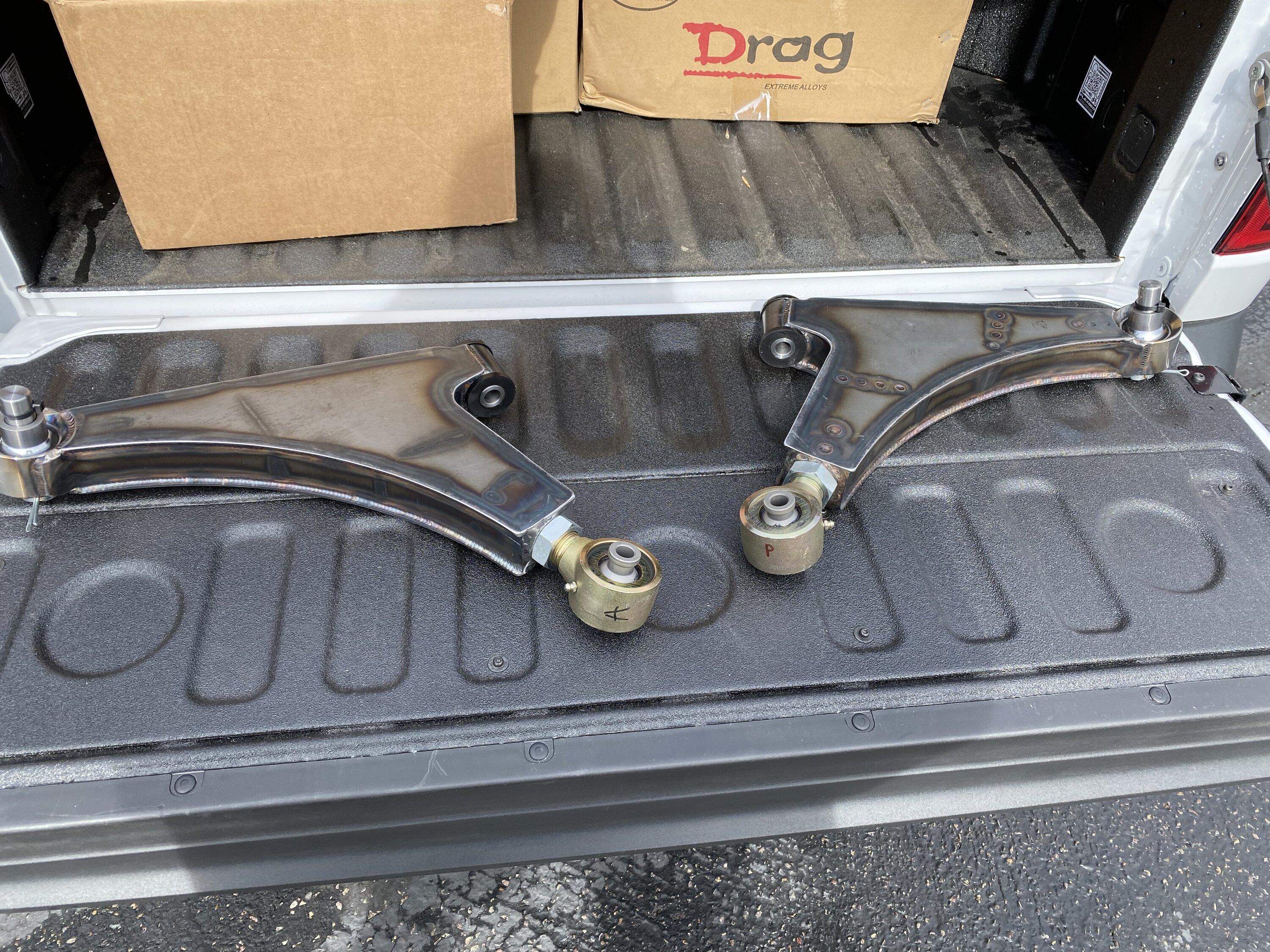

Ford Maverick New A-arms for the Maverick prerunner build IMG_0304
Ford Maverick New A-arms for the Maverick prerunner build IMG_0306
Ford Maverick New A-arms for the Maverick prerunner build IMG_0307
Ford Maverick New A-arms for the Maverick prerunner build IMG_2579
coming soon ! Pre mods in tahoe.
Everyday someone creates something new , makes a new product or a discovery to make something better , society advances as a whole .I can’t sit back and wait
for things to get better ,worrying about doom and gloom , I want to be part of the solution , the advancement , and have fun!
Soooo back to work !
out to the driveway!

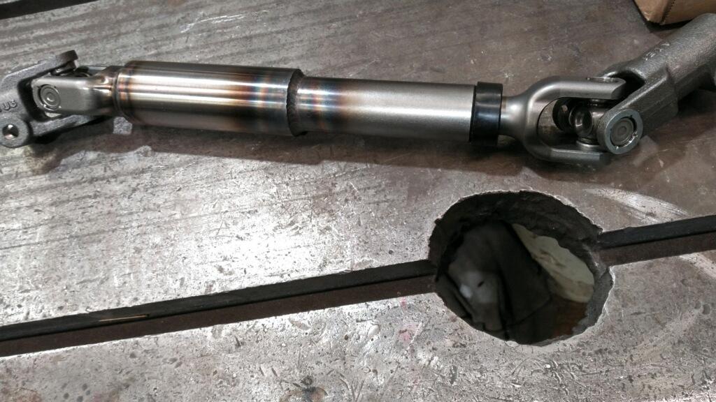

Wait one more quick one
yes , plan is to redo factory crossmember , have a new tremor one coming in $760 from ford , should be here this week , going to do a chromoly tube version with a 3-31/2“ drop built in with new rack mount to keep bump Steer in check ,
the factory k member ( old 5.0 racing days ) or x Member will strengthen the mounting points as th factory sheet metal for a arm bolts distorts and opens and Tears too easy . Should shove 2 things one item . Will fixture that up and do it hopefully next month .
oh here is steering shaft
Ford Maverick New A-arms for the Maverick prerunner build imagejpeg_0
I will be doing additional 2 1/2” longer arms ,maybe 3” with axles , hopefully soon .
did these arms stock length with original 11 degrees built in to uniball , that’s factory ball joint angle. Will see what truck cycles like and what can be improved with cross member mounts to keep axle angles minimal .Main goal is to maximize original package with no cycle resistance so spring rate and dampener has no outside influence , to totally tune and control the corner .

I keep trying to tell people how ridiculously heavy duty my Comanche is for its size and design. 2200 payload 5000 towing. I've done way more of both. Regularly. All just bits of spot welded sheet metal.

I hear you about that aviation thing. That's the industry I work in. Structural repair. Parts are expensive as heck. Aircraft are expensive flying liabilities as I call them. Everything you install on one has to have certification. That piece of paper drives the costs waaaay up.
This is why I like the car hobby, and especially the modifications I am making to the 69 barracuda I am rebuilding. No NTSB telling me I have to do this or that a certain way. I'm no dummy either. I understand stress and strain. I have designed plenty of repairs for aircraft, submitted to the manufacturers and gotten the go ahead to repair that way. The modifications made to that car are within those parameters.
The A arms you made look fantastic. Arguably much better than the aluminum pieces they will replace. Plus the greasable ball joint is a bonus !!! I'd buy a set like that just for street use.

Looking forward to more pics and follow up. Not all of us have your expertise or resources (plasma torch). Maybe a YouTube video?
Keep pushin' the envelope! We're here 😉.
