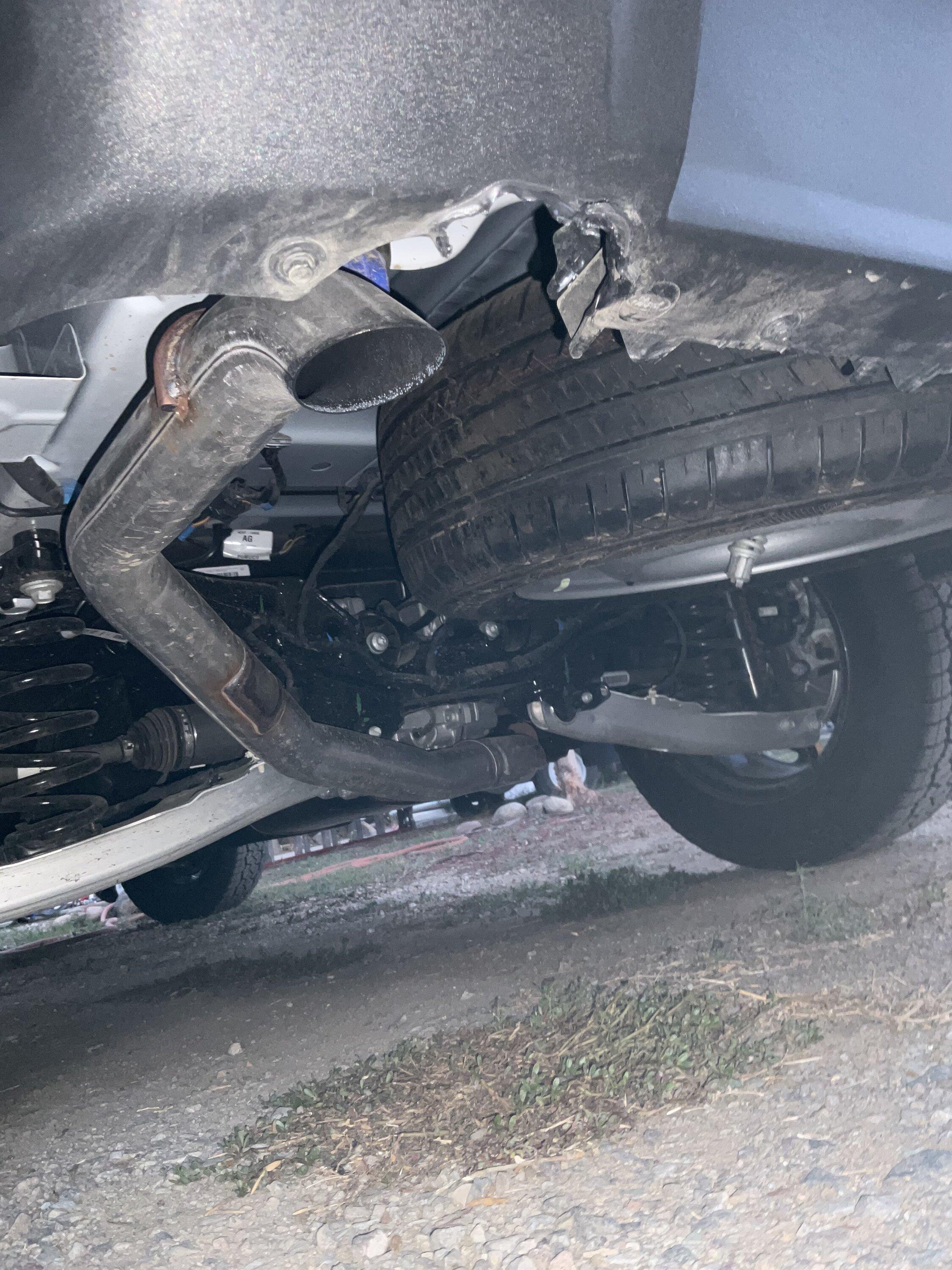

I will be posting as often as I can on this pre runner style build of my 23’ tremor . First I did a gr40 suspension kit from flat out suspensions.
Then I mounted up some 255/75/17 BFGoodrich mud terrains ( 32x10”)
Now the whole unit sits about 2 1/4 “taller at the wheel arch. Only 1 1/2” in rear.
going to order longer springs too to play more with height . Didn’t get the 3 1/2” I was looking for.
stance is not quite right. May go 11/2” wheel spacer until I can make some A arms.
next up is cutting the bumpers up and doing some tube bumpers with skid plates.
but first is relocating elm from lower federwell( worst ford placement ever )
And rim and weld pinch weld
it’s dark now so will do finish work tomorrow.
the best thing about the suspension kit is the rear went from 2 1/2 “ of suspension droop to 5”
will have to re cycle the front after I get new springs made .
biggest issue all around is the lower arm resistance on the front .I may go for a custom lower arm with a uniball or other joint layed sideways . The swaybar is also adding a large amount of compounded spring rate ,even with one side disconnected.( looking at modding apex disconnects or making my own)
i do have a set of stock tremor tires with 2000 miles for sale soon and the stock tremor shocks,springs and struts too.
in the east San Diego area.
This truck is for light playing in the anza Borrego desert area. I have a property at ocotillo wells ,across from the airport there by the off road park.
I do know it will never keep up with the serious desert machines but is also a good daily versus my buggy or full size broncos .
But we will see what the limits really are!
