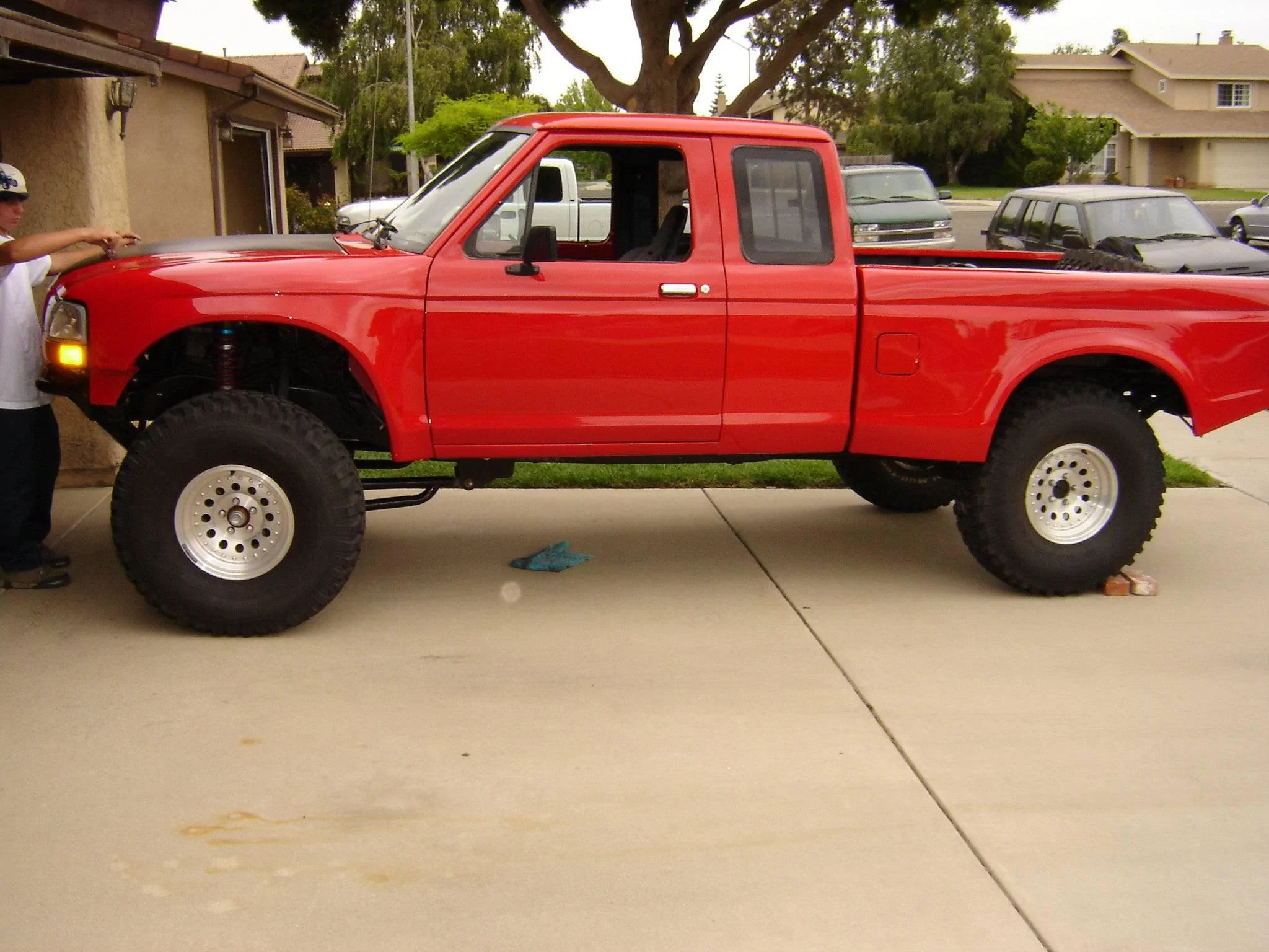

This is what I’m thinking.
Ford Maverick Prerunner style Maverick Tremor build w/ 33's IMG_0229
approx 3-4” bulge

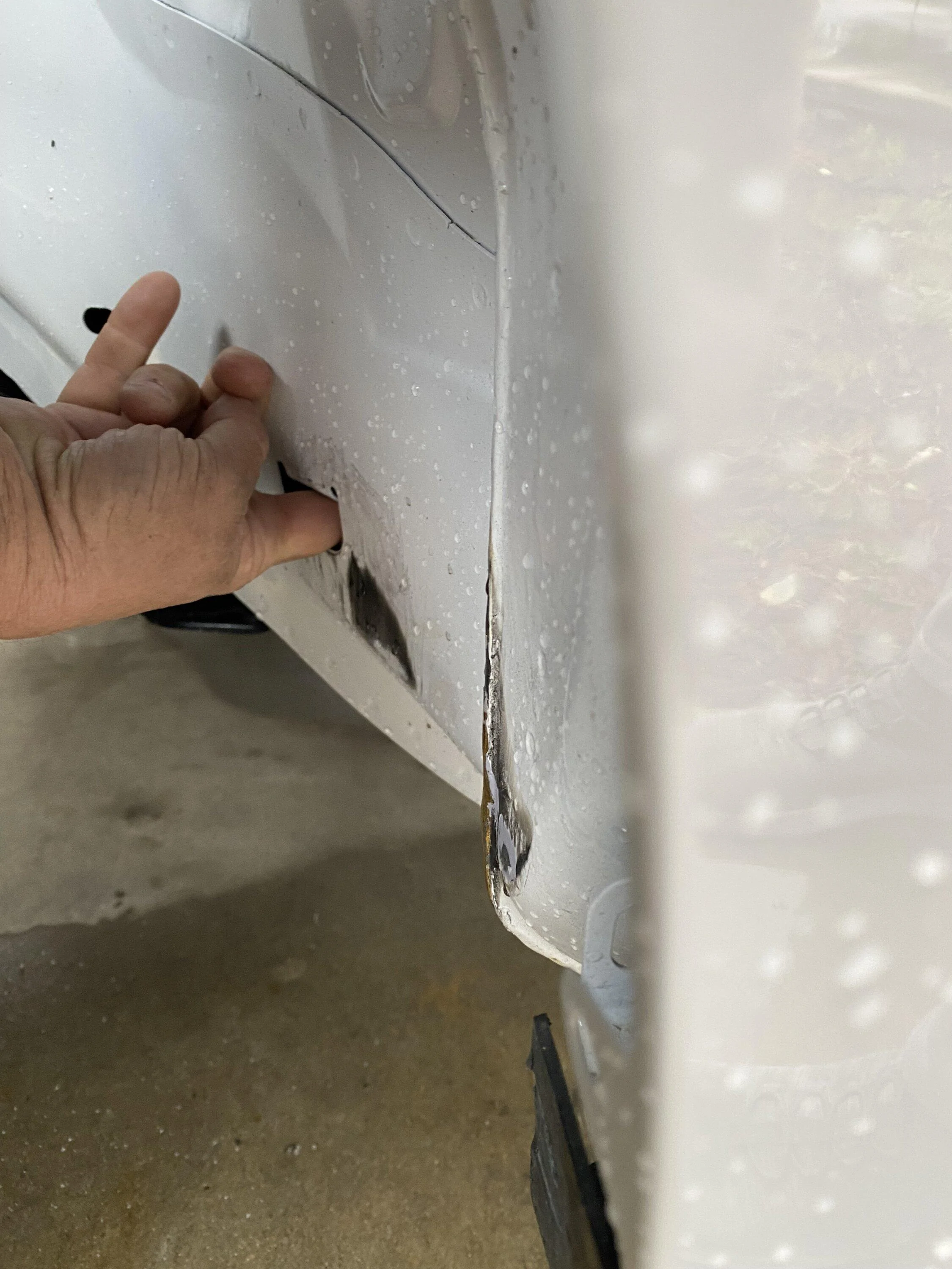

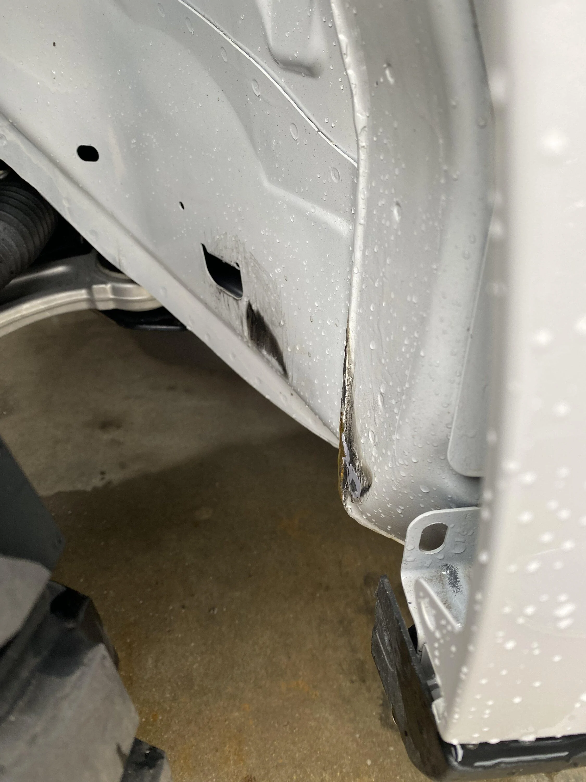

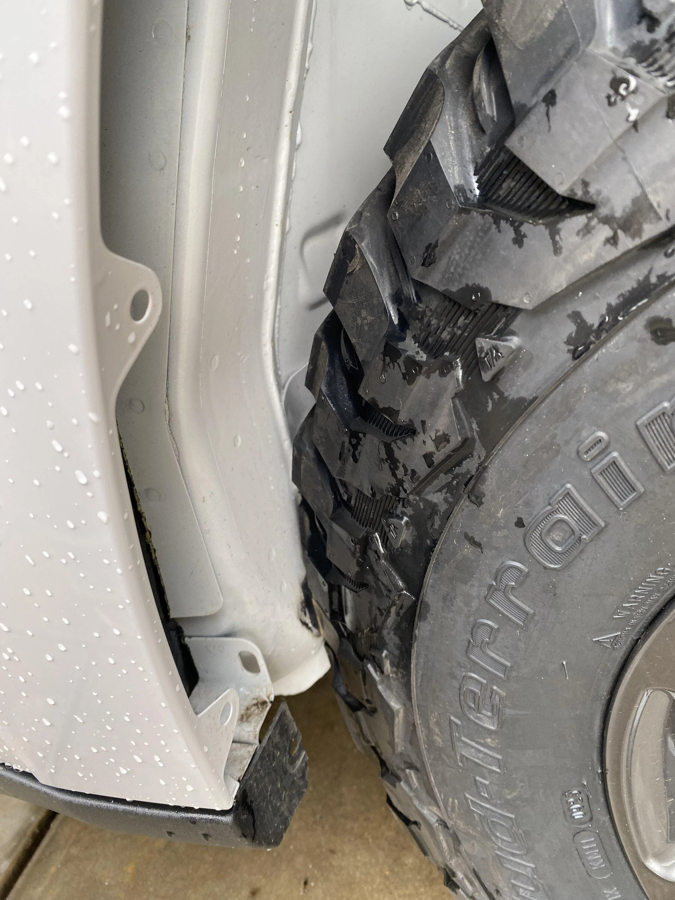

all This is a work in progress.will be needing additional clearance for a 33” .
the 32” rubs a little inboard of seem at big curve of the filler material right above rack area. Put 1 1/4” spacers on and the 32 “ rub on the outside sheet metal that I trimmed .
am going to look at making some plates to box in whole area of hollowness at bottom of footwell . Actually has a dead area with a vent hole here
Ford Maverick Prerunner style Maverick Tremor build w/ 33's IMG_2874
inside rub here
Ford Maverick Prerunner style Maverick Tremor build w/ 33's IMG_2873
Outside rub with 1 1/4” spacers

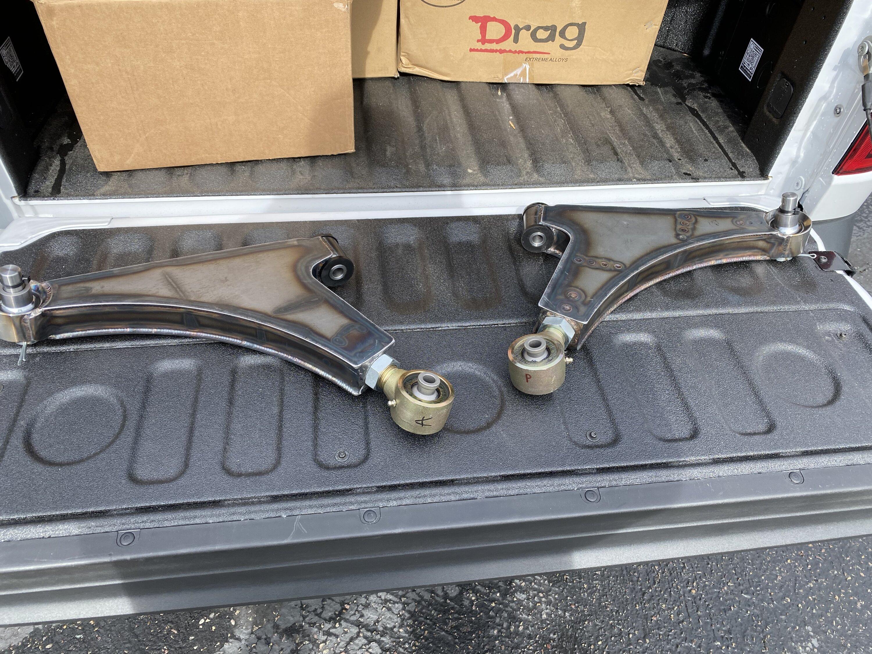

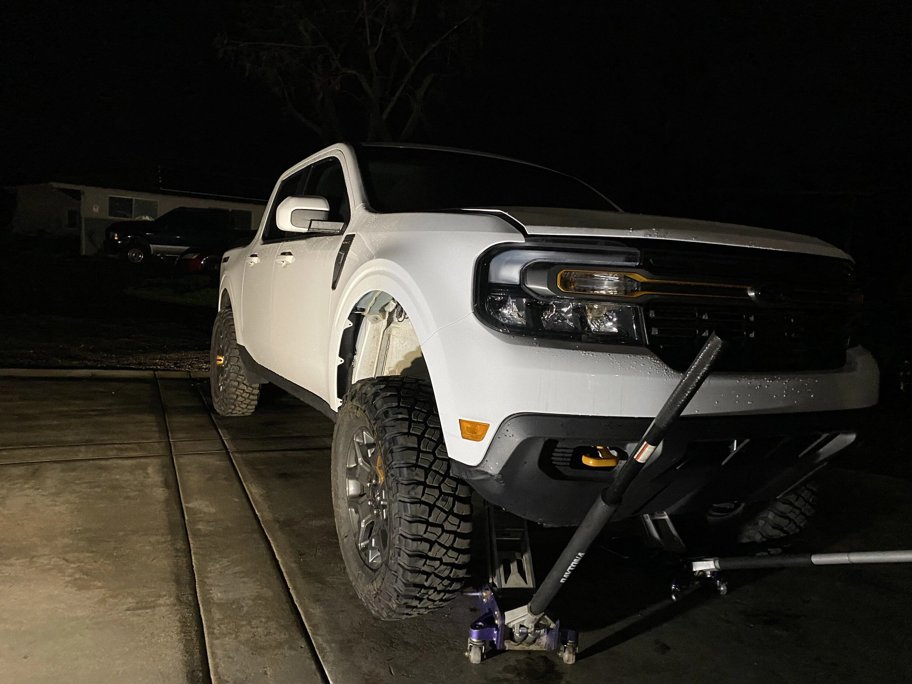

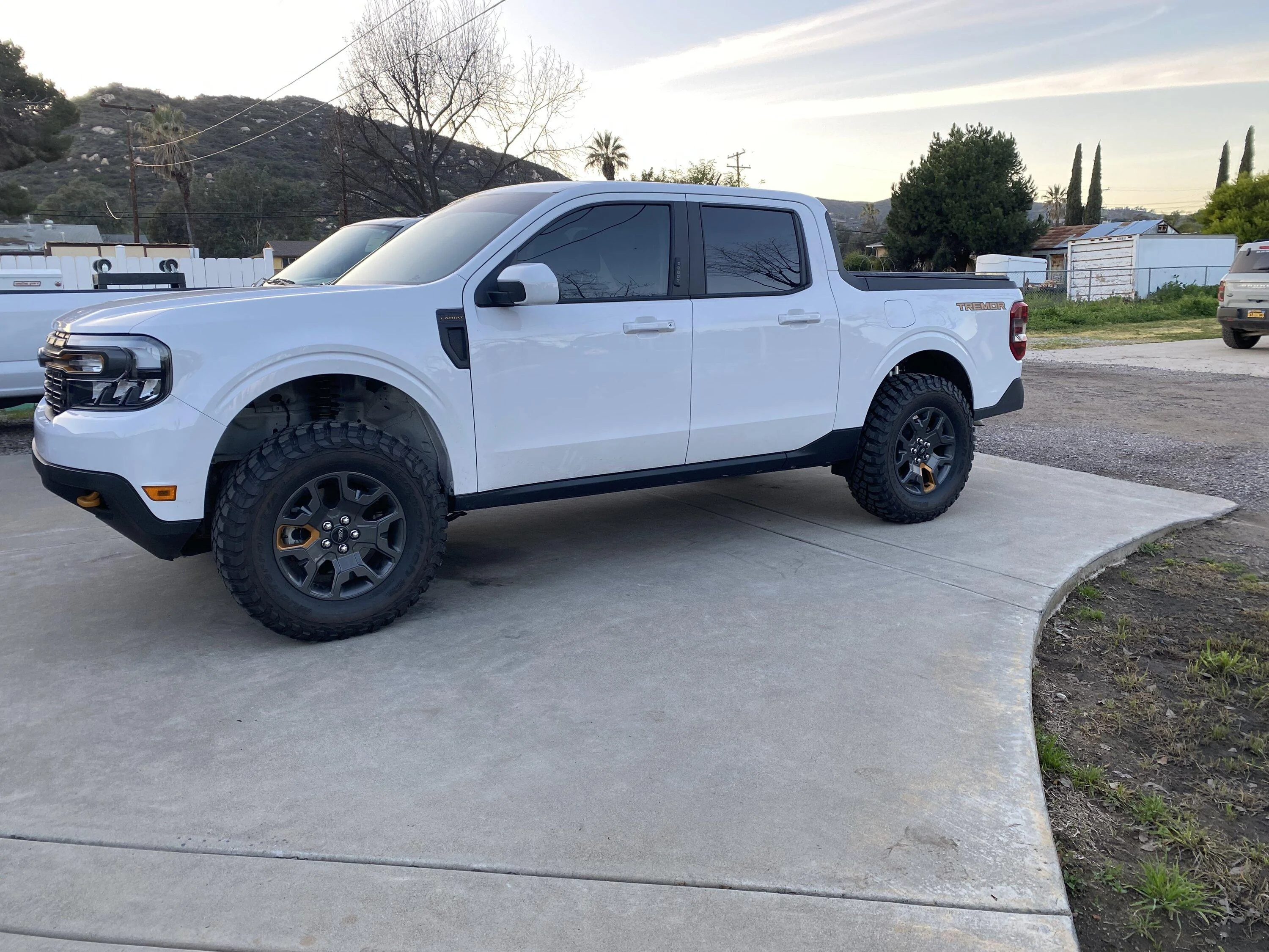

Thought I’d show some new pics with my additional (proof of concept )3” lift
have to do additional brackets to get the chromoly arms in but here is droop on front . Should get a little more with new arms .
Ford Maverick Prerunner style Maverick Tremor build w/ 33's IMG_3061
Ford Maverick Prerunner style Maverick Tremor build w/ 33's IMG_3058
and here is settled with some preload finally taken off the front
Ford Maverick Prerunner style Maverick Tremor build w/ 33's IMG_3086
Ford Maverick Prerunner style Maverick Tremor build w/ 33's IMG_3084
also cut rear bumper to start wrap around tube prerunner style with a skid down the center over the diff to come soon .
Ford Maverick Prerunner style Maverick Tremor build w/ 33's IMG_3083

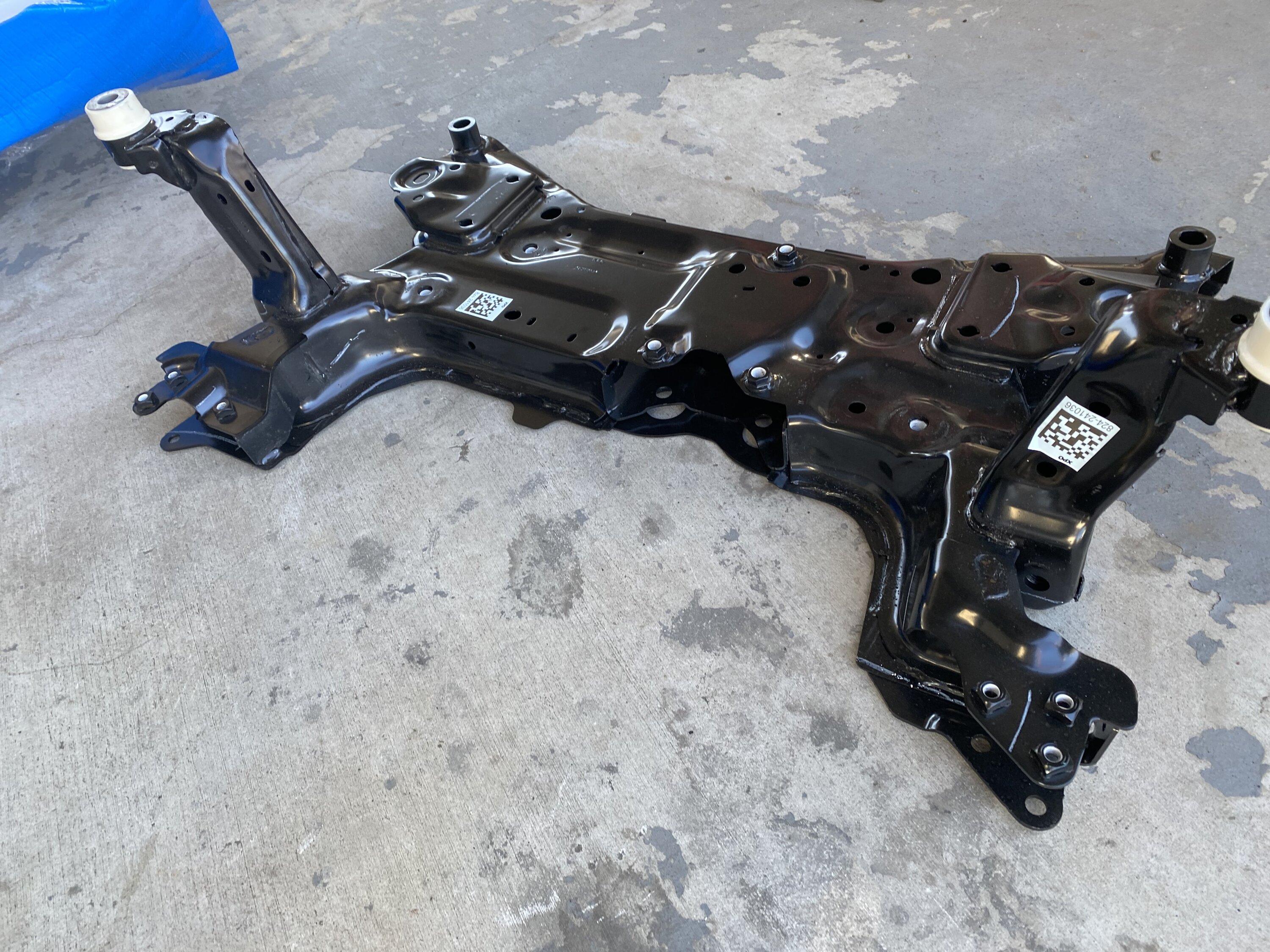

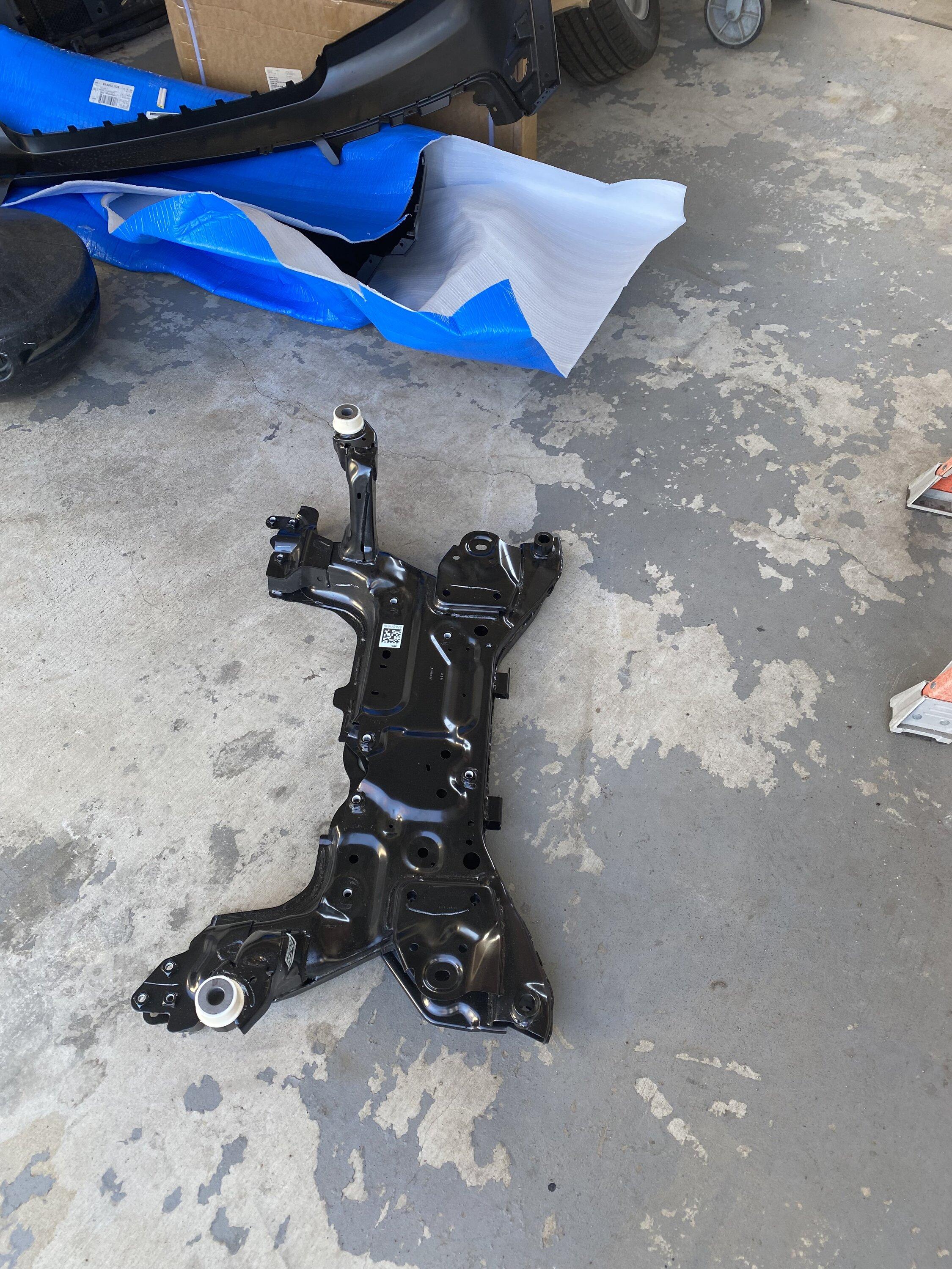

arms
Ford Maverick Prerunner style Maverick Tremor build w/ 33's IMG_2990
and factory crossmember in stock
going to do a chromoly
Ford Maverick Prerunner style Maverick Tremor build w/ 33's IMG_3074
tube version with a flatter rack mount area and 3 1/2” lift built in and better rear bracket kickers to unibody
Ford Maverick Prerunner style Maverick Tremor build w/ 33's IMG_3075
should gain some additional center clearance and strengthen the rear a arm mount area ( weak point I’ve seen on both damaged trucks I’ve bought .
sheat metal is just too weak and buckles or tears.
should see this close in a couple weeks.

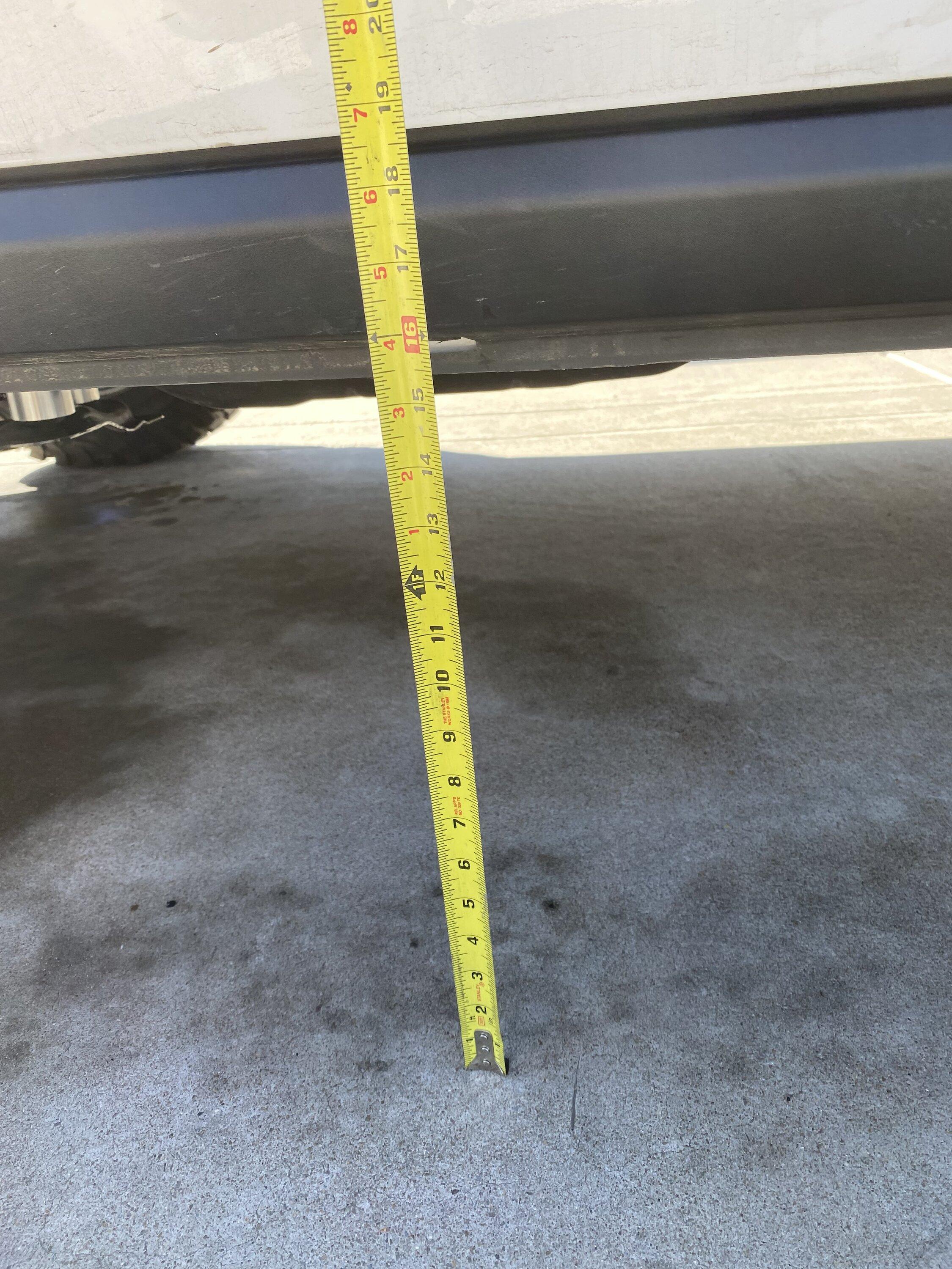

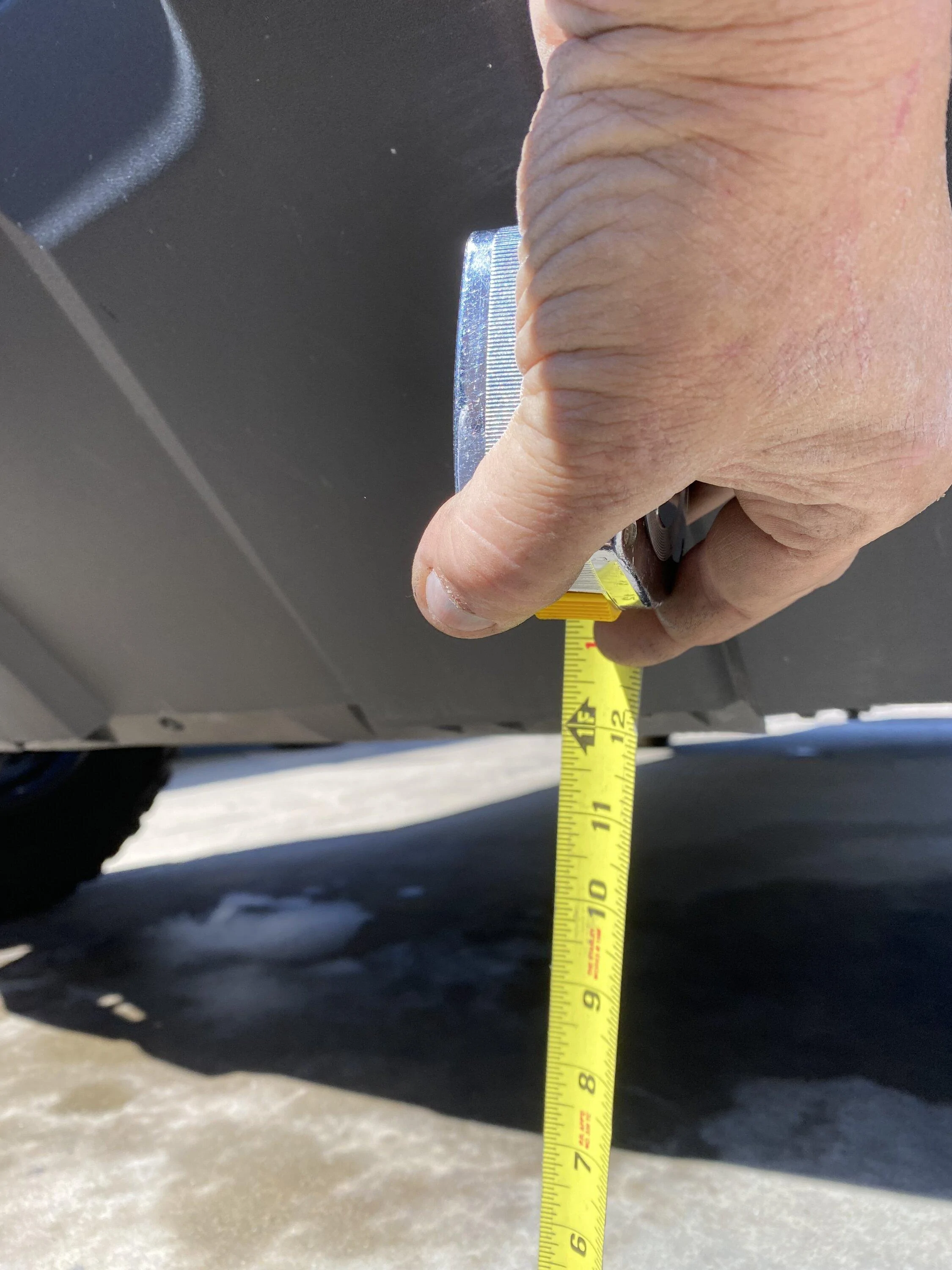

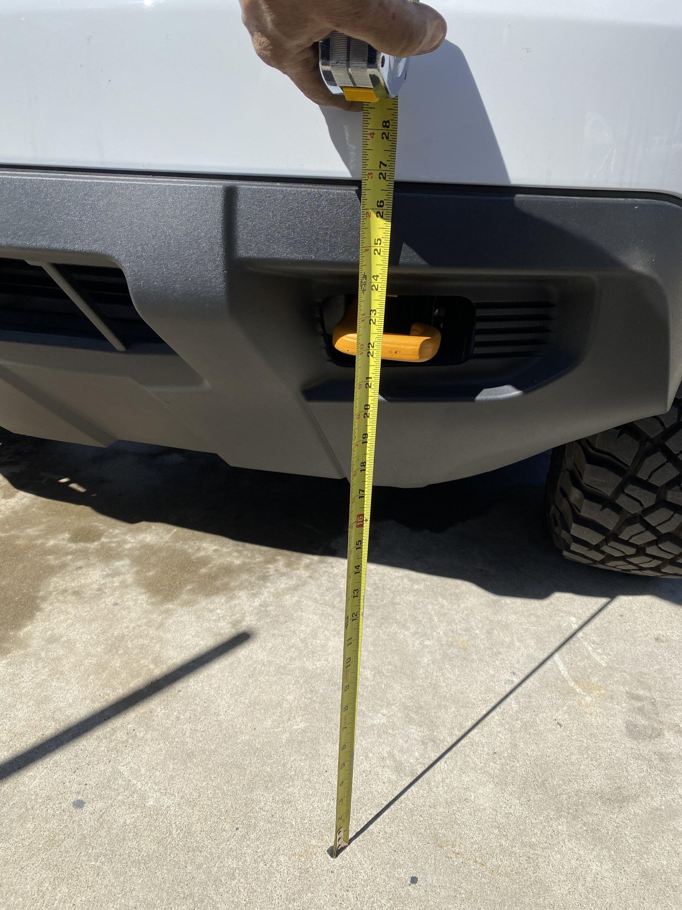

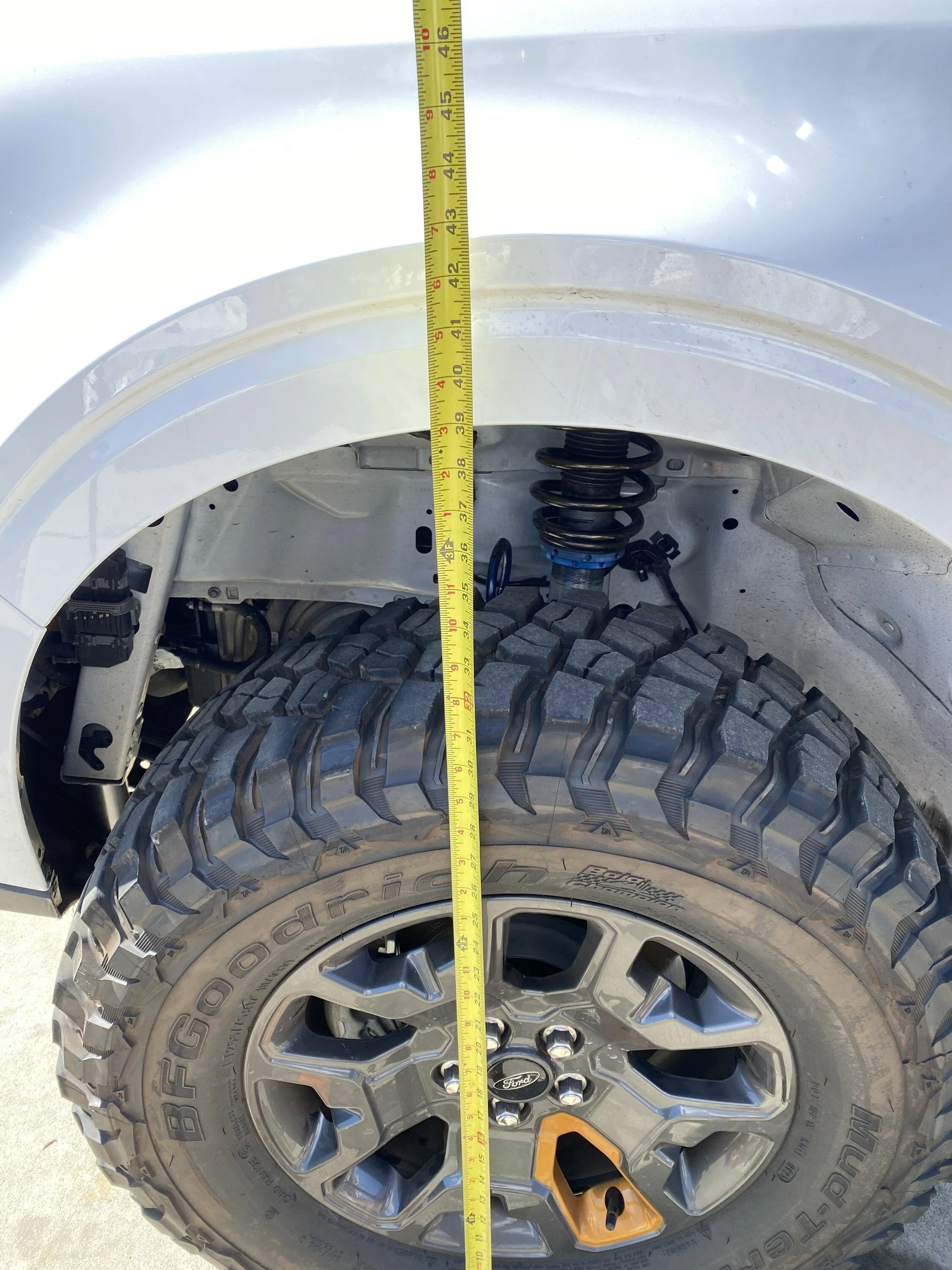

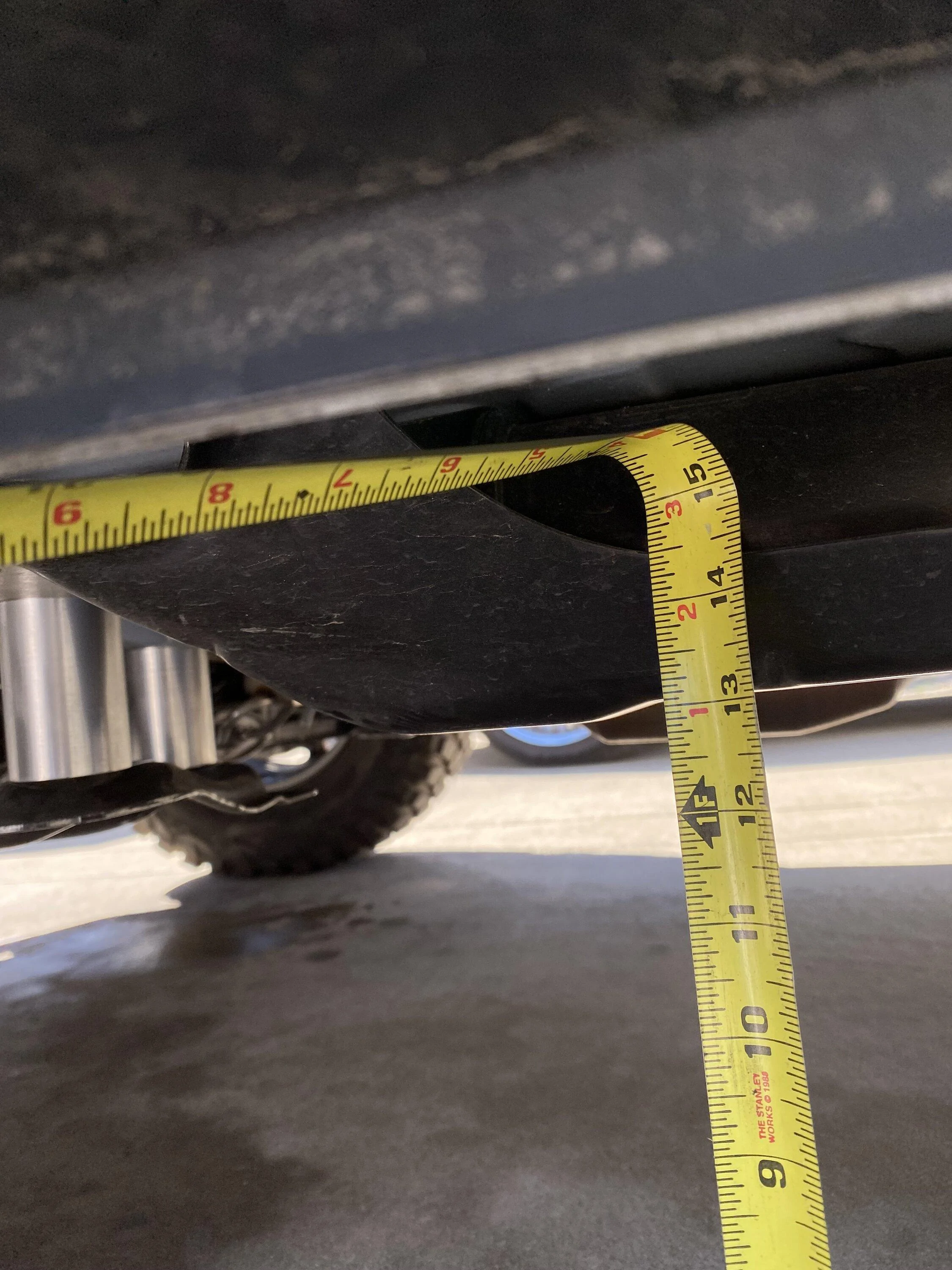

Additional measure pics
Ford Maverick Prerunner style Maverick Tremor build w/ 33's IMG_3066
Ford Maverick Prerunner style Maverick Tremor build w/ 33's IMG_3069
Ford Maverick Prerunner style Maverick Tremor build w/ 33's IMG_3073
Ford Maverick Prerunner style Maverick Tremor build w/ 33's IMG_3072
Ford Maverick Prerunner style Maverick Tremor build w/ 33's IMG_3070

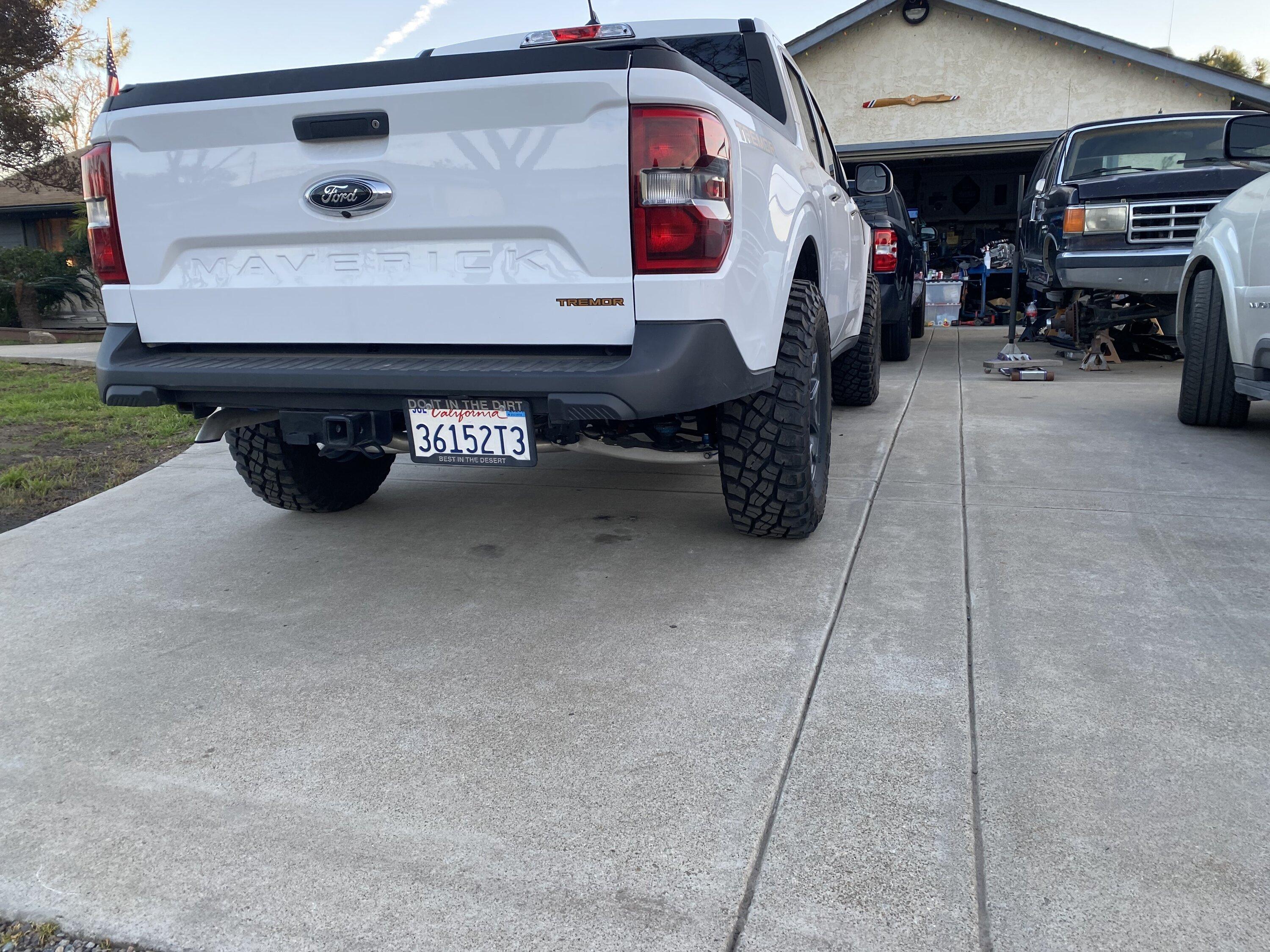

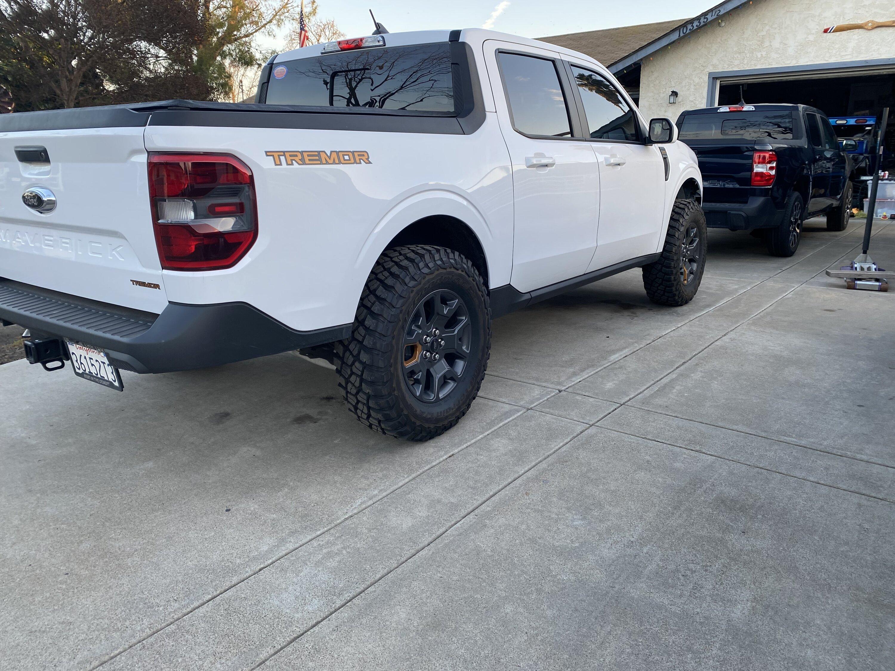

I will be posting as often as I can on this pre runner style build of my 23’ tremor . First I did a gr40 suspension kit from flat out suspensions.
Then I mounted up some 255/75/17 BFGoodrich mud terrains ( 32x10”)
Now the whole unit sits about 2 1/4 “taller at the wheel arch. Only 1 1/2” in rear.
going to order longer springs too to play more with height . Didn’t get the 3 1/2” I was looking for.
stance is not quite right. May go 11/2” wheel spacer until I can make some A arms.
next up is cutting the bumpers up and doing some tube bumpers with skid plates.
but first is relocating elm from lower federwell( worst ford placement ever )
And rim and weld pinch weld
it’s dark now so will do finish work tomorrow.
the best thing about the suspension kit is the rear went from 2 1/2 “ of suspension droop to 5”
will have to re cycle the front after I get new springs made .
biggest issue all around is the lower arm resistance on the front .I may go for a custom lower arm with a uniball or other joint layed sideways . The swaybar is also adding a large amount of compounded spring rate ,even with one side disconnected.( looking at modding apex disconnects or making my own)
