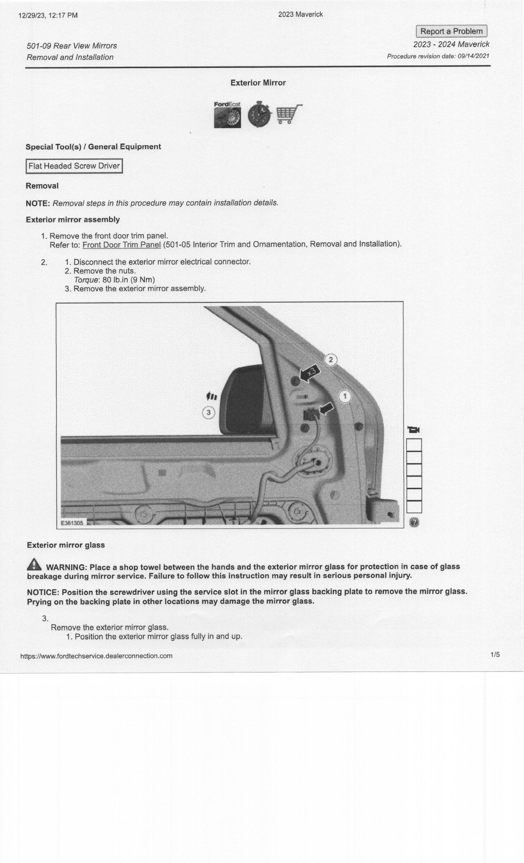

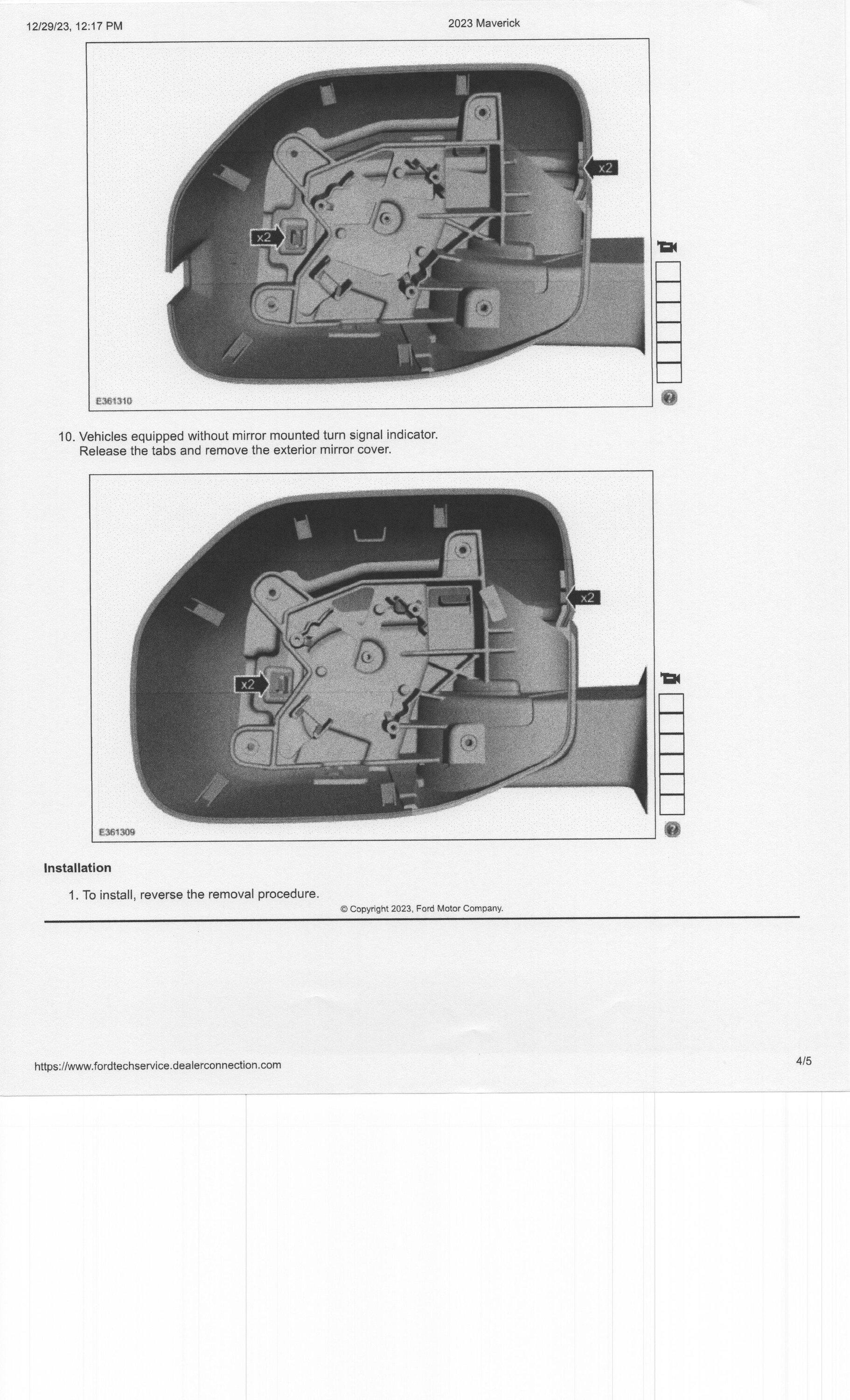

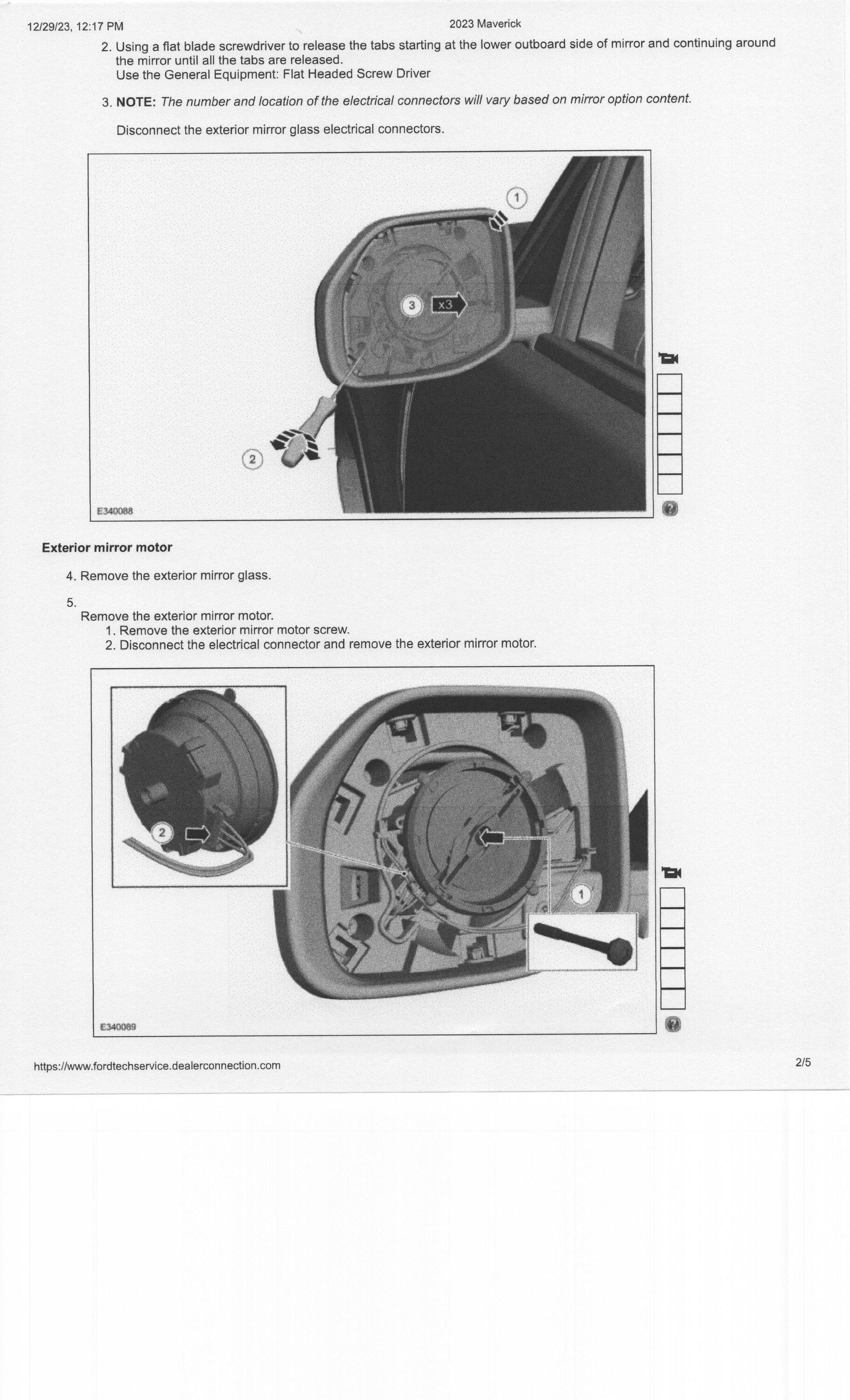

How did you take the mirror caps off? I was just going to search for that and read this.
Actually they came off easier than expected. No broken tabs. I just grabbed an area and popped off. Not sure if I did another set it would this easy. LOL.
I would recommend following the Ford procedure which involves removing the mirror glass itself, the tabs holding the caps on are actually kind of flimsy and OP got lucky not breaking them. The mirror glass is super easy to remove and will give you access to the plastic tabs holding the mirror cap on
100%. Yes , I did remove the glass per Ford procedure. Apologize on the missing detail.
