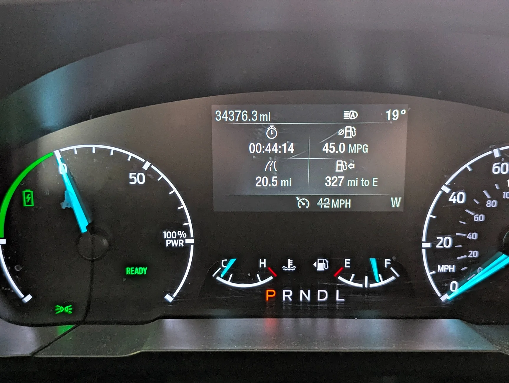

Okay, so today was a good test run. It was 11° when I left for work today. After driving about 15 minutes I noticed it was idling high (not anywhere near what it was doing previously, but still high) and I observed that the temperature gauge was still only between "C" and the first notch. So, I reset my trip odometer and kept an eye on it for the rest of my trip. After driving another 44 minutes with the heat on low, it was still in that same spot. The only way I could get it to get closer to the normal range was to shut off the heat. I'm wondering if I have a jammed thermostat or something, and the car's idling issues are due to it trying to rapidly warm up. The higher I crank my heat, the higher the idle was going. I tested it at red lights.
Unlike an Otto-cycle engine, the Atkinson-cycle engine in the Hybrid does not produce a large amount of waste heat that you can siphon off to heat the large cabin space. They even had to introduce an exhaust heat exchanger to recover some heat from the exhaust gases and an electrical heater in the max defrost setting in order to get more. Instead, use the seat and steering wheel heaters and if you have condensation on your windows then set the cabin heat much lower just to blow air.
I know you were driving but it would have still been helpful to get a video of it.
Thermostat isn't a bad guess but as @Master Blaster explained the 2.5 runs cool and your average speed - roughly 28mph - means you were likely in electric quite a bit with the heat on, further siphoning off remaining heat from an engine that isn't running.

Unfortunately I don't have heated seats or steering wheel. I can't say I've ever really paid a ton of attention to the temp gauge since it's a newer car and I figured I don't need to, so it's hard to say what's normal for the truck. I don't by any means claim to be a subject matter expert, but it does still seem abnormal to me that it would still be this low after an hour of driving.
What you saw was normal - unless you are doing straight highway speed miles, and your cabin heat isn't maxed out.
The gauge dash at C - the right side of that, or increasing side of gauge - is 120 F.
That's the minimum the ICE will warmup to if no calls for heat, and then it's willing to shutdown on coasts or lights like normal.
Next time ICE is called to turn on - it'll warmup to that again if below.
If you have the heat on and big temp diff from that & ambient outside - I've seen from 127 to 135 be the minimum, and then ICE will run until 145 to 150 just depending - and that is not above that lower bar, which is 156 F (69 C temp).
But except for what is called for by the Go pedal and ICE power needed - I've never seen it idle much higher than normal merely for temp. 1250 normal - seen 1500 when cold.
Now - I'm not out in 11 F temps either normally!
I'd have to find a log from last Jan to see what happened then. (2nd phone probably left in truck and dead for logging)
So I could easily see if the system knows it's in a losing battle to keep or increase coolant temp, then the idle has to go up.
Found one. This is from -2 F start day.
Took awhile to get up to 120 F and I didn't start moving until it was, and it never went above 120 F until I got past 28 mph. I think that was turning onto the highway, must have had green lights as no stops prior.
Better believe I had heat on - probably wimpy at this point, so not much fan likely.
ICE never turned off up to this point of getting on the highway - when temp finally starting increasing with speed.
I must have been coasting thru the intersection - no ICE TQ really, regen on, speed slowed.
But even at -2 F, ICE RPM 1540. Again thinking my fan wasn't turned up or ICE probably would have been higher. (this was mainly downhill coasting to this point - HVB went up 5 degrees)
Ford Maverick Potentially Dangerous High Engine Rev 1765218217959-6t
Had been normal 65-70 mph on highway, and slowing on exit ramp allowed ICE to turn off finally. I'm sure at this point, I had the fan up to good level. (HVB finally got up to 25 F after this regen)
Notice with 167 max temp reached - that would be just above that lower gauge line at 156.
Ford Maverick Potentially Dangerous High Engine Rev 1765218569419-rm
Dropped to 154 by the time I started rolling on green light - so it was still high enough not to enable ICE merely for heat. And it never went up again only doing 35 mph or below to office.
Normal EV mode used for a section so it dropped to 149 quickly.
Actually dropped to 147 when ICE called on for power on acceleration, but below 30 mph.
So yes normal to see nothing but lower side of scale in the cold.
But not normal I'd say to have ICE idle super high - I never had above 1500 basically. Maybe it sounded higher with Generator motor basically matching ICE rpm.
I am wondering if your air shutters are closing completely - should have an error light or code thrown if not due to an issue.
