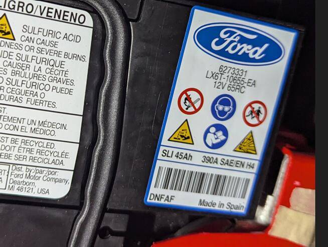

That is the correct HYBRID replacement for the cheap OEM flooded battery. Just compare the difference in reserve capacity and CCA. I know it is not used for cranking or starting but a massive increase in reserve. A deep cycle battery might be a better fit considering its use. 390 CCA vs 540 CCA, 45ah vs 50ah, 65RC vs 80RC. The AGM is far superior and more expensive.

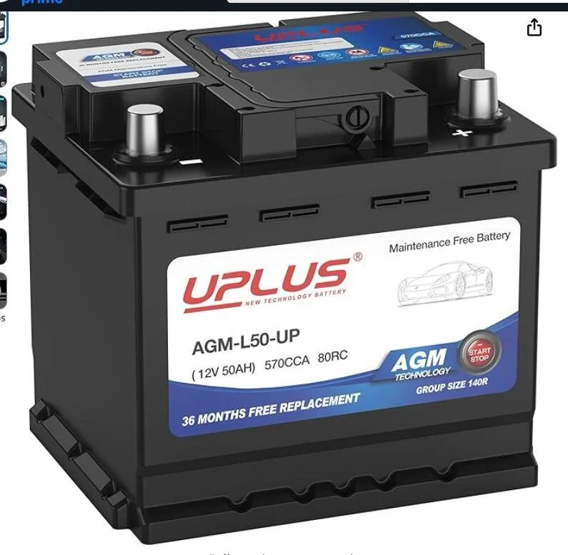

12V 60Ah 680CCA AGM Battery
On Amazon, several brands
$119.00
$119.00
This is the replacement AGM I purchased as a replacement for my 24 HYBRID. I called my dealer and said I have a bad battery, and asked if they confirmed that would they replace it with an AGM and they said no. Replacement would be the same OEM flooded battery. I said thanks for not wasting my time and bought my own.

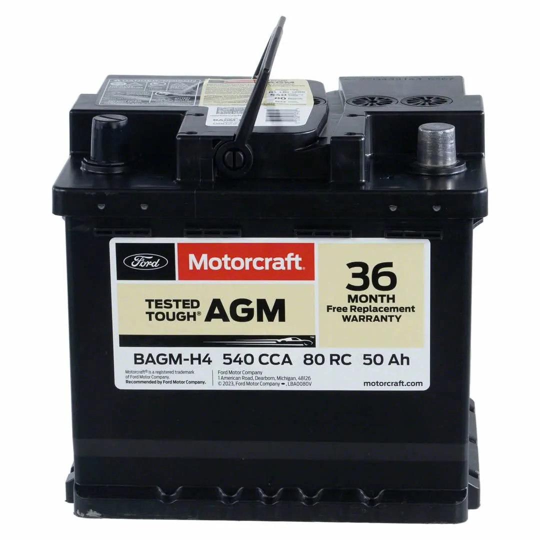

According to the Ford Catalogue The 2025 uses a AGM battery. There are 2 listings one is for the Hybrid and one for the EB. In 2024 there is an AGM listed and a non AGM. The non AGM would likely be the Hybrid but that is a guess I did not go into it that far. All 3 batteries are available from Motorcraft. As for Warranty replacement. Ford dealers are only allowed to replace with the same battery. Failure to do this according to Ford's policy will Void the battery warranty as well as refusal of the replacement. In other words if A Ford dealer put in an AGM where a non AGM was Ford will not pay them for it.
I hope this helps.
