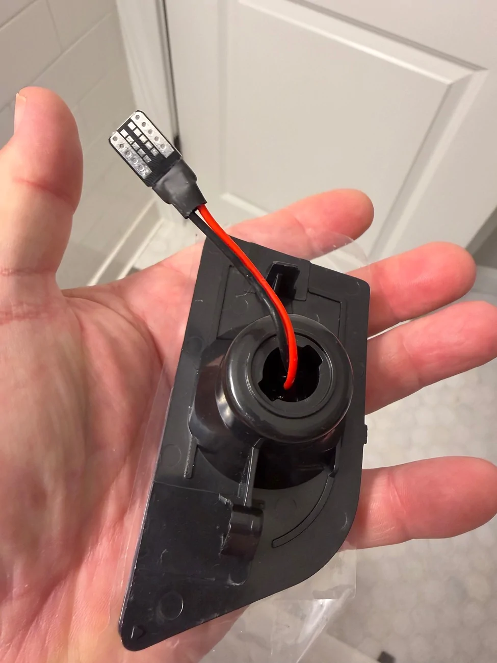

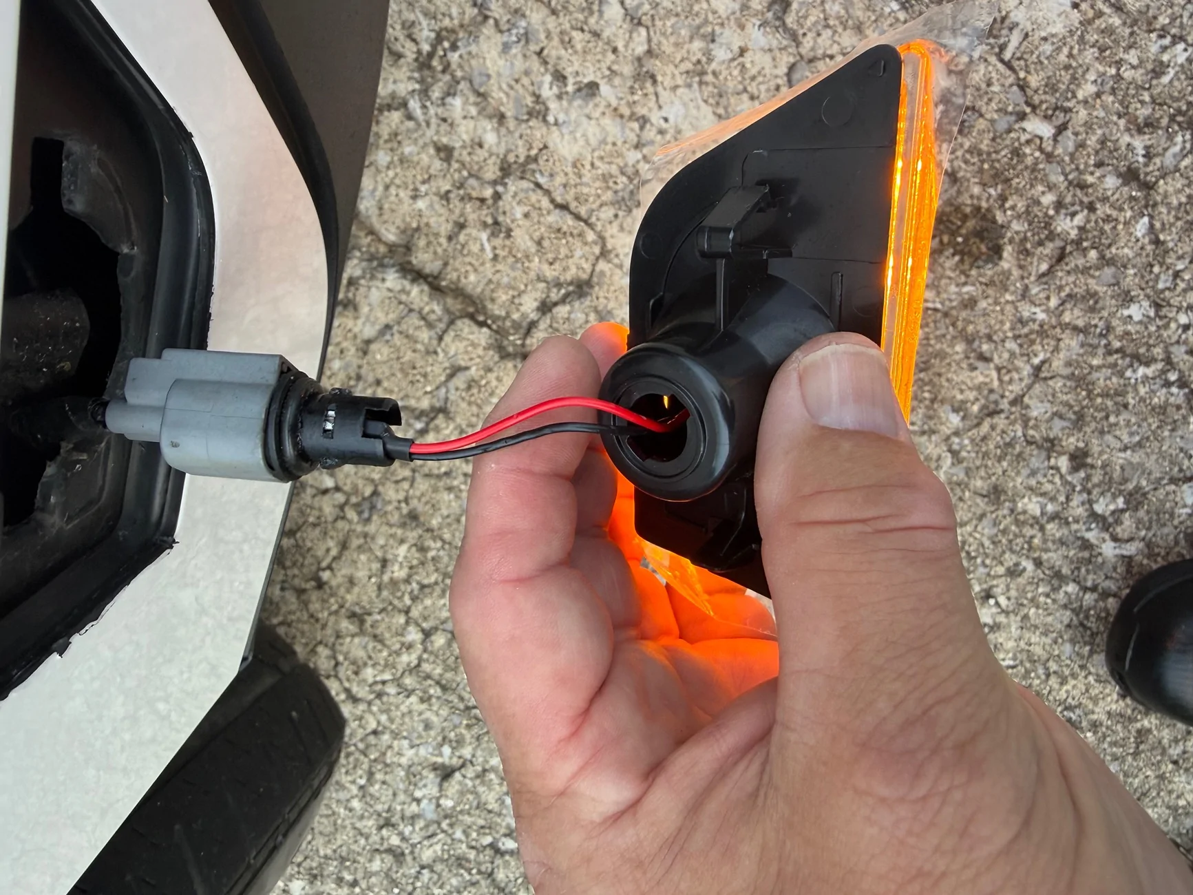

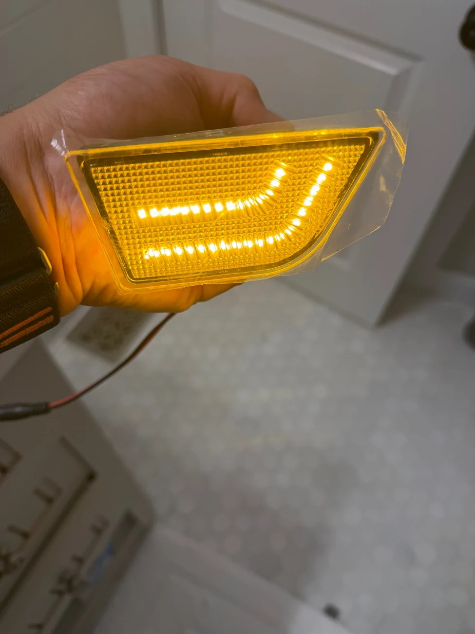

I messed up the edges when I tried to get the OEM out with a plastic pry bar. Now I use a thin putty knife to pop them out. Just got them today and it’s raining, so I fired the up in the house they are freakin bright. They work either way with polarity too I’ll install them tomorrow if it clears up

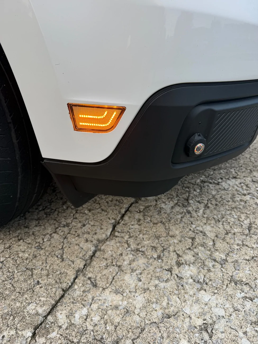

It’s done, there in and bright. I guess you could mod the socket and put a resistor in series to dim these down and bypass the resistor for turn signal use. They are bright, let’s see how long they last.
