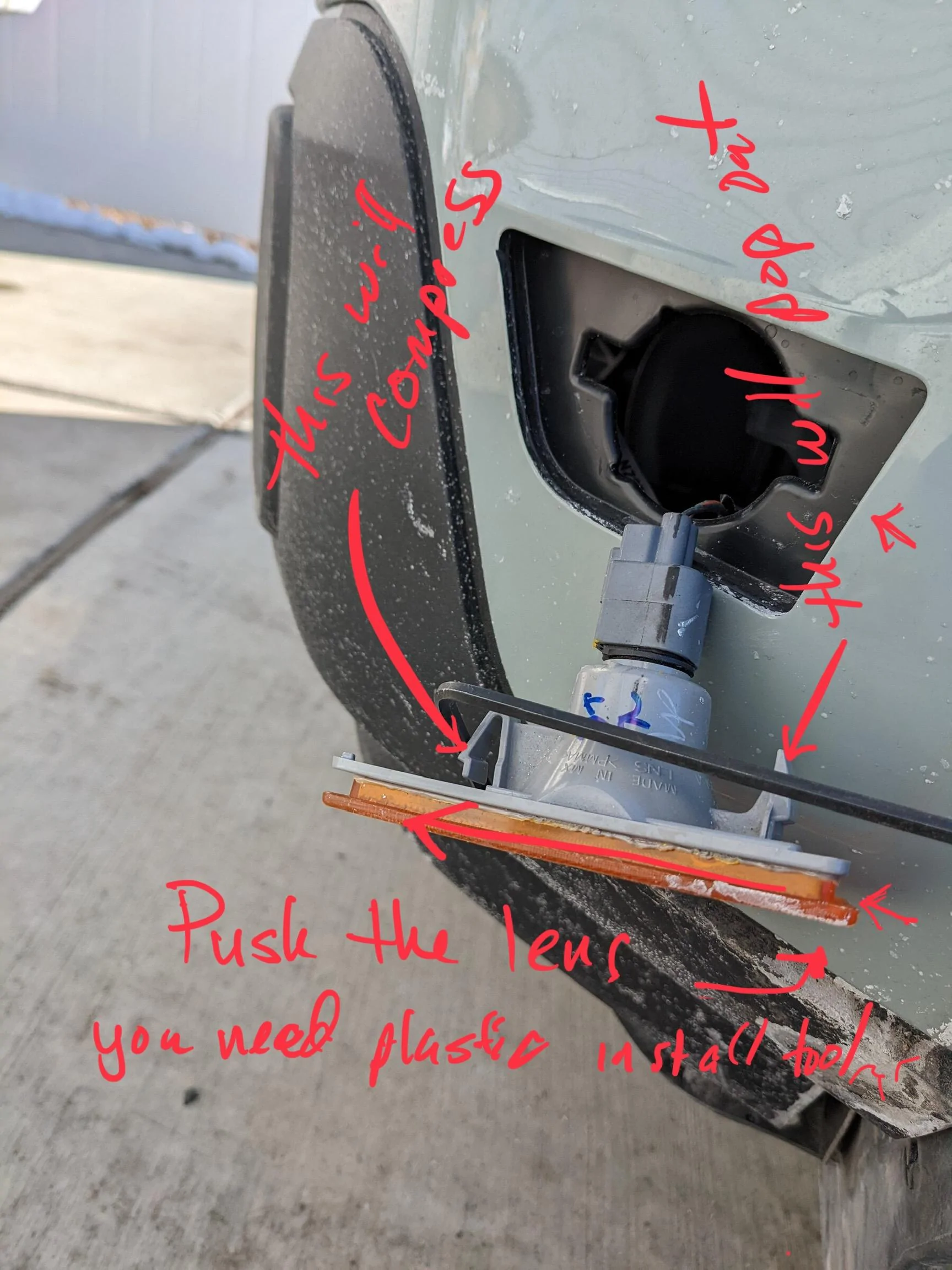

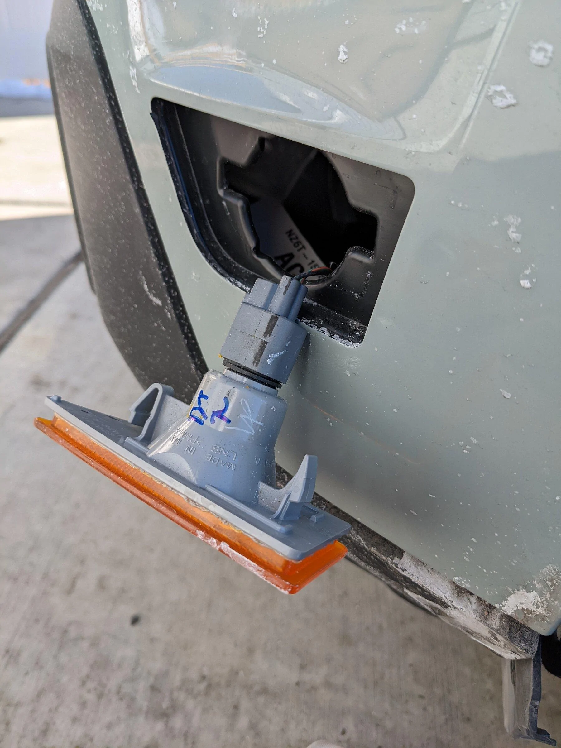

This is so easy to remove. It is made to be removed from the front lens. You will use a plastic installation tool to pry under the yellow lens closest to the wheel well.
Then push the lens forward toward the opposite side. This might not be understood. Look at the photos of the lens when you push the lens it will press on the tab opposite from the plastic tool. This will then unlock the tab and it will poop out.

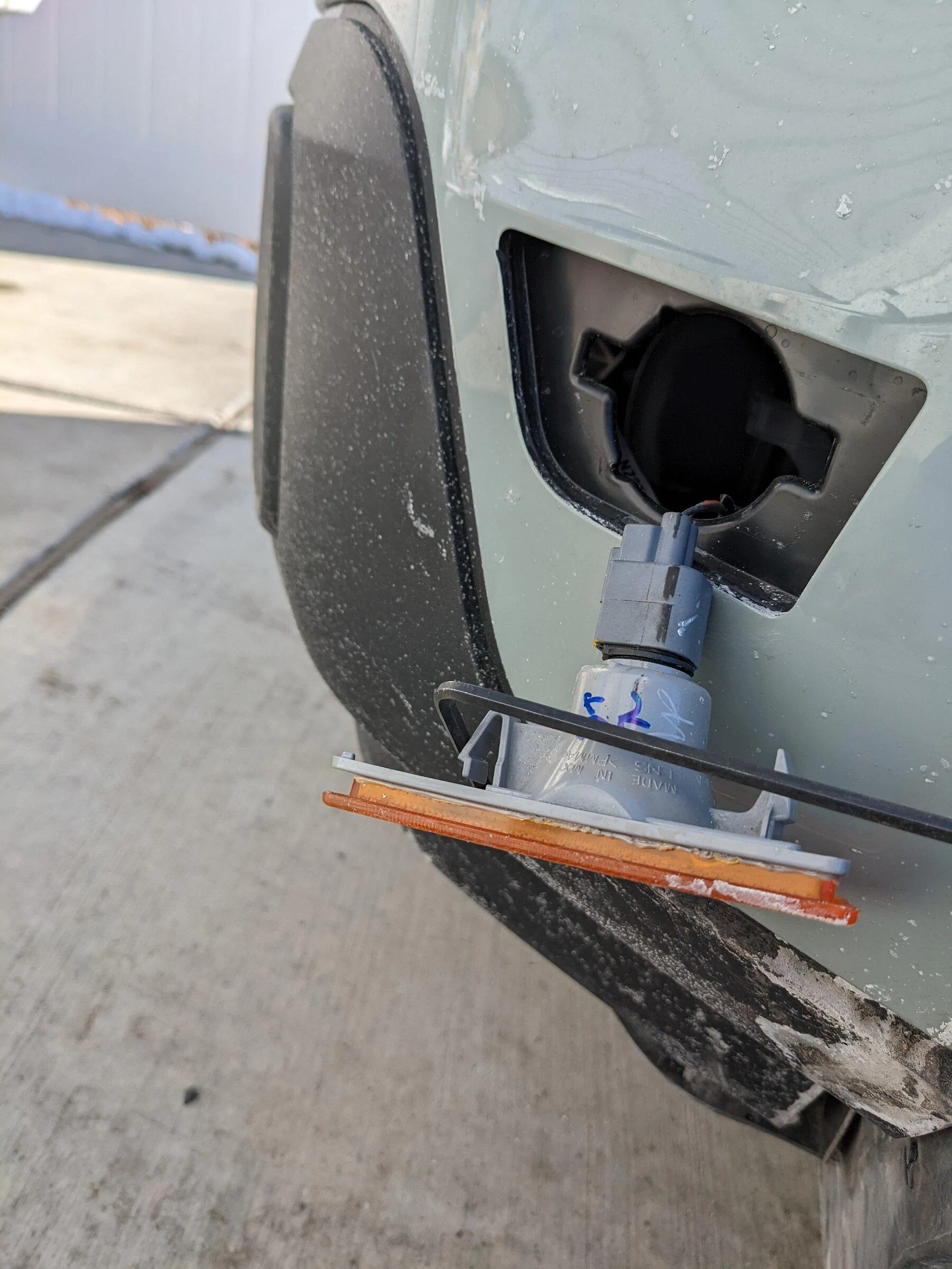

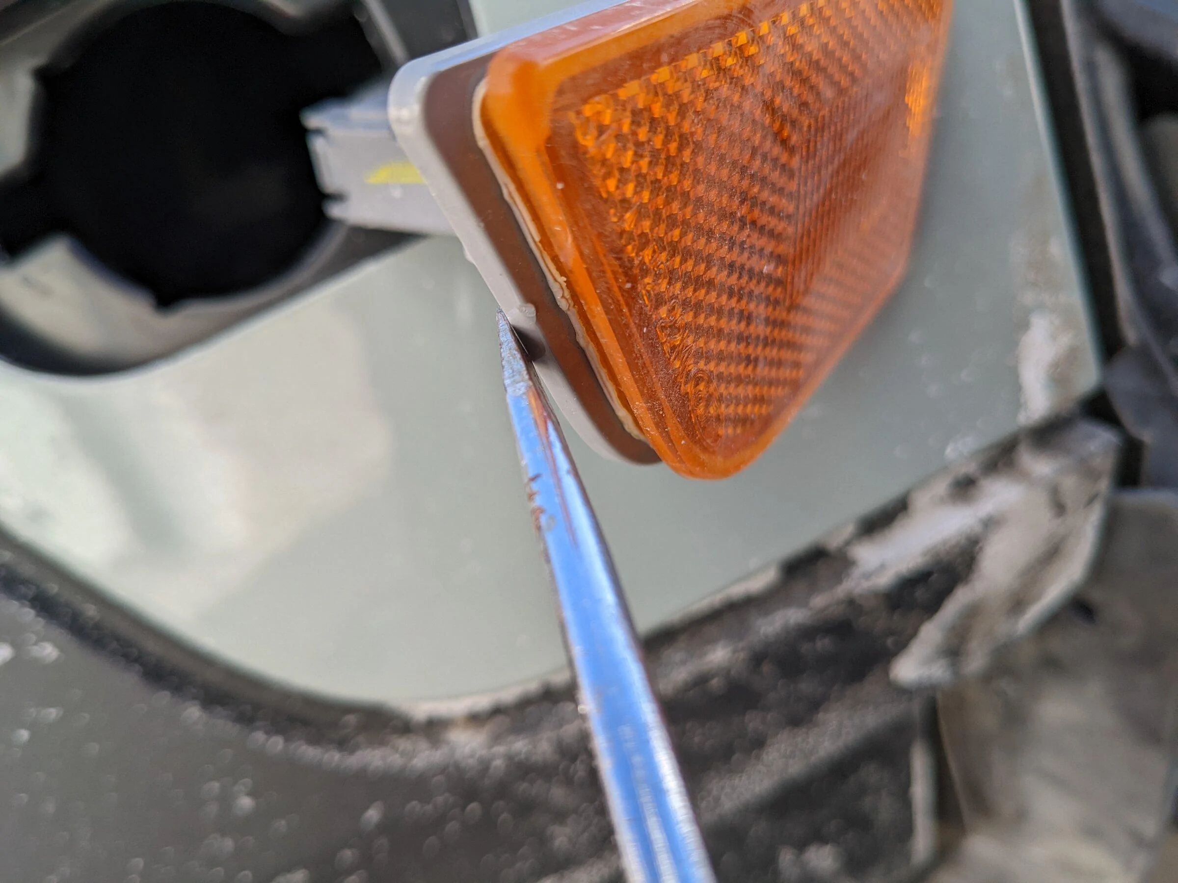

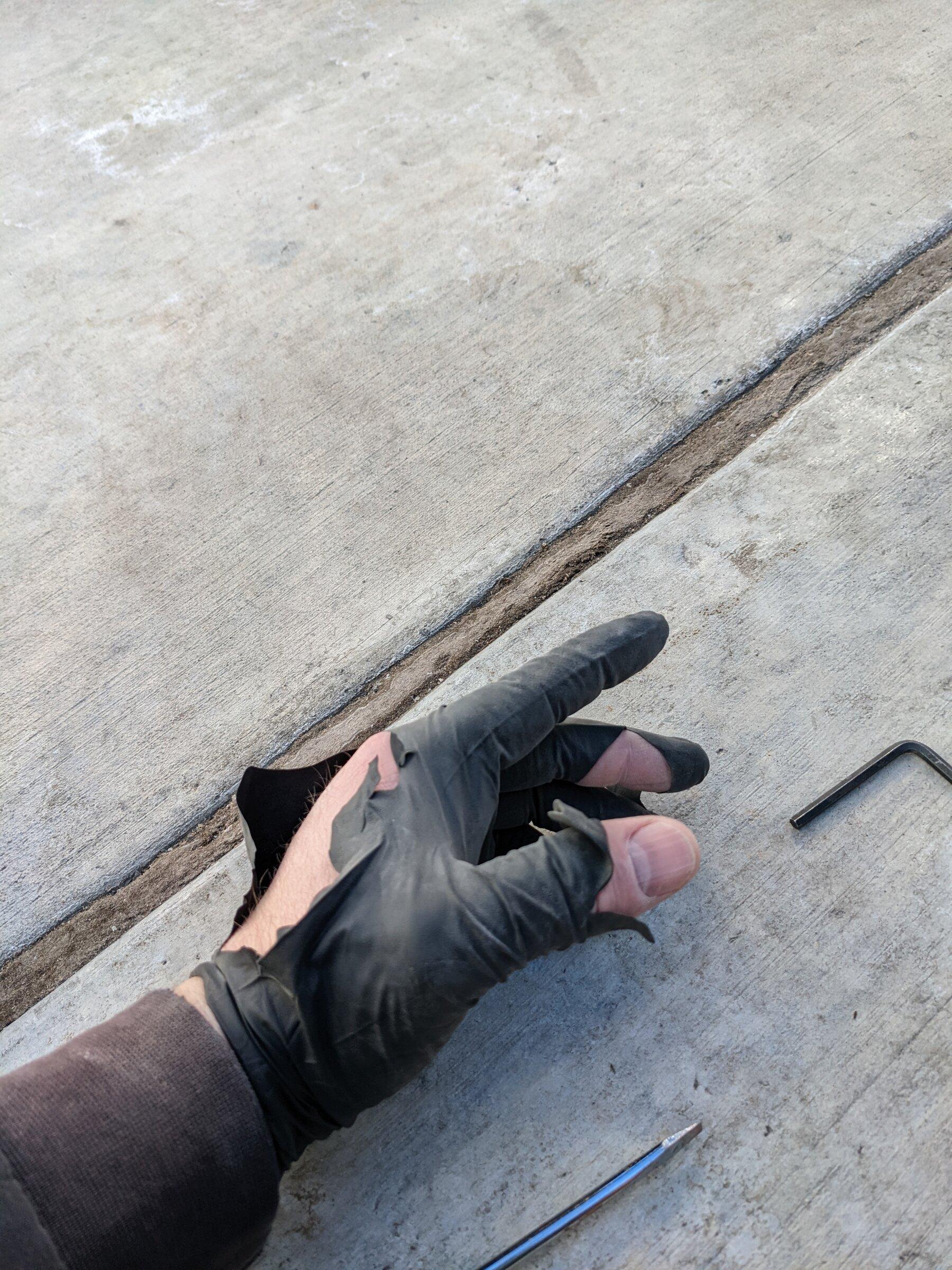

However, as you will see in my first image, my hands are too large to squeeze in there so I had to come up with an alternative method. Also indicated in the picture of my hand is the amount of time I tried to reach my big maw up inside the bumper cavity ...

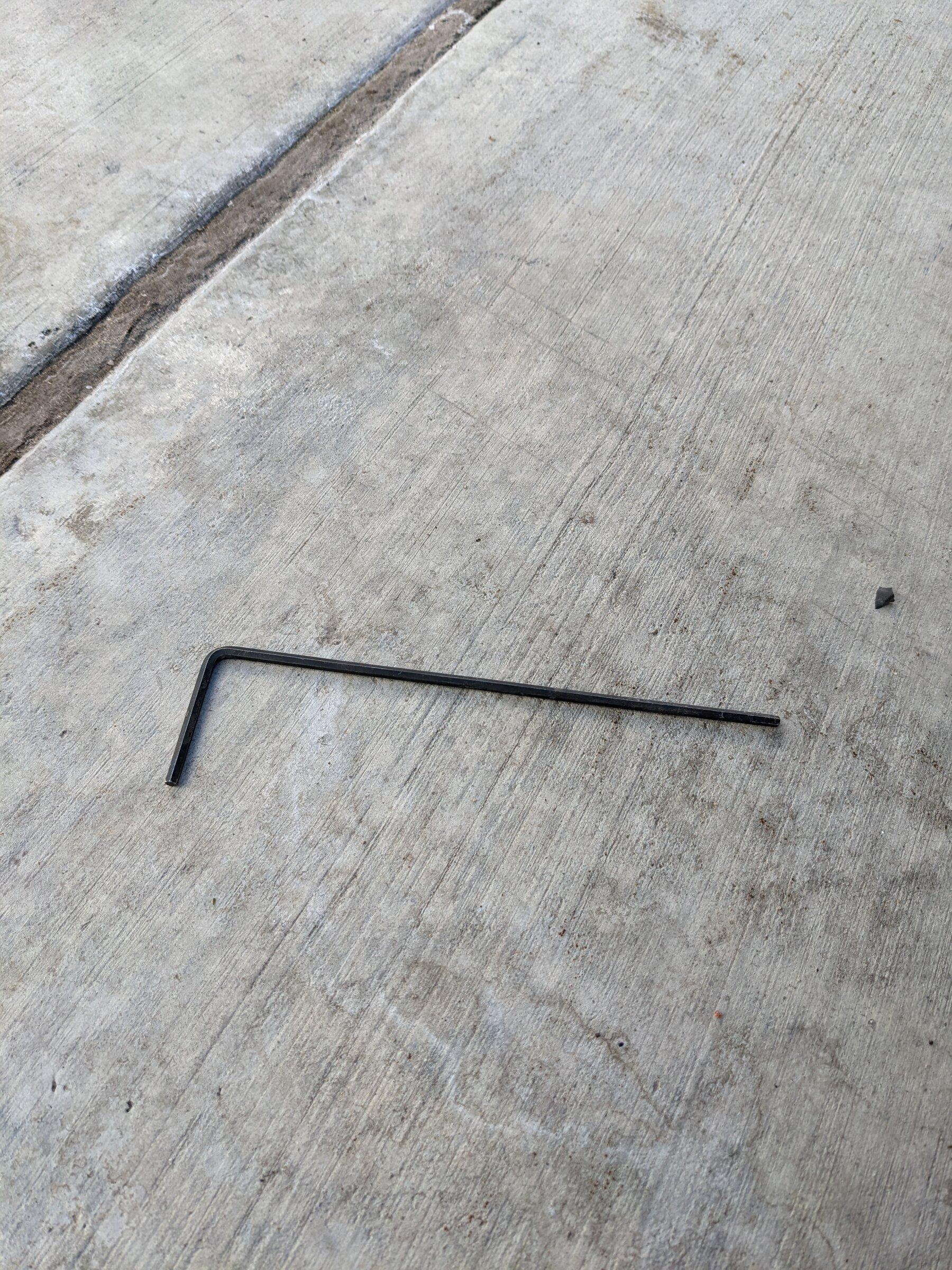

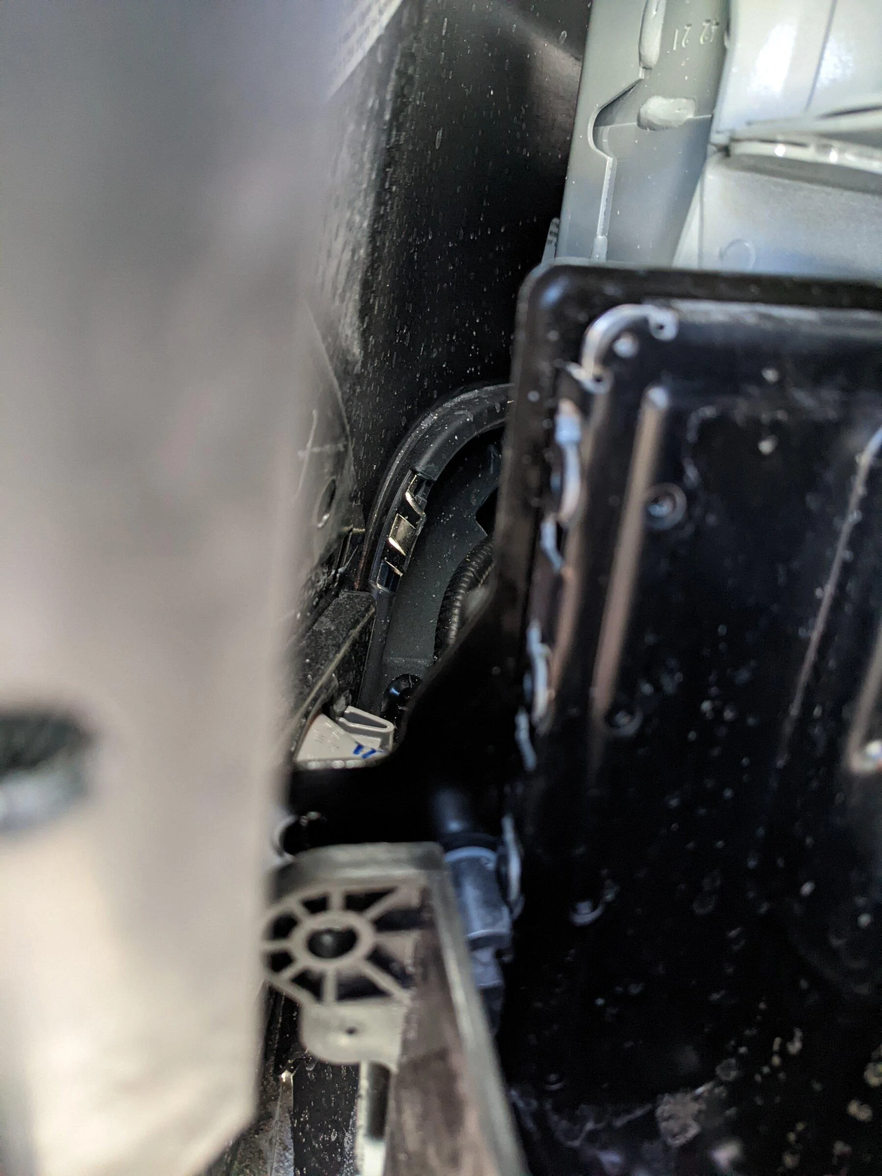

I noticed the side marker light housing might be able to be unclipped if I could somehow pull the clip on the far side (from the wheel well) [I used a long allen key] while working a screw driver back behind the light housing. [In retrospect, something thinner and more hook-like might work better - but a small and thin flathead would work great in any case].... It worked! 😃
Hopefully my images are illustrative. I apologize if the salt offends anyone. Apparently salt is cheap here near the Great Salt Lake, so it's the primary road treatment during winter storms. If anyone has clarifying questions please ask and I will try to explain more thoroughly.
While I had already taken apart far more, I believe this method only requires the felt to be pulled back (maybe 4 or 5 clips removed). None of the plastic of the undercarriage needs to be touched.
Been trying to say this for months. Everyone making it harder than it needs to be

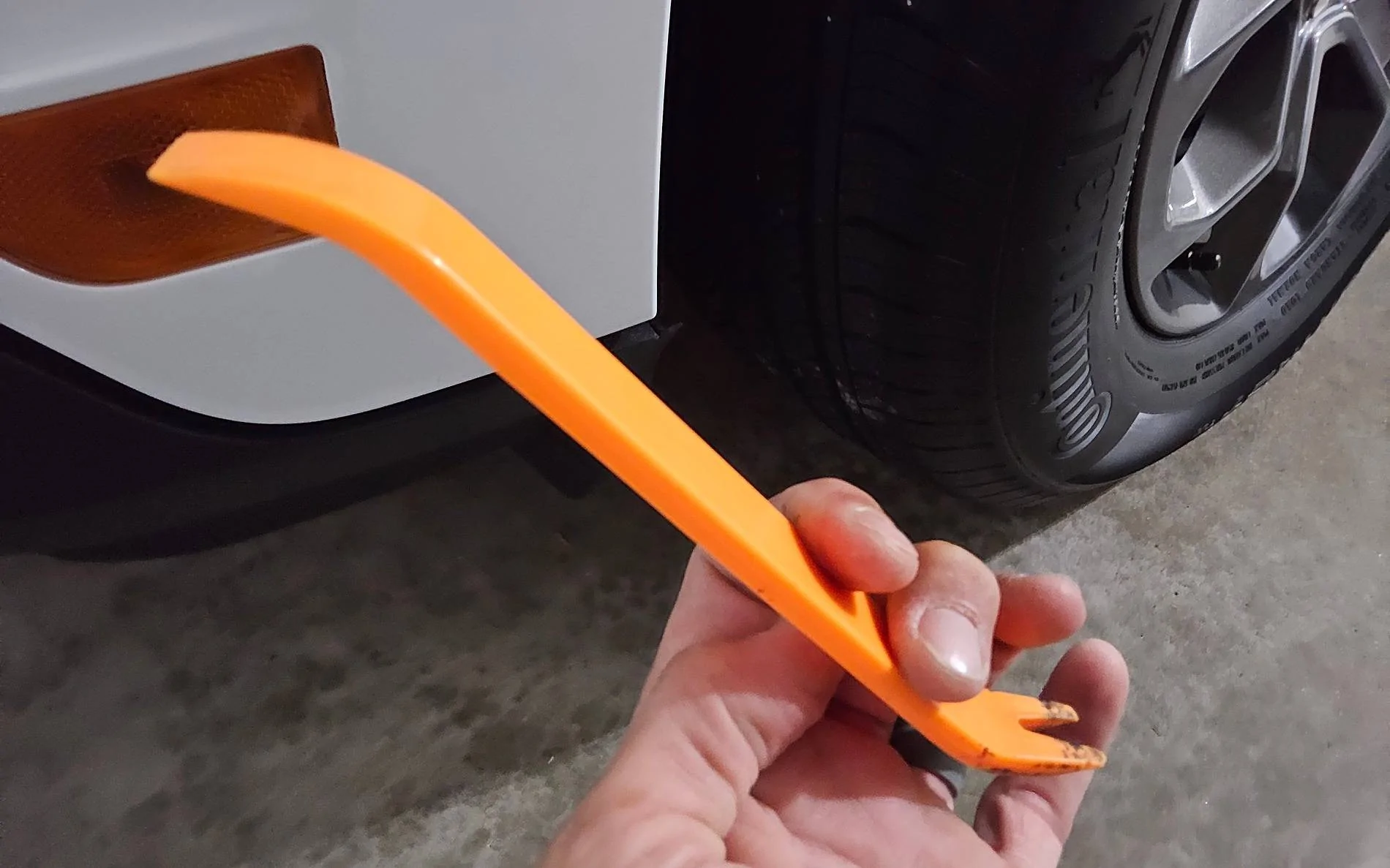

I used a plastic trim tool, it's was a tad nerve racking. They're just plastic, I was afraid I was going to break them. Thankfully they came out pretty easily...
