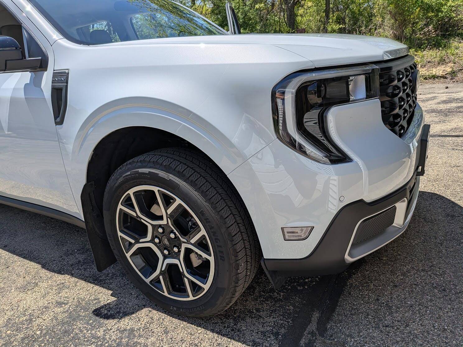

Installed clear side marker lens and @LASFIT Side Market LED Bulbs on my Maverick! The bulbs are super bright (almost like fog lights bright) and the lens are of a decent quality for being an eBay part. Here's how she sits currently!

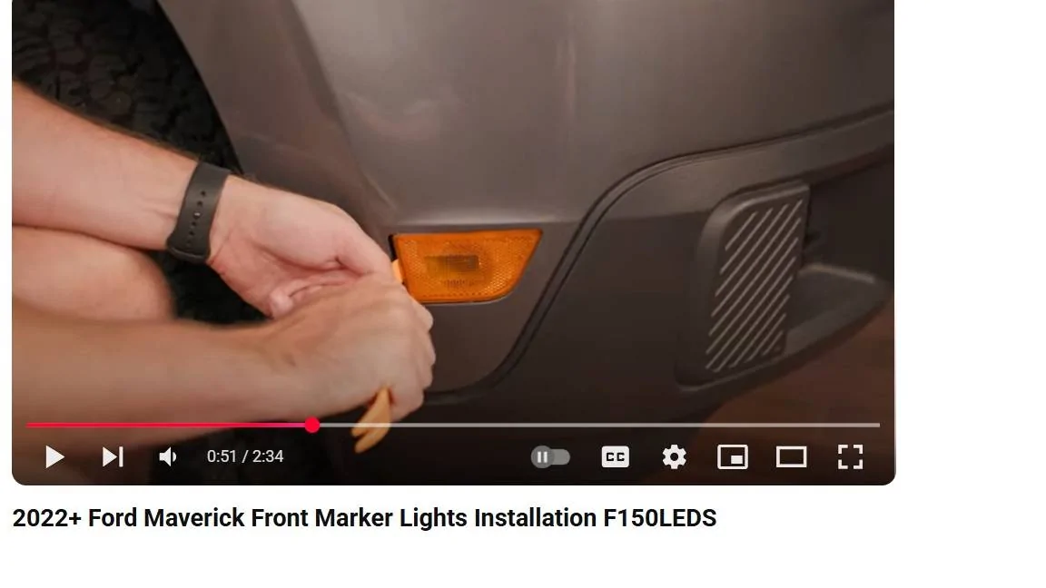

I was installing a set. Started to see the fender crease using a plastic pry tool. Didnt continue with it. Any special things used or added to prevent a dent?

I wrapped the pry tool tip in painters tape and also kind of pushed the tool and pulled away from the tire instead of using the bend in the pry tool as leverage. They're a little finicky but I've been able to get them out with no damage

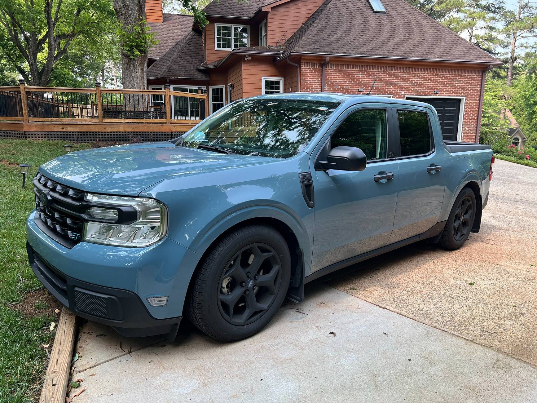

Amber lights are available, installed them on my Azure gray truck.

There’s a clip on the back that you need to release. Just pull wheel well liner back and reach in!

If you can, you definitely want to come at it from the inside. I had to use a long metal rod to get around a metal mount on the driver's side, but it's easy enough to push in the retaining click and avoid the risk of dinging the paint or deforming the body.

It is easier removing from the fender well vs. the video. You can push it out easier without damage to the fender exterior, especially on the passenger side w/o the bracket in the way like driver’s side. It’s all a matter of preference.
