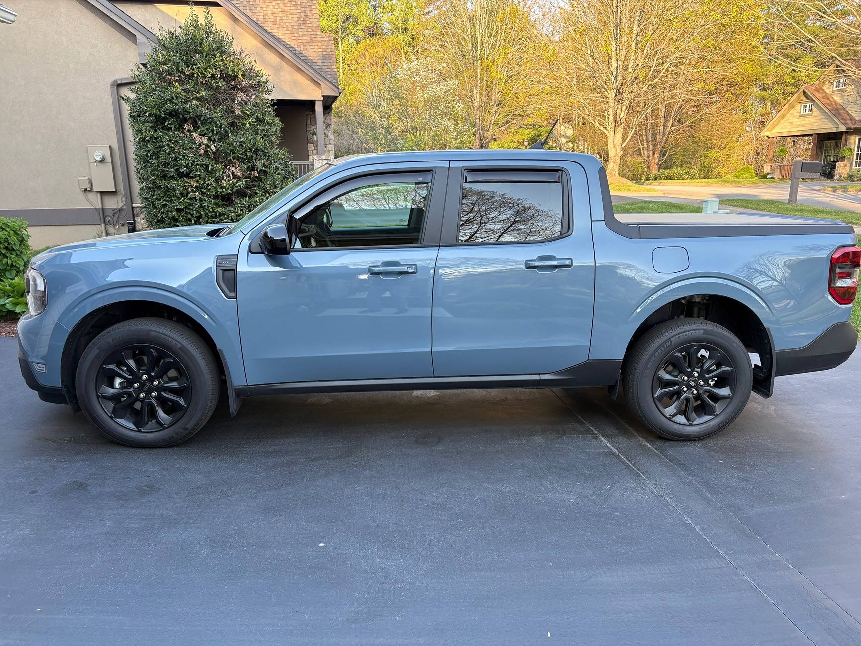

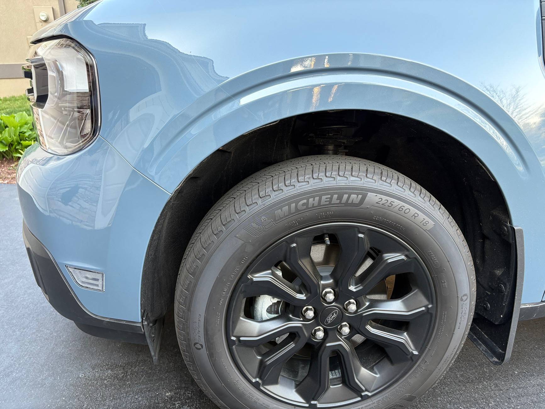

I just installed my clear ones on our Azure gray 24 and very pleased with the look. I did use Diode dynamics amber lights to stay legal.

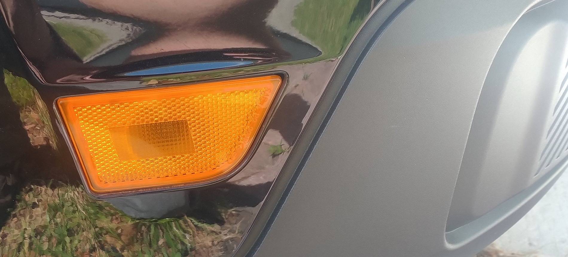

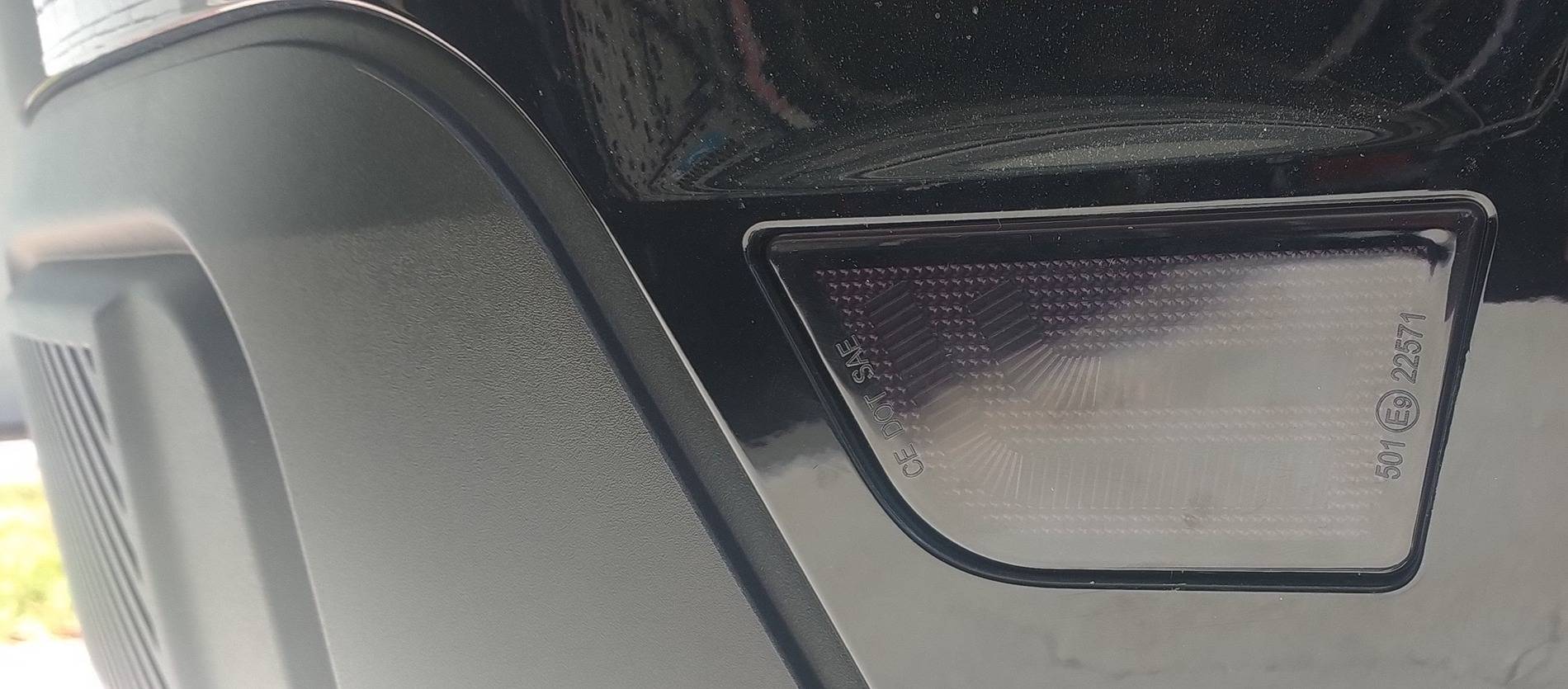

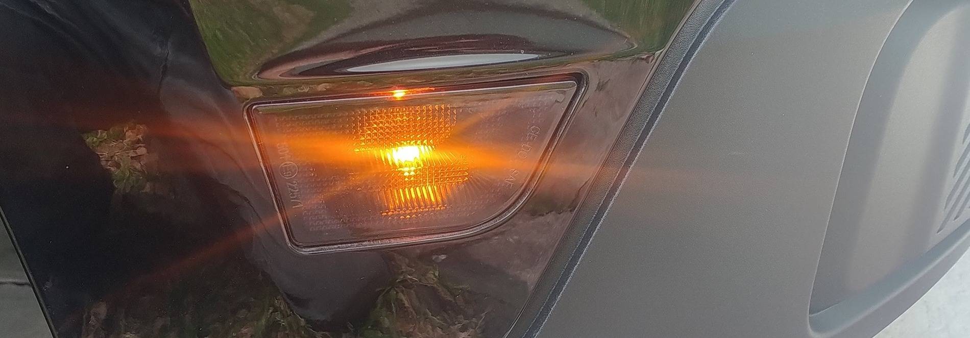

Installed these smoked version on my Shadow Black with BAP.
This and the 3rd brake light were the only lights that just didn't fit with the BAP.
One of these was little loose installed, some 3m tape took care of that.

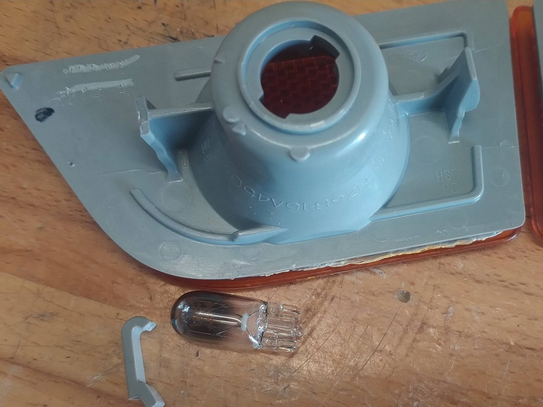

One of the clips broke on the factory lens, and the bulbs also look burnt, less than 1 yr .
Installed Lasfit amber led bulbs, they will be plenty bright.

Yea, I had to remove the fender liner clips and push the tabs from behind the fender. Still broke one of the clips on the light, but I won't be re-using the original.

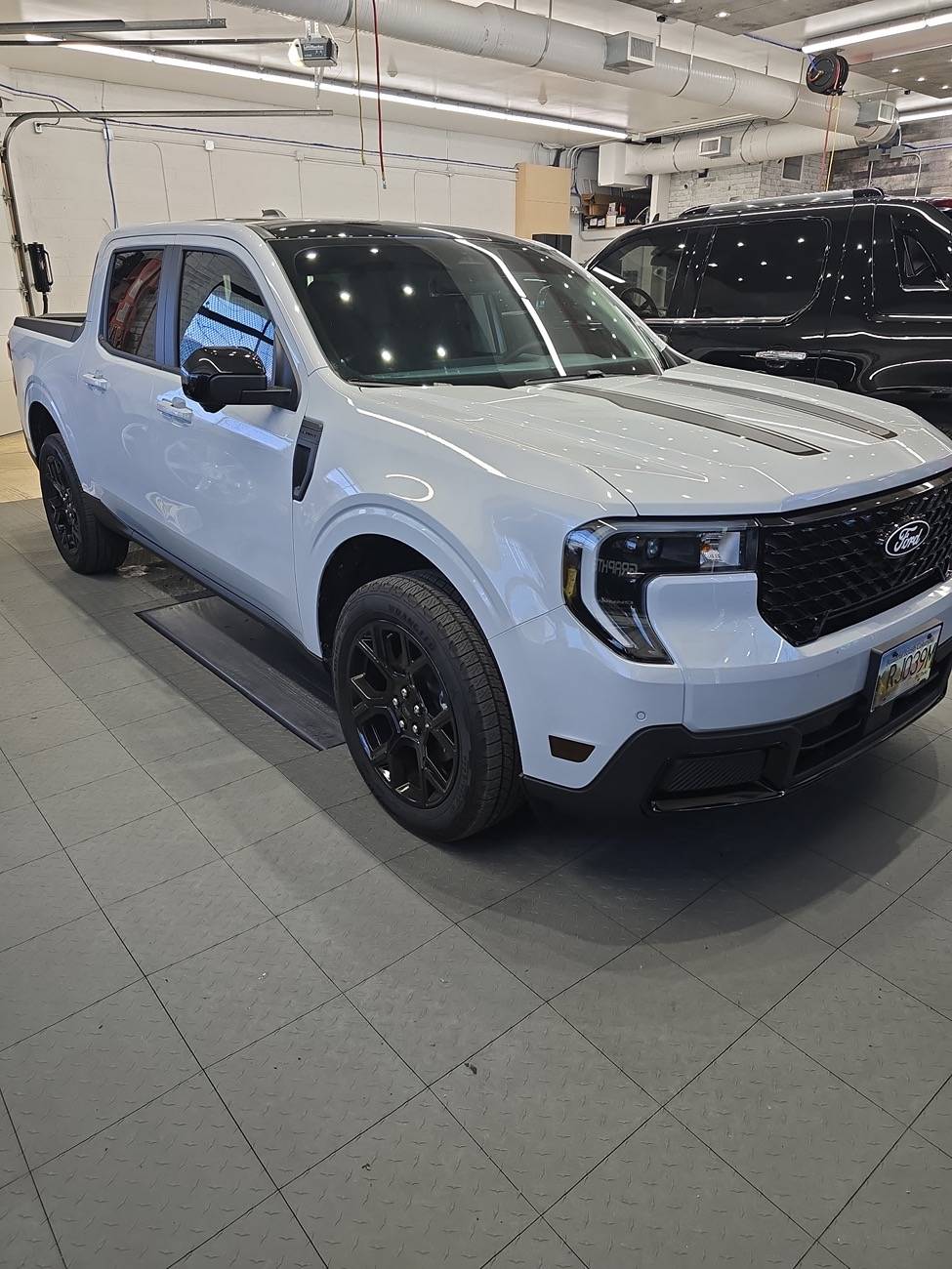

just at the shop now. Doing tint , wrapping the only bit of space white paint in box under window …corner markers done.

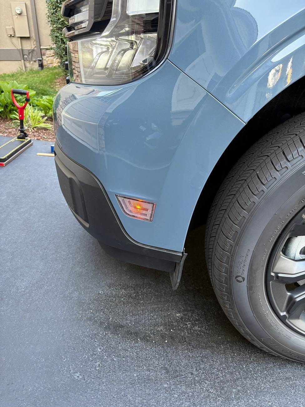

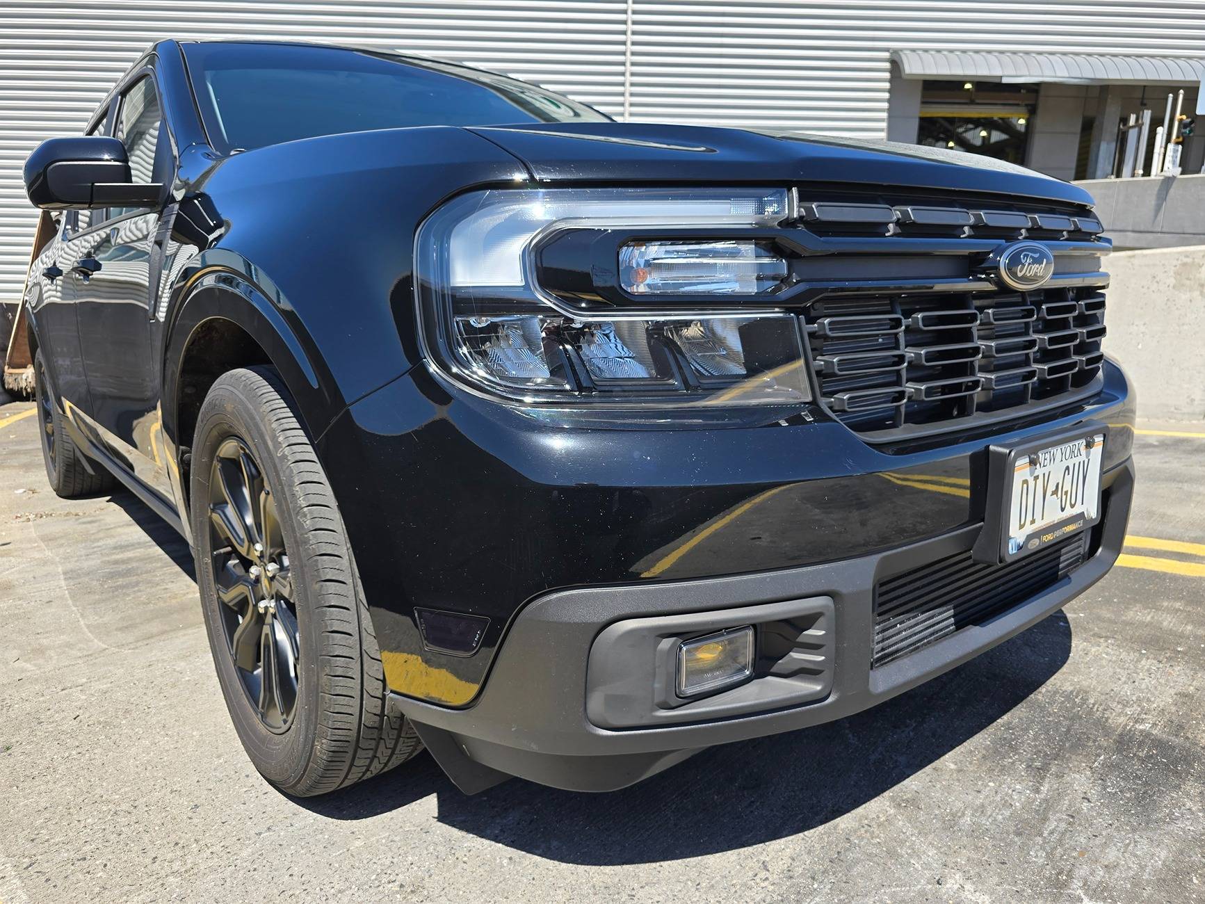

Here is an installation on an Eruption Green Lariat Hybrid. Darn reflections look like spots on the paint but they are not. Bought amber bulbs on Amazon and arrived overnight. I am pleased with the way they look with the blackout package.
