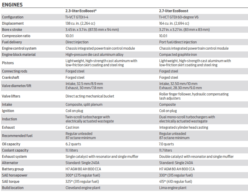

There's been a lot of previous discussions about this, but let's first start with the fact that Ford rated the 2.0L ecoboost in the Maverick with premium unleaded. It's right there on the official specs, with an asterisk. A few Ford vehicles are actually rated with 87 vs premium on their official specs, such as the Bronco, but in the Maverick we can only take educated guesses as to how it performs on 87.
Cobb Tuning explained Knock Octane Modifier and speculated as to the hp & torque the 2.0 ecoboost makes on 87 in this reply:
https://www.mavericktruckclub.com/forum/threads/premium-vs-regular-fuel-data-point.35480/post-642696
Regarding 87 being 'enough' for a Maverick ecoboost owner - or that they've never noticed issues - yes, the latter especially is very possible. But no, your Maverick does not make 250hp/277lbft on 87.
