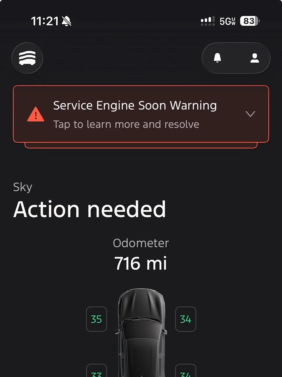

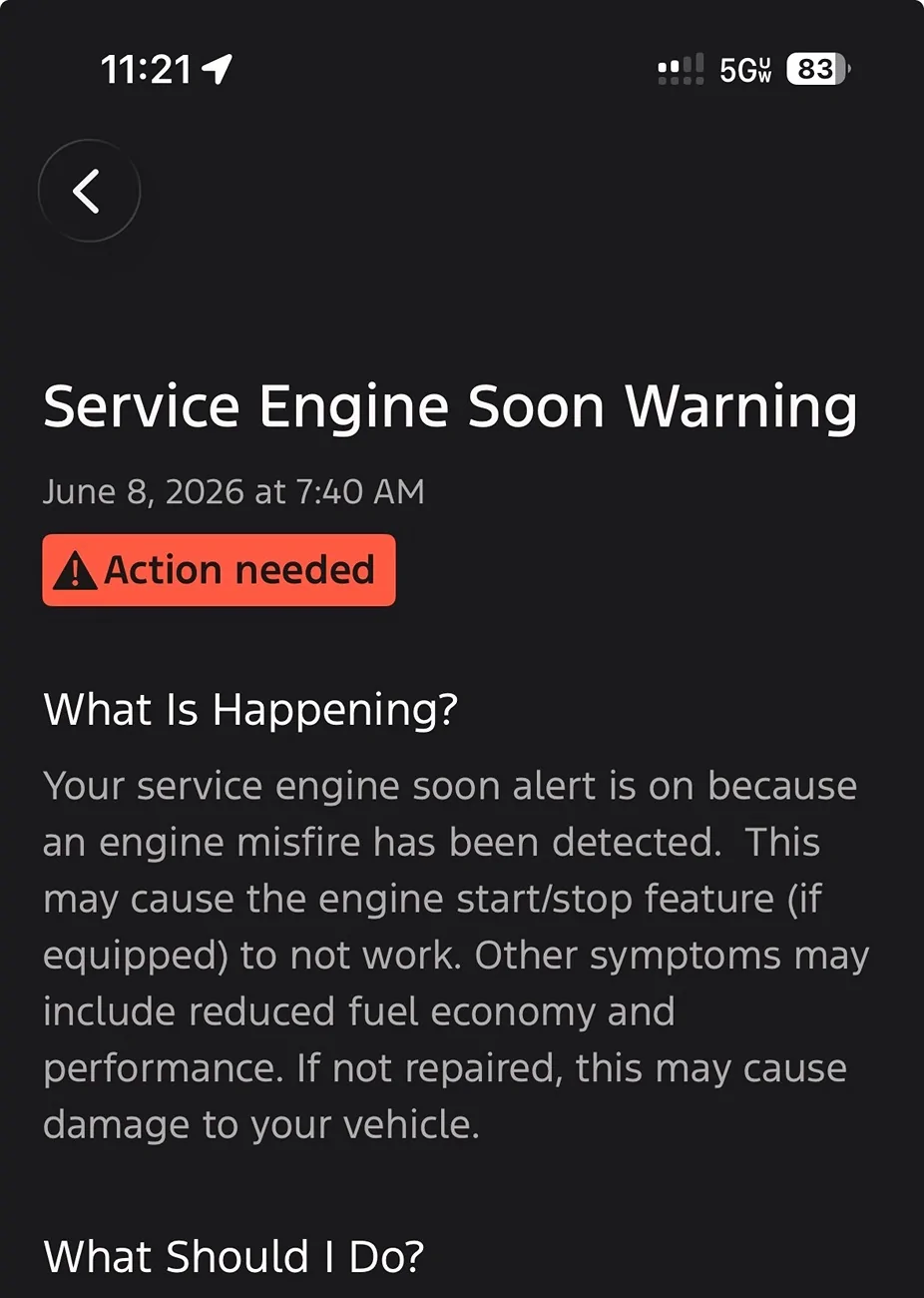

Although mine is a hybrid - had the same issue 699 miles (2026) 🙄 - 716 miles by the time I limped it back to the dealership- so bummed
U
update… coil failure. Issue is resolved a little unsettling as there are 3 more 🤣
