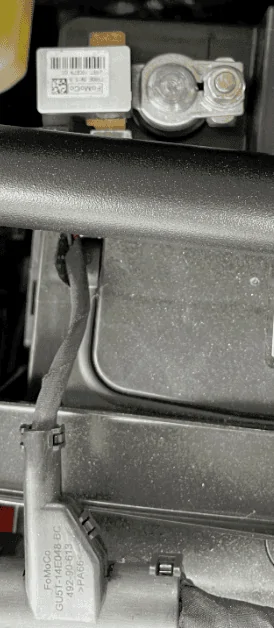

Through the BMS, it will not charge beyond whatever is set in ForeScan, probably 65-75%. If the charger bypasses the BMS, you won't see that in ForeScan, that read the values from the sensors/modules for awhile:
*-Why would the system need eight hours to calibrate the battery state of charge is beyond me. Especially, when a small battery tester can do that in less than a minute, that includes opening the hood...
You can fully charge the battery by bypassing the BMS, but give it time until the battery is calibrated. Theoretically, the truck's charging system could overcharge the battery in that case, without calibration, but it's doubtful.
