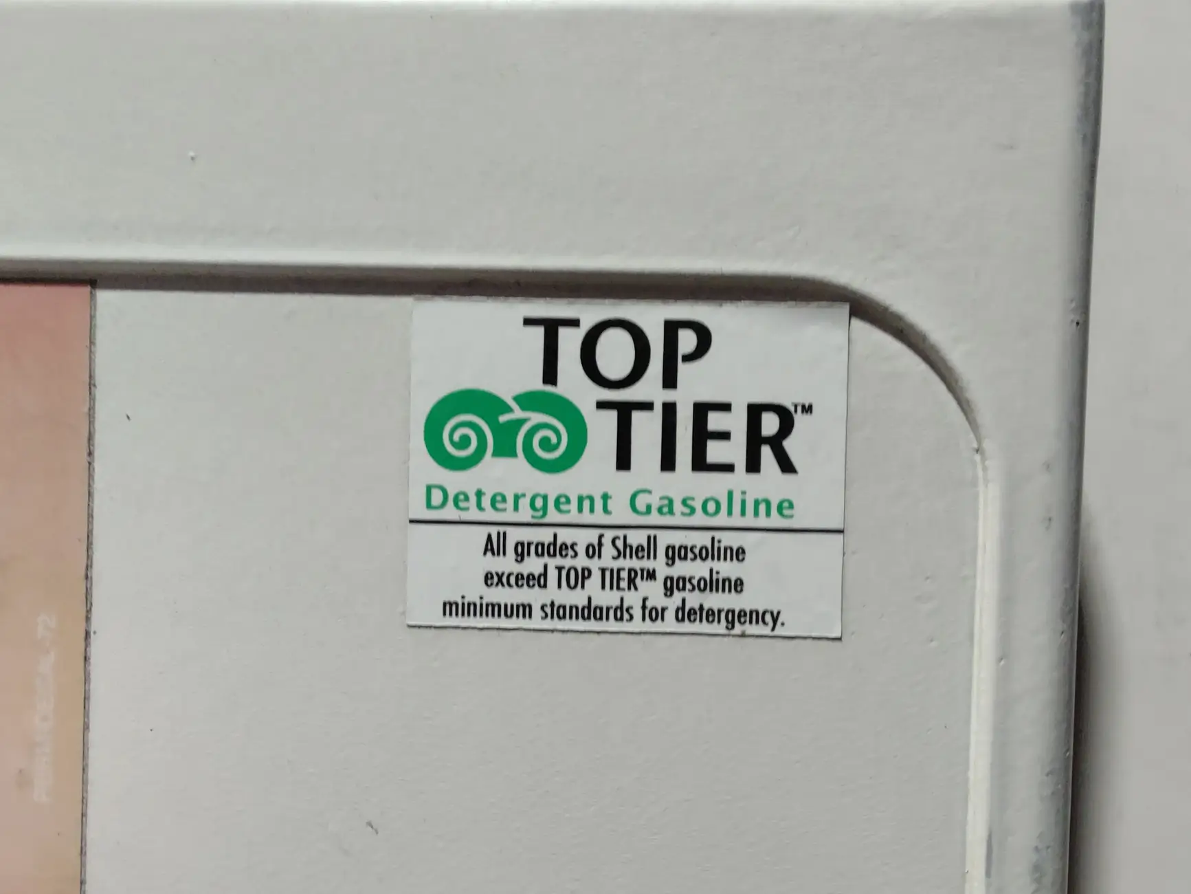

While I feel Top Tier fuel (or lack if it) has nothing to do with your EB issues, I will mention that labeling at the pumps is typically present with Top Tier grade. Photo below. I’ve seen various forms of the sticker, and sometimes in a different color scheme, but it’s normally right at each pump. I’ve seen it near the LCD screen, card swiper, and 87/89/91 buttons. With all the other labeling that goes on, it’s not always easy to spot.
Ford Maverick MIL on/P0302 Misfire - 2025 Maverick 2.0 EB IMG_8257
