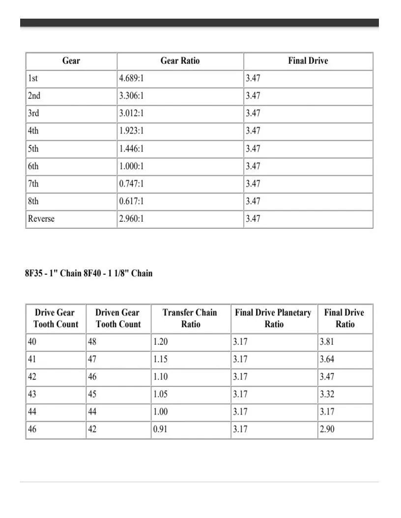

As another aside for those who want 4k towing with the Tremor package. That may also be possible. Most of the parts will have to come from the aftermarket but if you can get this with a trailer brake control module it will make things much easier. This also assumes the Tremor will come with a hitch and the 4pin connector installed at a minimum. The aftermarket parts needed will be a class III hitch which Curt I believe already has out there now for Mavericks, Transmission cooler including lines and fans, auto thermostat for the fans if not already there to kick them on at around 180F and air bag suspension kit to stiffen up the travel on the rear. You shouldn't need to do any forscan programming unless there is anything specific to the tow capacity in the settings assuming you already had a factory hitch and wiring for the trailer lights. Unless the 3.63 final drive ratio can't handle the extra towing weight the truck should be able to handle 4k in tow weight.
If 3.63 final gear ratio can't for some reason you can change that also. That is the major labor part of the process since it is actually determined by the transmission not the rear. To get to a 3.81 final drive ratio like the 4k package you need to change the drive and driven sprockets on the 8F35 transmission. It is a lot of labor and time to drop the tranny but if you do, to get to them is easy enough afterwards. Once you take the torque convertor off, the housing it is sitting in can be removed and you have access to the drive and driven sprockets and chain just a matter of switching those gears out with the ones needed for the a 3.81 drive ratio. It is well documented in the shop manuals how to replace all this and the specific gears needed.
