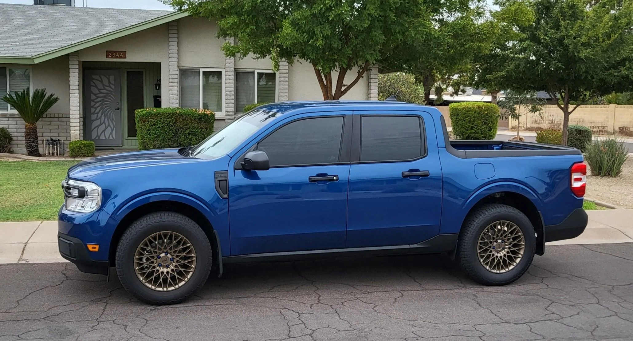

Can you share more details about adding hill descent to the XL?For what it's worth I added the extra drive modes and hill descent control to my XL
Got an IPC and console switch out of a salvage yard FX4 Maverick. Added them along with a 12g wire to the console harness and then loaded the IPC module bas built data from the salvage FX4 and voila. Cost me about $150 and sure the FX4 package is only 700 or something but it also requires XLT trim which I had no interest in upgrading to considering that meant another few thousand just to get FX4. XL has better looking interior and I'm cheap.Can you share more details about adding hill descent to the XL?
