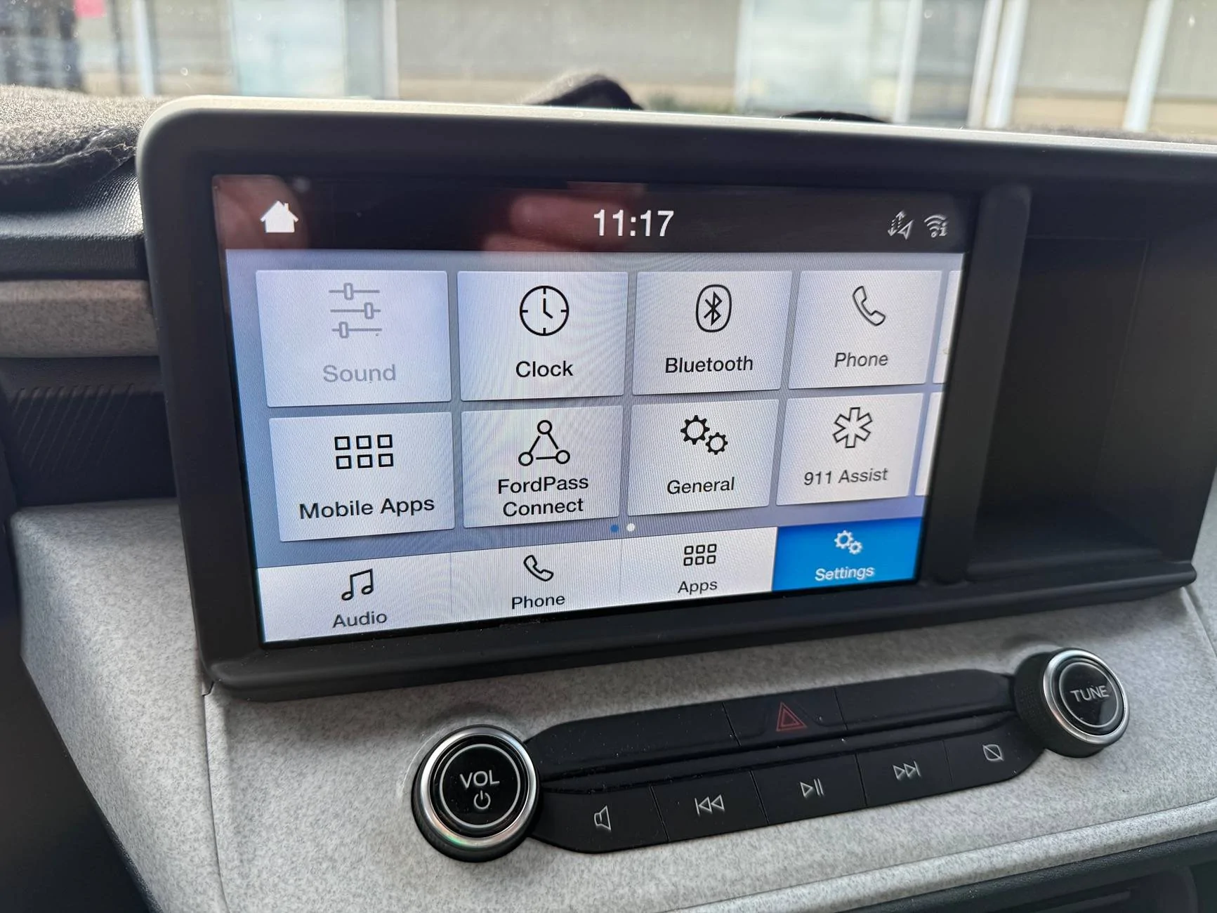

The easiest way for a 100% charge is driving the vehicle for 30 minutes on a highway at highway speeds as far as the update goes I had it done yesterday and no crashes and a for some reason a brighter screen
