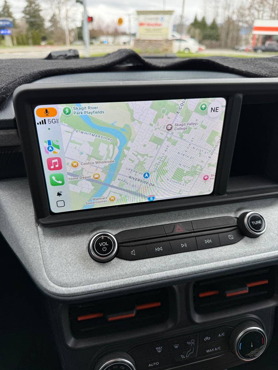

I had my Maverick done on the camera audio display recall. One of the things I noticed immediately was the screen was brighter and that the backup camera was much smoother with no jittery images and absolutely no freezing at all.
I am not sure why the screen was brighter as it did not wash out as bad in direct sun light. I had the settings of the screen on the bright before so something was off in the original programming. Still is a dinky screen but much improved
Want to take a picture of the screen ?

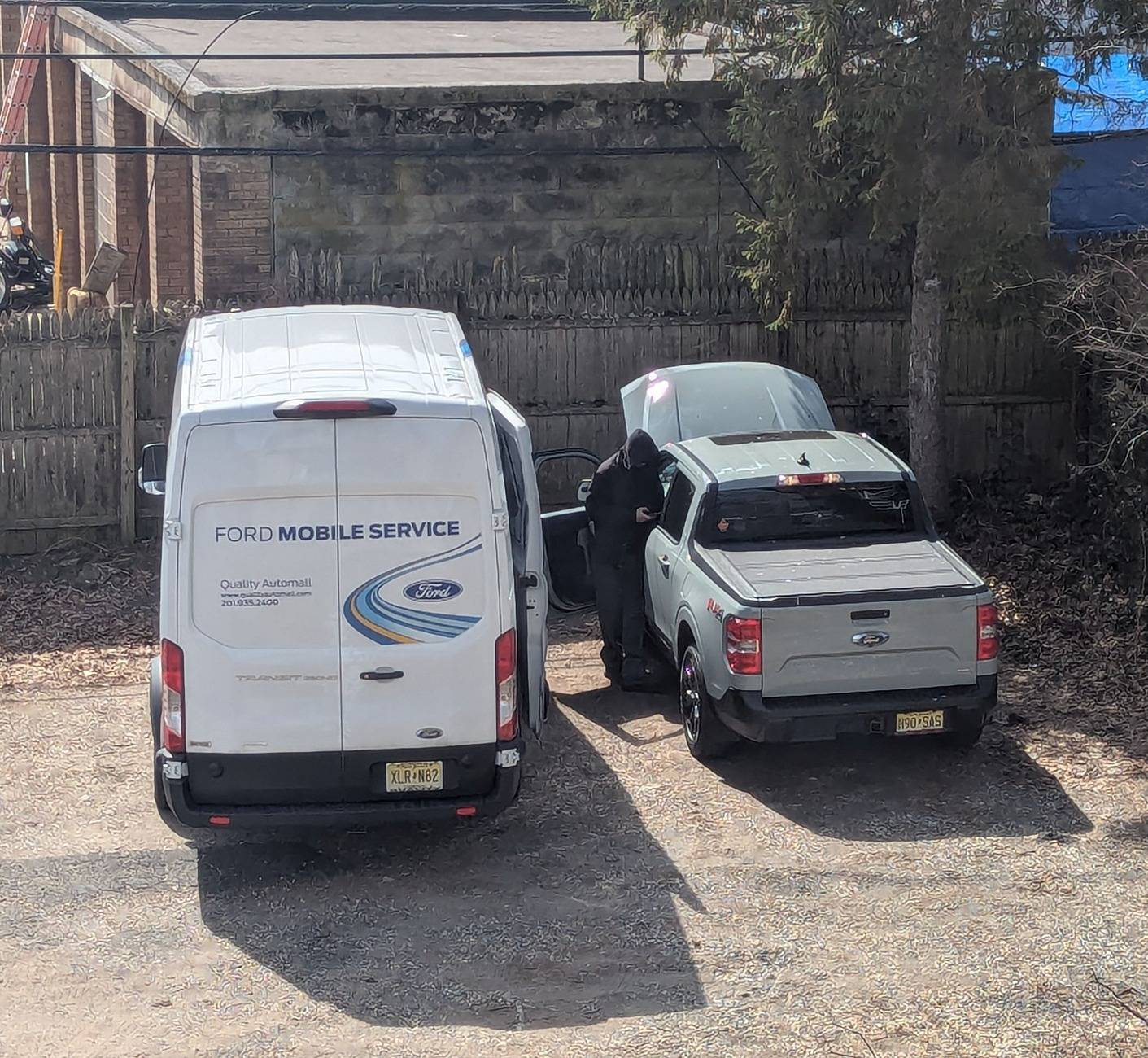

Getting mine done as we speak. Tech said hour and a quarter and he's been here an hour so far.
Any idea what they are doing under the hood? I was thinking they would just plug in a thumb drive from the cab and upload their virus, er patch :wink:

If these trucks go into battery saver mode in the middle of an update, it can bork it. So, most dealers connect a backup power source to the truck during update, so that won't happen. The ones that don't do this are the ones you should look out for.
Similar to setting up a new phone. Do it while connected to a charger.

The negative had to come off the terminal as well.
