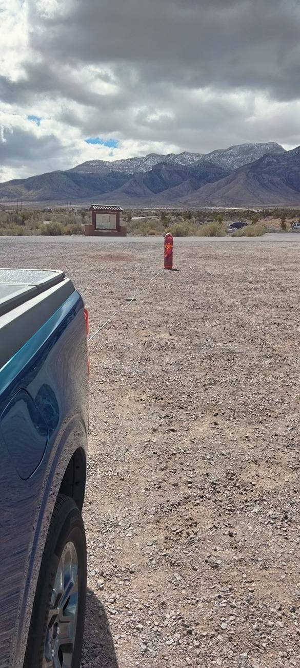

My XLT with Co-pilot 360 will pick up a vehicle coming from the side but does not have proximity sensors to keep from backing into stuff. Not sure how fast/big an approaching person would have to be to trigger the alarm. Be interesting to see what Glen can show us.
One of these days, I want to check out the forward alert and emergency braking using...👇👇👇👇👇

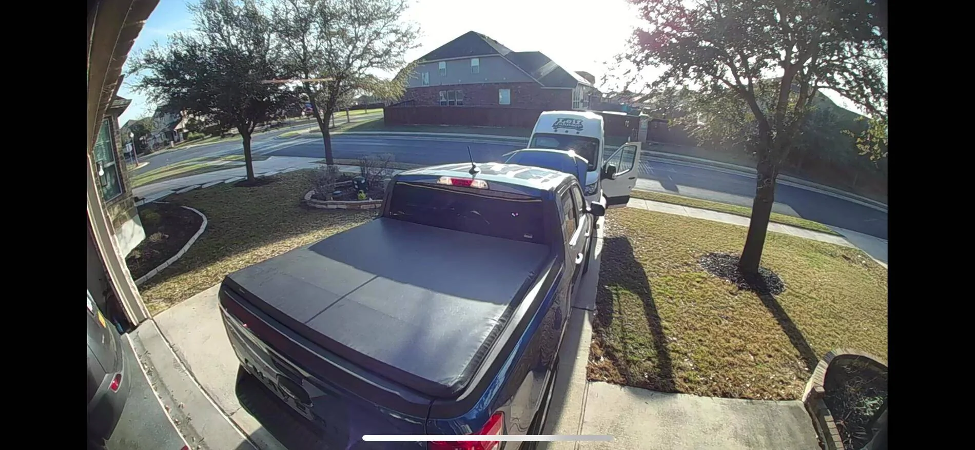

Getting it done. Tech connected the battery to his truck and also gave me a heads up that it will take 1-2hrs. Got his laptop and asked for wifi connection. Took an hour and right before he left , noticed my engine light is on. Good thing he’s still on my driveway. Here waiting to see what the engine light was about ….
after another 5 min- tech said it’s part of the software update where he has to clear the codes which he did But for some reason, it came back :rolleyes:
he said it should be good now. If its returns, driving a few miles will clear. If not, call them back to schedule another mobile appt 🤞
