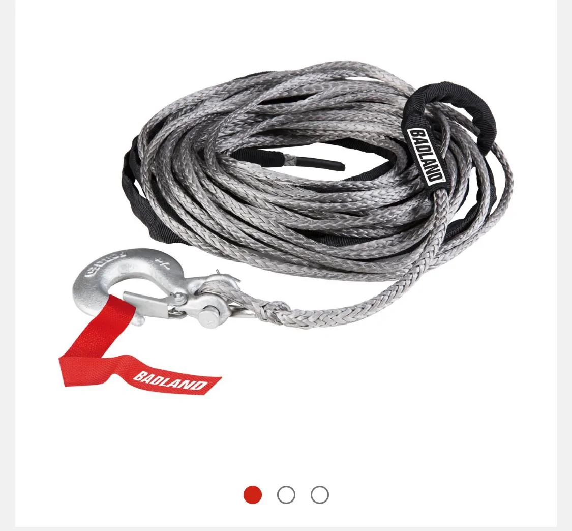

For the record, I think metal shackles if over-rated are perfectly safe on the vehicle. Just not on strap to strap. My gut trusts metal more than this spider web filament space age material but I've winched pretty heavy loads with very thin synthetic winch line and been impressed.
