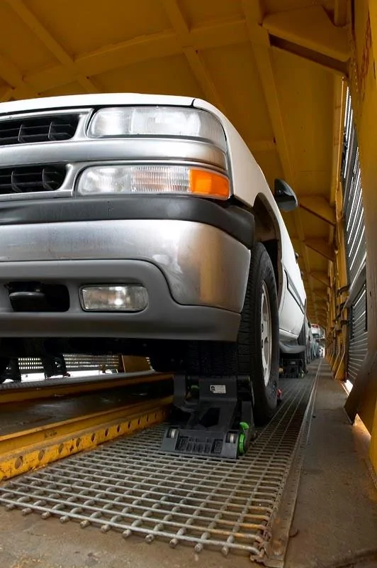

They strap them by the wheels, that's why we used to get tons of posts asking why there were marks on the OEM tires. This seems to be a standard transportation practice for all vehicles. My friend works at one of the big ports in Vancouver and used to unload car ships coming from Asia, they did the same thing.
Those "marks" on the tires have nothing to do with strapping down anything. Vehicles are secured with wheel chocks in the auto trains, not straps.
Ford Maverick Maverick Hybrid recovery points, what to do when stuck? img_tr_auto_rack_chocks

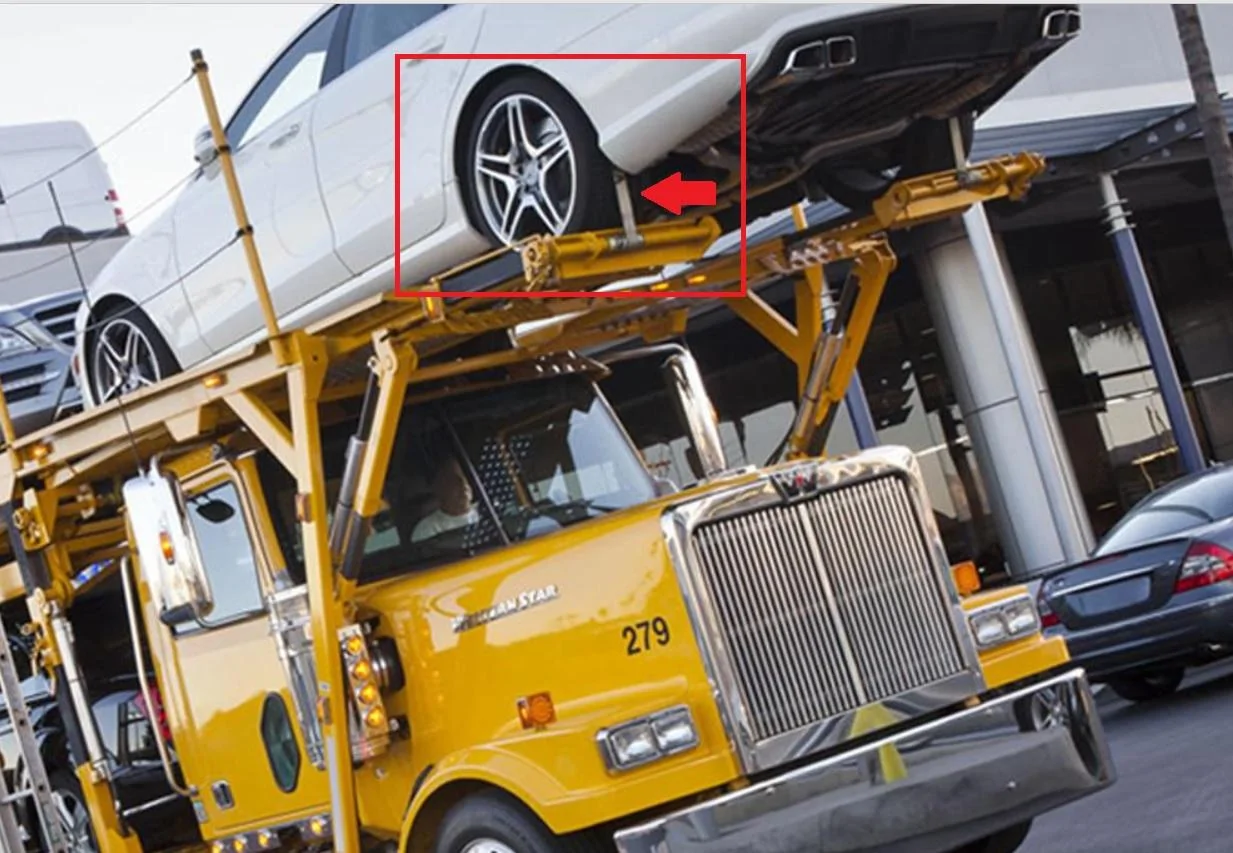

I suppose. Must be from the trucks that go the final distance, I've seen them getting unstrapped from the transports at dealers.
Even on the truck carriers the straps go around the tread only. Those marks on the sidewalls are from the manufacturing process.
Ford Maverick Maverick Hybrid recovery points, what to do when stuck? Carrier
