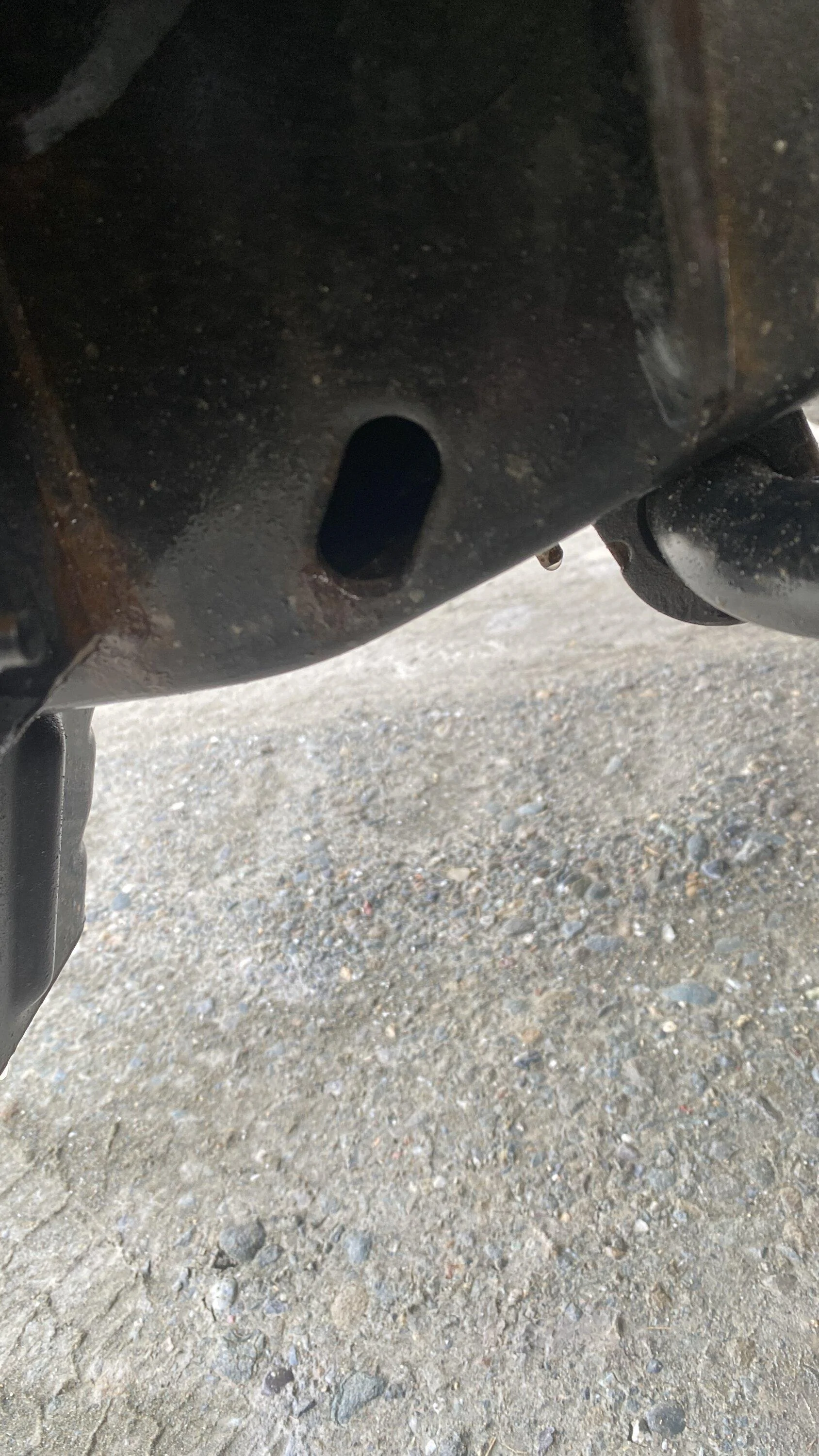

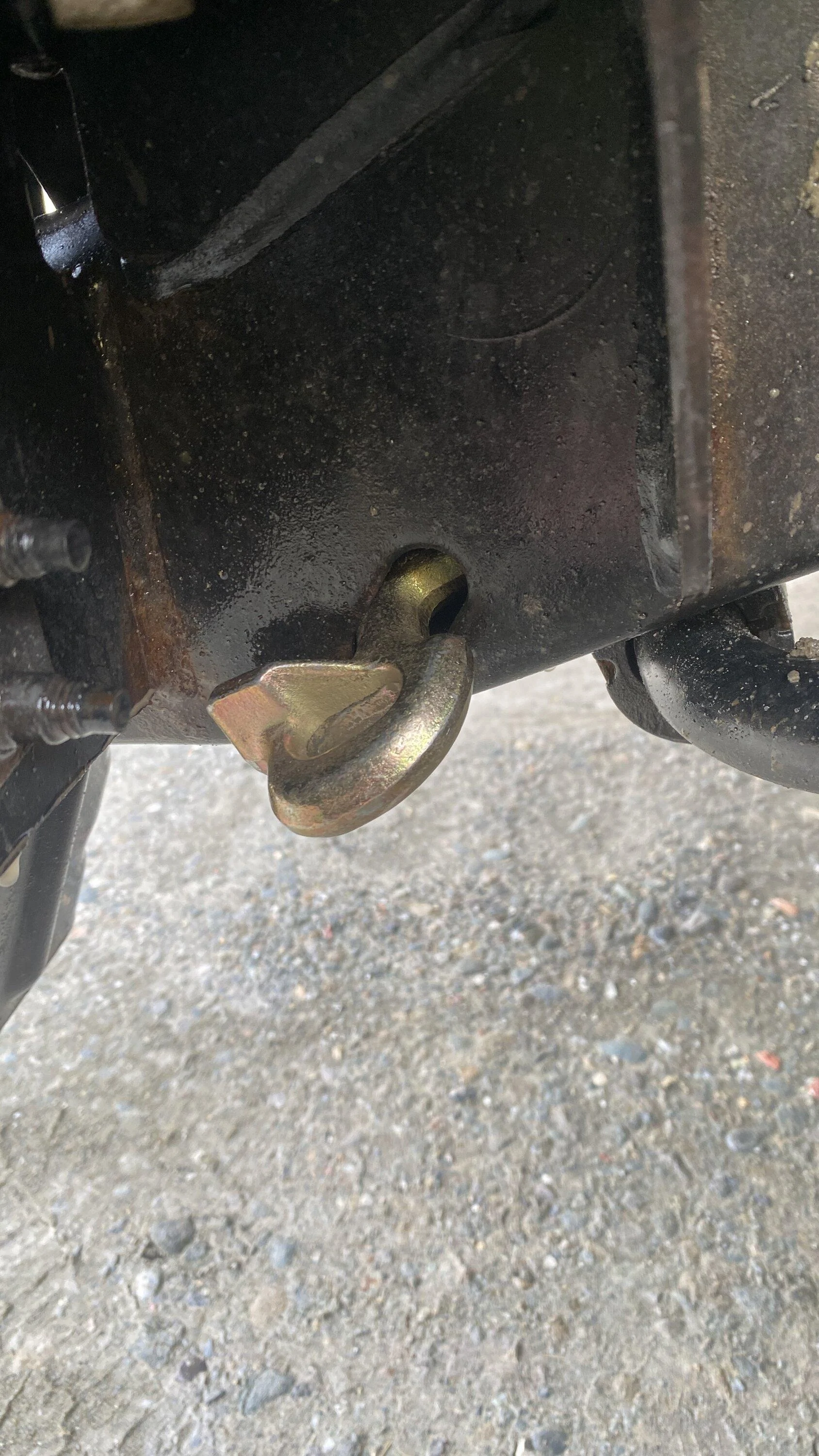

Today at work I looked at a company F-250.
Guess what it has? Oval holes/slots.
The R hook fit perfectly.
Ford Maverick Maverick Hybrid recovery points, what to do when stuck? IMG_9069
Ford Maverick Maverick Hybrid recovery points, what to do when stuck? IMG_9070
But the F-250 has honest recovery hooks built-in at the front. And you can see this hole is on the side.
This hole with this R hook could/would be used to tie this truck down to a flatbed (or train car) etc.
